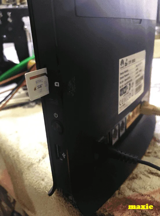

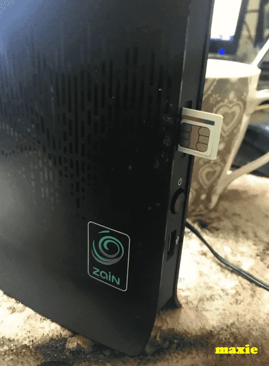

  1. Insert unsupported SIM card in router

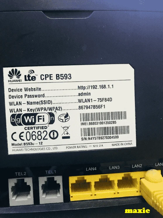

  2. Connect B593 router to pc via LAN cable\
  3. Turn On Modem

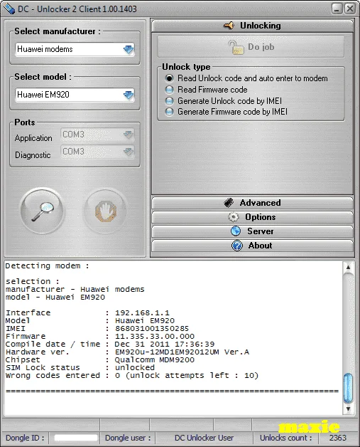

Picture :
After Unlocked
Logs

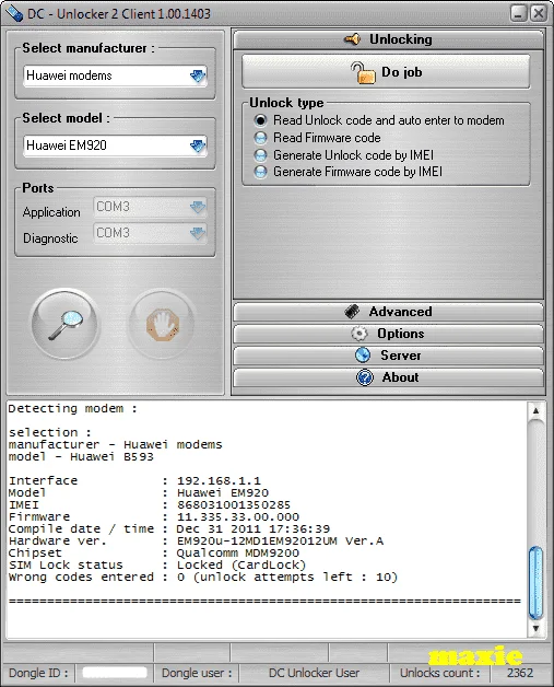

DC - Unlocker 2 Client 1.00.1403
Detecting modem :
selection :
manufacturer - Huawei modems
model - Huawei B593
Interface           : 192.168.1.1
Model               : Huawei EM920
IMEI                : 868031001350285
Firmware            : 11.335.33.00.000
Compile date / time : Dec 31 2011 17:36:39
Hardware ver.       : EM920u-12MD1EM92012UM Ver.A
Chipset             : Qualcomm MDM9200
SIM Lock status     : [B][COLOR="Yellow"]Locked (CardLock)[/COLOR][/B]
Wrong codes entered : 0 (unlock attempts left : 10)

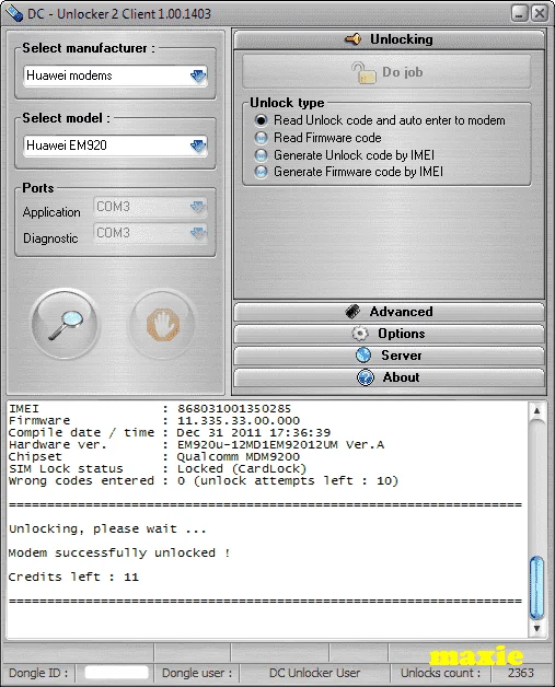

Unlocking, please wait ...
Modem successfully unlocked !
Credits left : 11

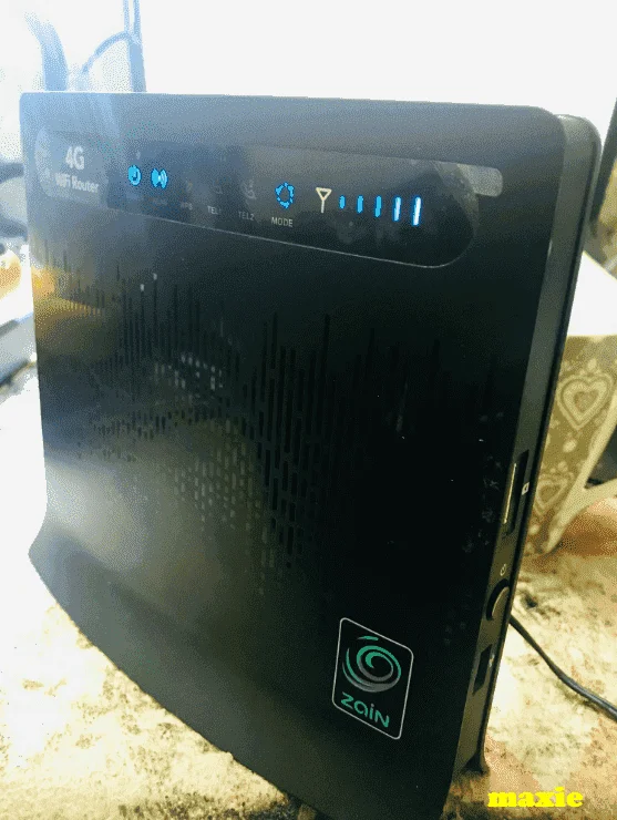

Logs after Unlocked
Code:
Detecting modem :
selection :
model - Huawei EM920
SIM Lock status     : [B][COLOR="Red"]unlocked[/COLOR][/B]
Finish
