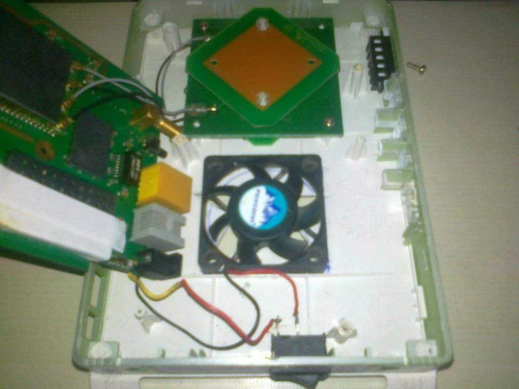

well i just want to share my modified BM622i 2011 sa mga gustong gawin din sa mga 22i 2011 nyo iwas sira yong RF IC ;D
Tools needed
  1. Philip screw
  2. soldering iron
  3. LED
  4. bulldog or mighty band
  5. cutter blade
  6. pan galing sa sirang lan card
ibang picture is for BM622m pero magka pariho lang yan sila

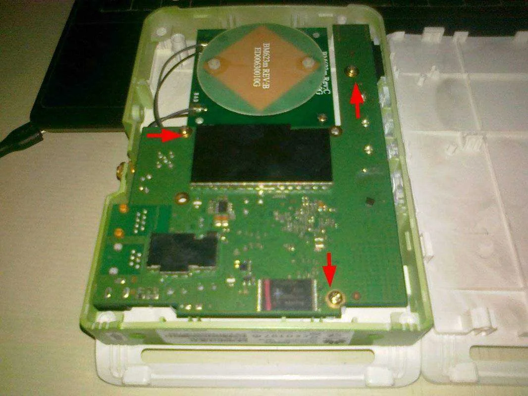

step 1
open your bm622i 2011 by unscrew the 3 screw
step 2
disassemble board from housing refer to picture below ()

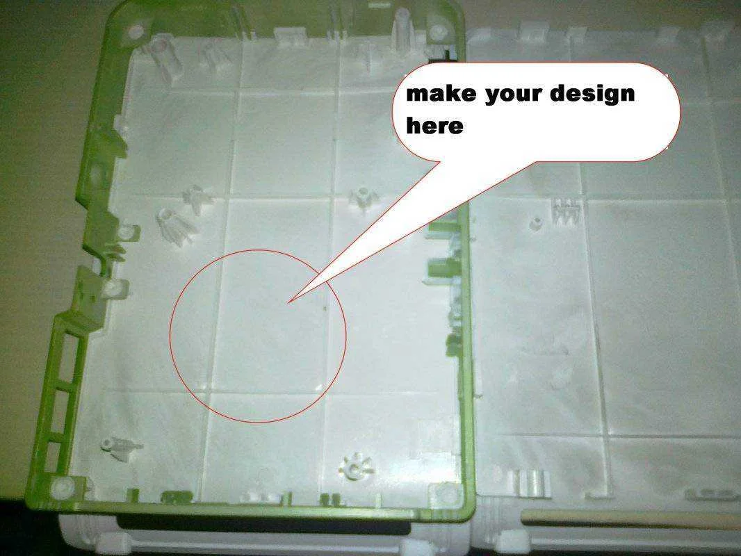

step 3
make your own design here para butasan at may labasan ang hangin
step 4 assemble

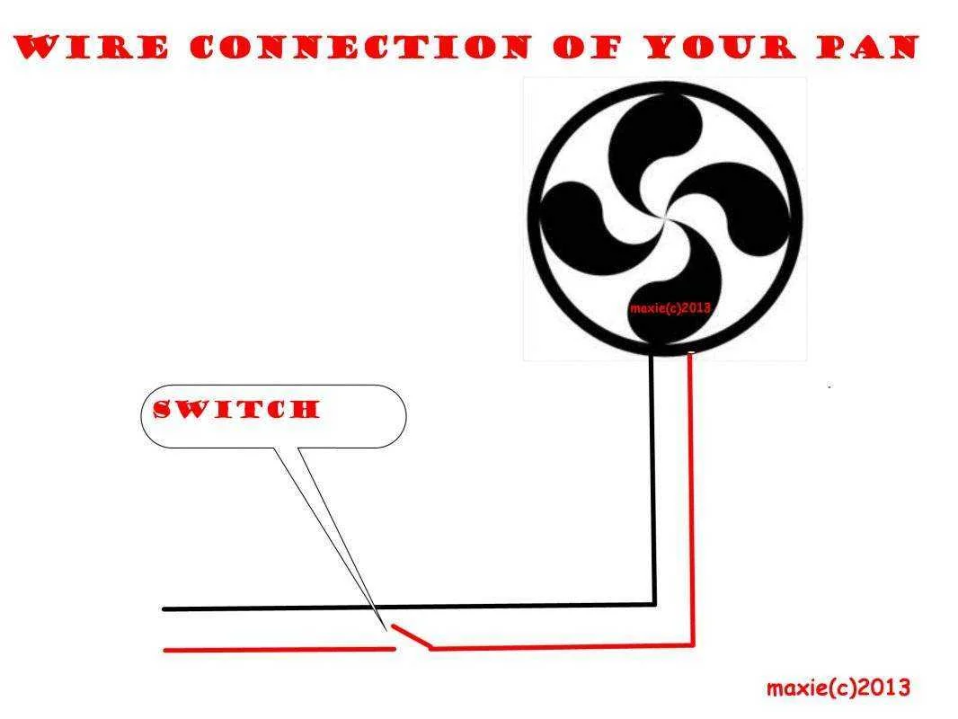

step 5
solder yong pan at ang switch

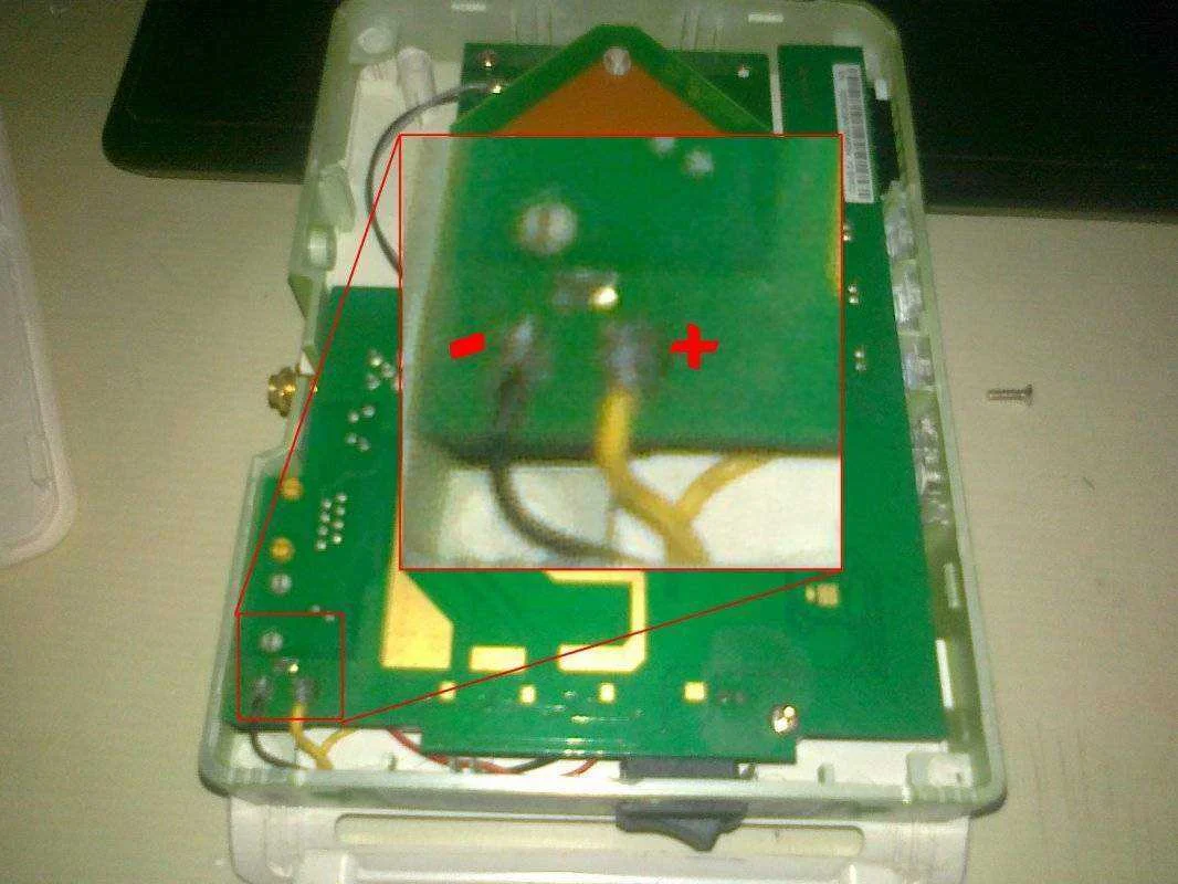

step 6
solder yong wire ng pan doon sa power adaptor ng wimax see the picture below

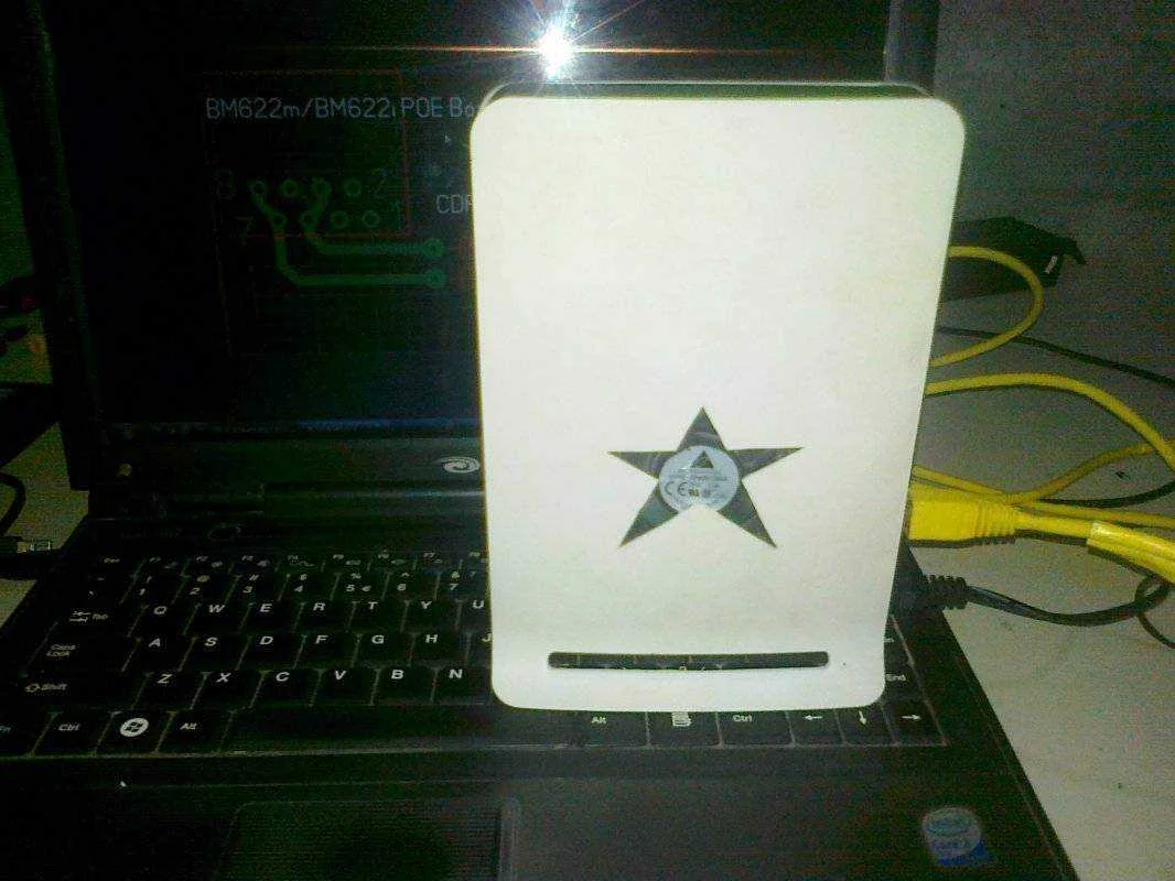

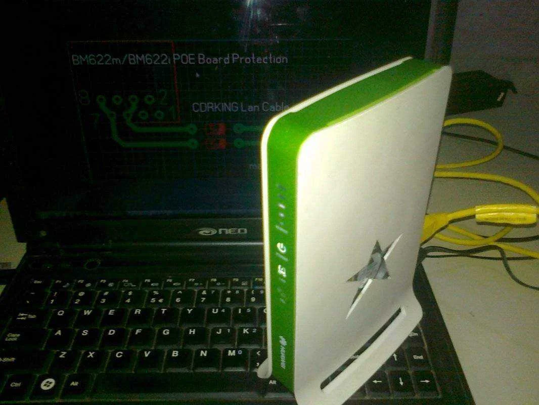

finish product
