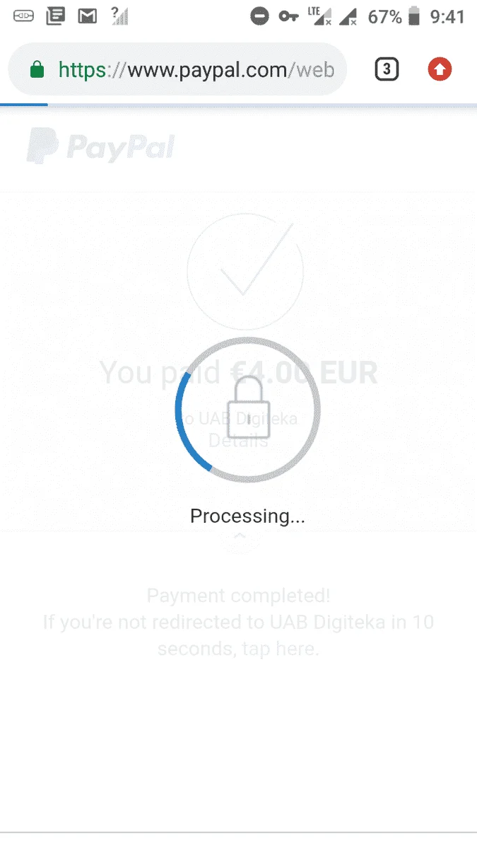

1. Go to this You do not have permission to view the full content of this post. Log in or register now. to buy a credits we gonna use to unlock the bootloader.
2. Then select your payment method, i prefer paypal.
3. Now enter your username and email address.
4. Then type "4" to the credit to buy a credit to your username.
5. You will direct to the paypal gateway to buy the credits that you input.

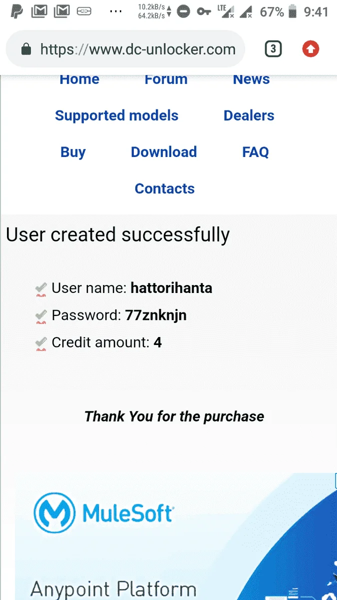

6. After purchasing.
You will receive a username and password for your account like this.
(NOTE: Don't attempt to use this account, hindi nagagana ito. :P)

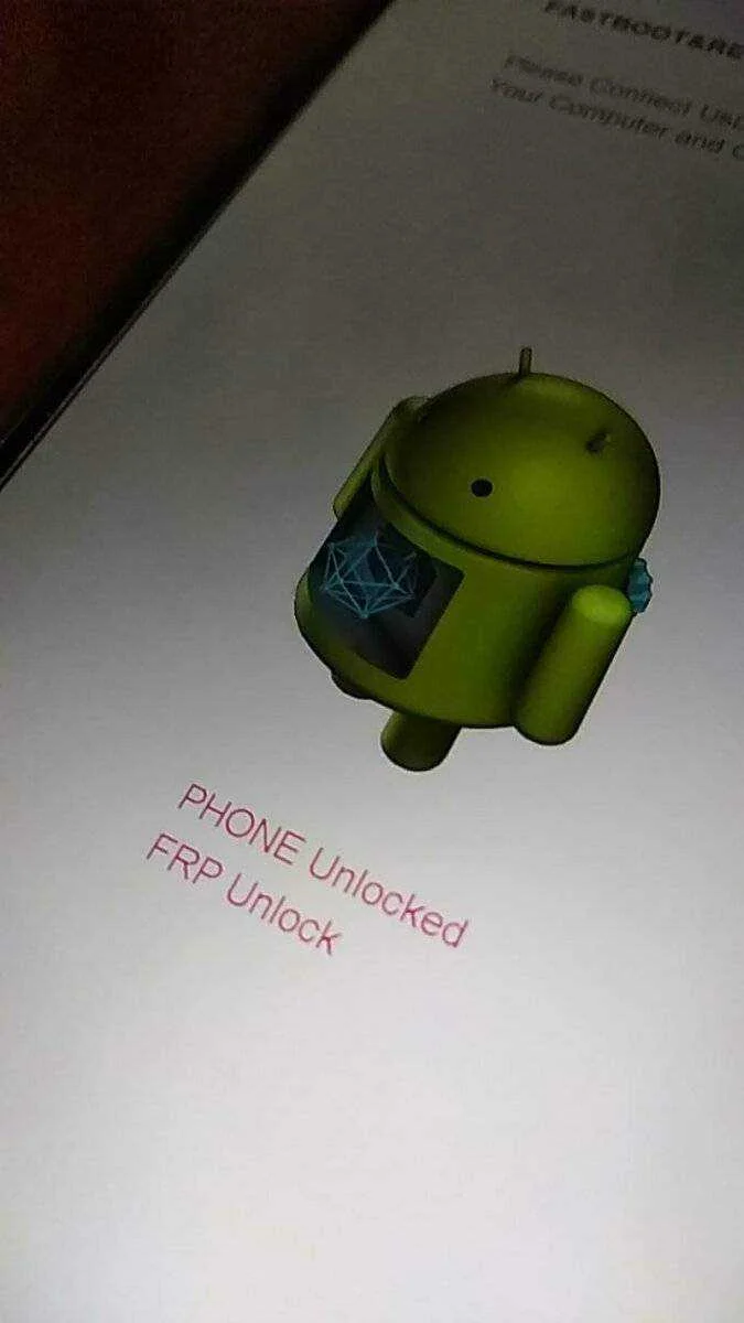

13. After reading the code, you will see bootloader code to unlock your bootloader.
IMG_20181225_150802.jpg14.After obtain your bootloader code, hold shift key then right click on the folder of HCU Client then click open command window here.

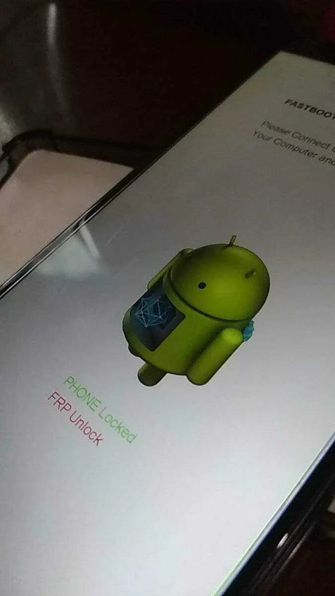

16. You will see a warning appear on your screen.
Press UP and click Power to Confirm.
17. Congratulations, your Huawei Bootloader is now Unlocked.
Now everytime you will see this error or warning dialog when you turn on your device.
