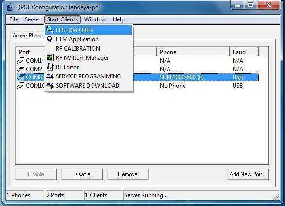

2. Open QPST
3. Go to “device manager” and find the port of your SmartBRO MODEM (click ‘start’, right click ‘computer’, select ‘properties’ and click ‘device manager’)
4. Go to ‘QPST’, click ‘add new port’, select port of your SmartBRO MODEM (e.g ZTE diagnostics Interface (COM8). )
5. Select SmartBRO MODEM port and click ‘EFS Explorer’ then click “OK”
6. Delete “config” file and replace the new config from attachement

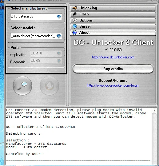

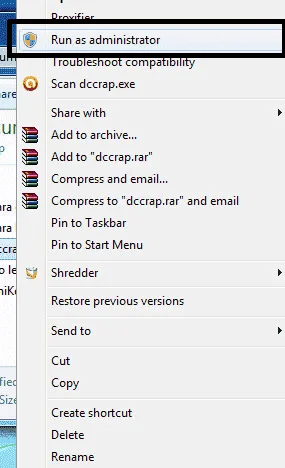

10. After renaming open dccrap (note: run as administrator on win7 or vista)

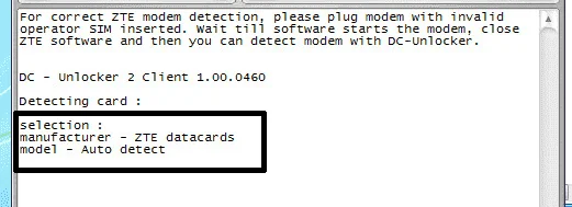

11. On manufacturer select “ZTE Datacards”
12. On model selection select “auto detect”
13. Then click a “magnifying glass”
14. Oh ito! kung ganyan yung nangyari pwede nyo na i-cancel (click hand with red backround) pero detected na po iyan :)

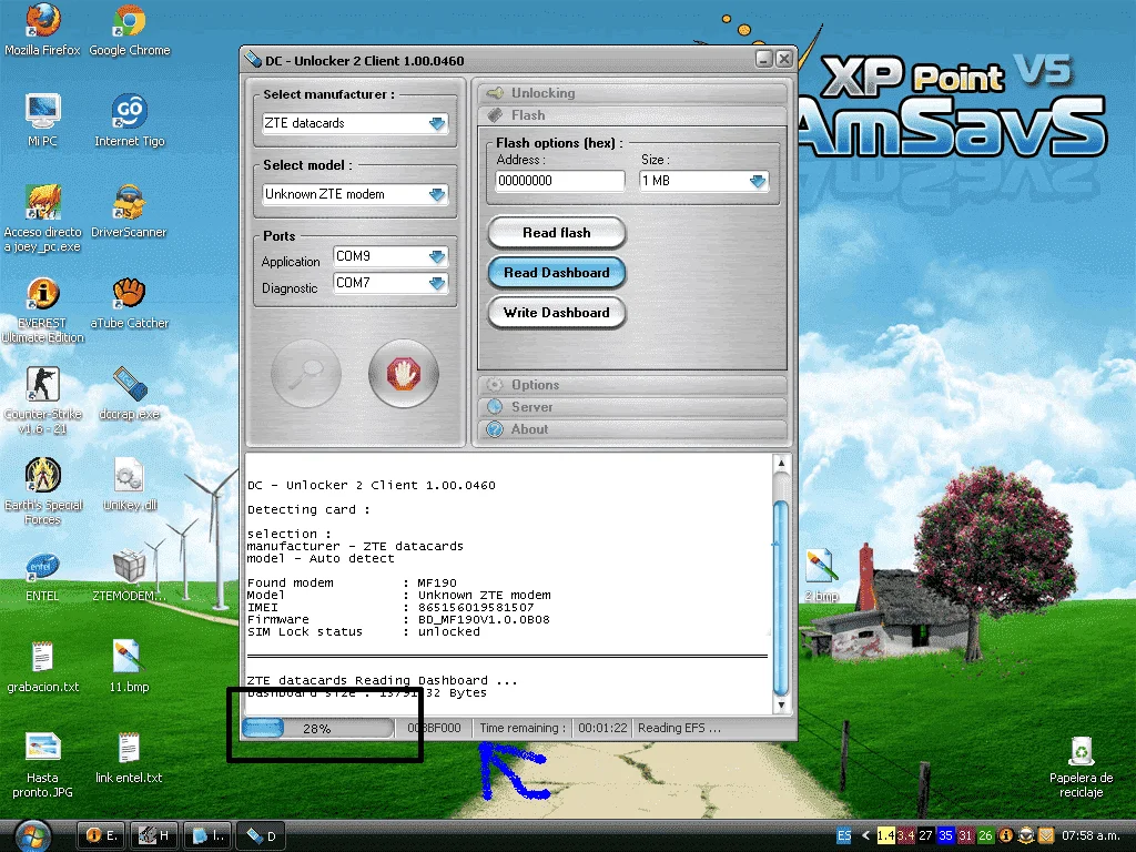

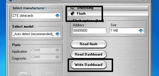

15. Click Flash then click Write Dashboard then select your downloaded beetle connection manager (note: dapat ZTEMODEM ang name nya :) )
16. Wait Until 100% writing

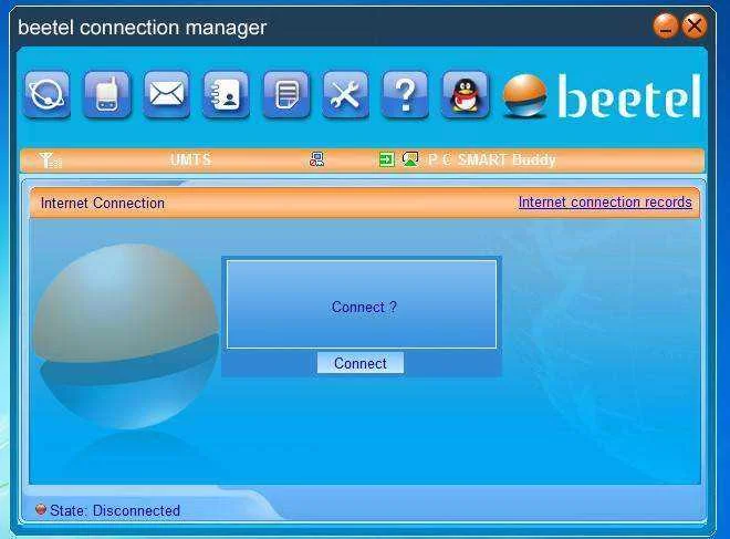

18. After restarting plug in your Smart BRO don't worry auto install beetle connection manager and wait install drivers DONE!
here my screenshot :)
connection manager (check)
call feature (check)
message feature (check) (syempre)
phone book feature (check) (yummy)
signal (check)
naging 2G or edge ba ang signal? syempre hindi mas mabilis pa ito kaysa sa dating dashboard :)
ang maganda pa dito sa dashboard na ito hindi nyo na kailangan mag set ng APN automatic na yan :)
