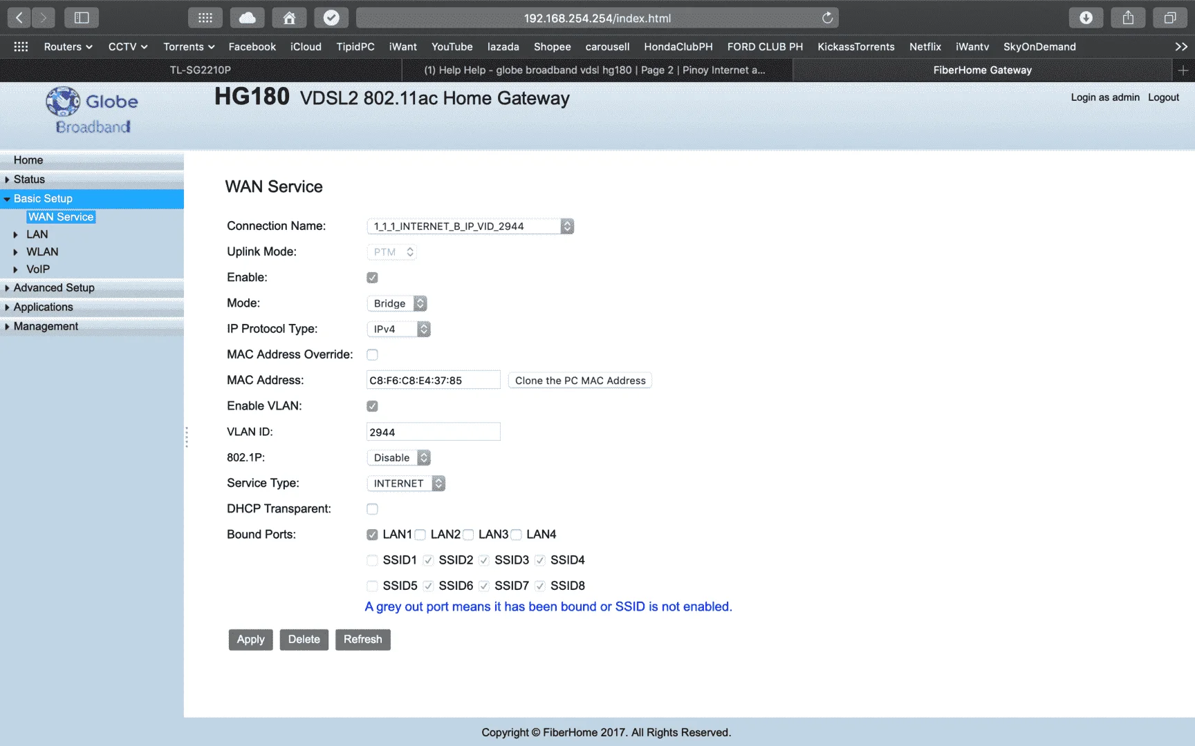

We will be using our own gateway/router and just want the HG180 to act as the modem.
In my experience ISP-supplied wifi router/modems slow down or crash when pushed..
Our Ubiquiti USG will also whitelist certain sites to prevent ****.
hi, did your bridge mode work?
Curious also.
I see they use PPoE and 2 VLAN ID, one for VOIP (if part of the promo) and one for Data. I can replicate these settings with another modem, a TP-LINK VR400 and connect to Globe. But the VR400 I have cannot bridge mode. If the HG180 they supplied can bridge mode I want to know about it. Plan B is buy a new modem that I know for sure can bridge.
Ok na pala boss. Sa mga magtatanong paano, wag niyo check yung enable vid. Nag coconflict sa pppoe. Nakalogin na ako. Salamat.
