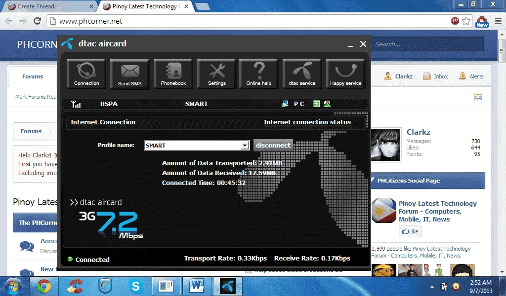

4. Double Click "ZTE MF190 FIRMWARE" wait for it to detect the device then proceed. After ma update, the device will reset automatically and will install the dashboard na "dtac aircard" and will ask for the drivers again. Still follow the same process. Now, dashboards will pop-up, dtac aircard. Let the dashboards pop-up then simply close/exit

8. Replug zte mf190 then okey na po yan..balik sa dating signal yang zte mf190 mo...msa malakas pa signal kaysa sa original na firmware...
