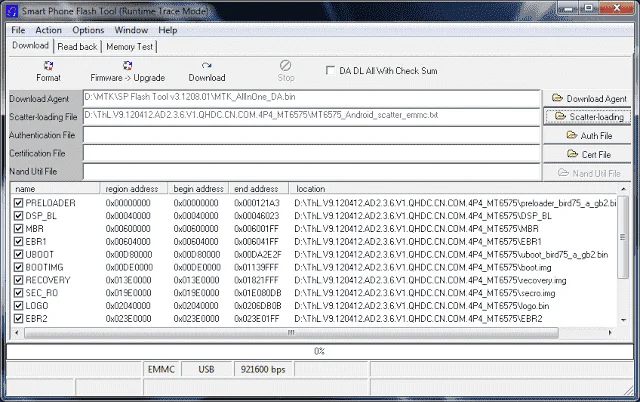

MAKE SURE NA YUNG STOCK ROM NYO AY EXTRACTED THROUGH MTKDROID ROOT TOOLS PARA SA MGA MTK DEVICES AT GANITO UNG EXACT NAME NG STOCK ROM FOLDER NYO ONCE NA BACKUP NYO USING MTKDROID ROOT TOOL (!FILES_TO_FLASHTOOL..)
AND DAPAT MAY MTK USB DRIVER NA KAYO NAKAINSTALL SA PC NYO.
STEP 1. CONNECT NYO YUNG USB CABLE NG PHONE NYO SA PC.. BE SURE NA USB CABLE LNG..AT DI NAKASAKSAK UNG FONE NYO DUN OKEY

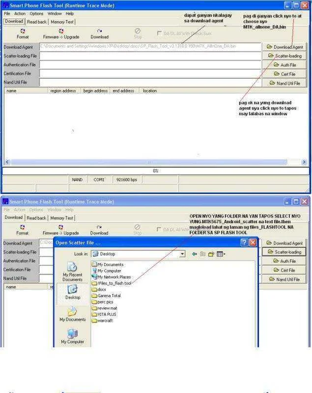

STEP 2. FOLLOW SCREENSHOT
STEP 3. THEN MAGLOLOAD UNG LAMAN NG !FILES_TO_FLASHTOOL NA FOLDER..DAPAT MAY CHECK LAHAT SA GILID YUNG LAHAT NG MGA FILES

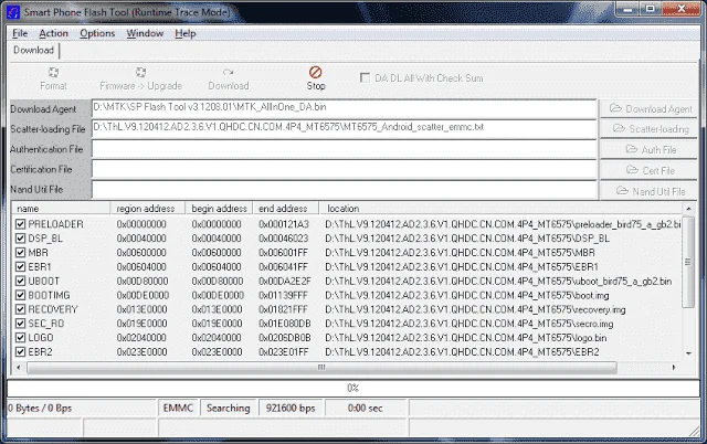

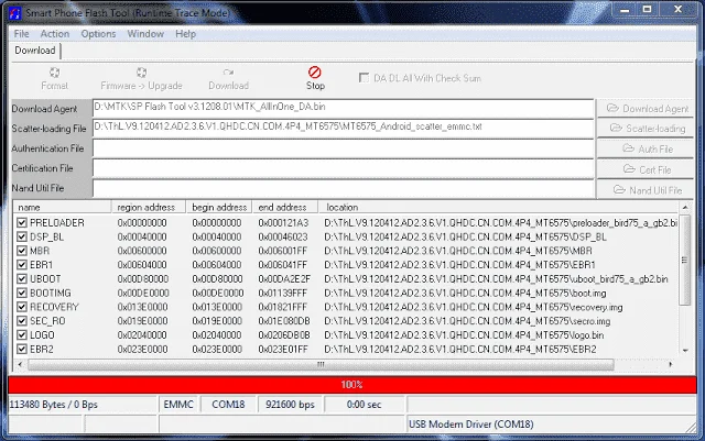

STEP 4. PAG NALOAD NA LAHAT CLICK NYO YUNG DOWNLOAD SA SP FLASH TOOL. MAKE SURE NA NAKA TURN OFF YUNG PHONE NYO BAGO NYO ICONNECT SA PC.THEN MAY RED LOADING BAR NALALABAS

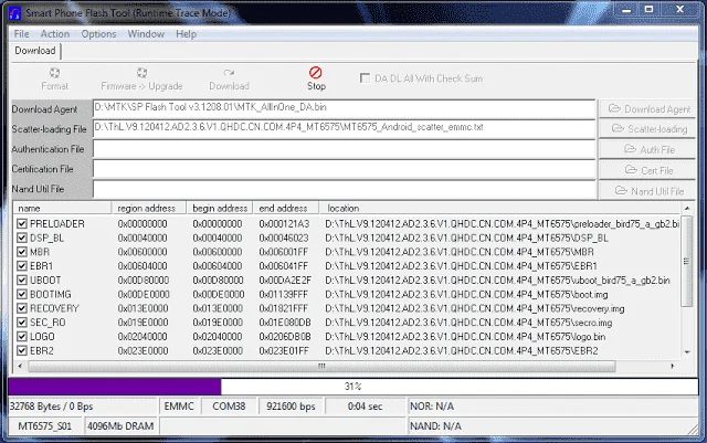

THEN FOLLOWED BY VIOLET LOADING

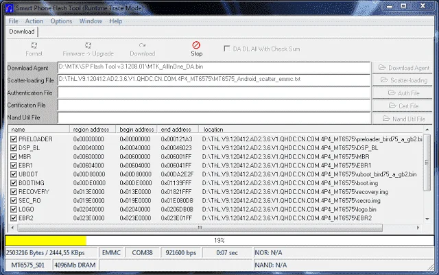

THEN YELLOW

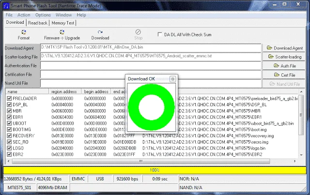

THEN PAG TAPOS NA MAY LALABAS NA MALIIT NA GREEN CIRLCE,,IT MEANS NA TAPOS NA YUNG PROCESS AT PWEDE NYO NA DISCONNECT FONE NYO..
pag gusto iflash yung cwm recovery lng uncheck mo lahat ng files sa sp flash tool except yung recovery then click mo yung recovery sa sp flash tool may lalabas na new window hanapin mo yung cwm recovery mo then select it then click open..then click download sa sp flash tool and connect your phone na NAKA TURN OFF HA..wait for green circle na lumabas bago idisconnect yung phone nyo
