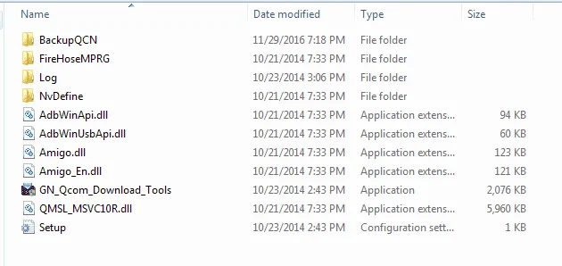

Step 1: Download the “Stock ROM zip file” given above and extract it on your computer. You will find You do not have permission to view the full content of this post. Log in or register now. V2.2.0.0 and firmware files after extracting.

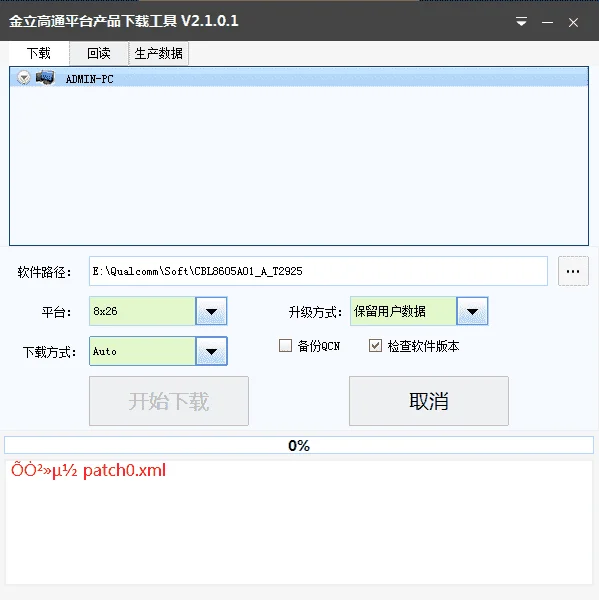

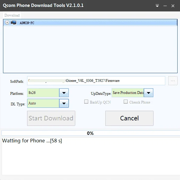

Step 3: Now open the “GN Qcom Download Tools.exe” file. After the Qcom Download Tools is launched, you will see the following screen.

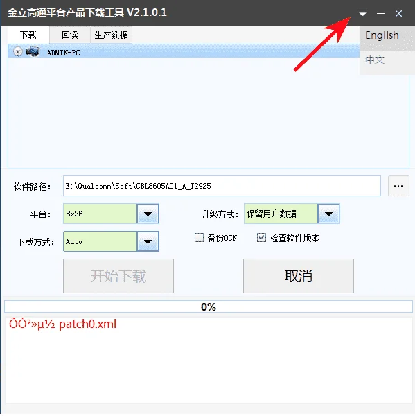

Step 4: Click the dropdown button and select “English” Language.

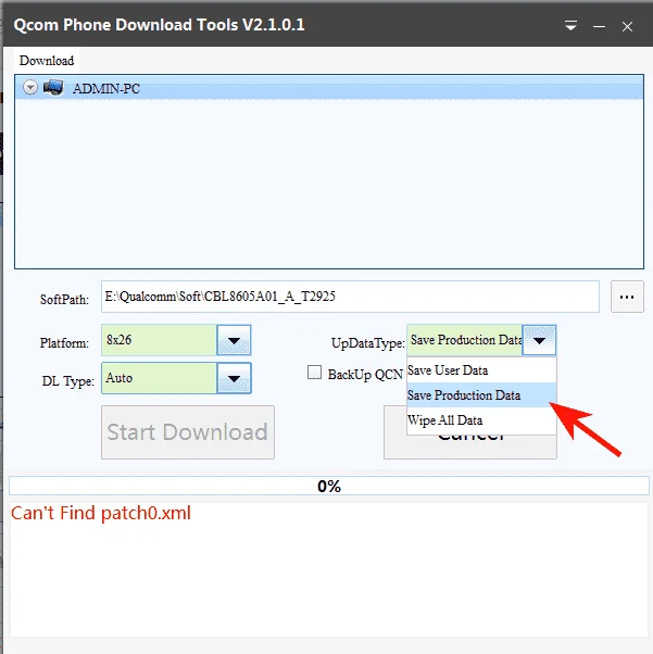

Step 5: Select “Save production data” under “UpDataType“.

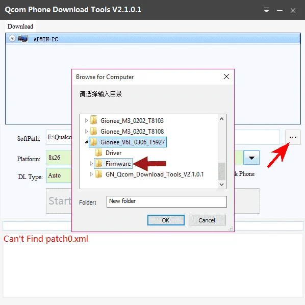

Step 6: Now click on browse button on “Softpath” and locate the firmware files, which you want to flash on your android device.

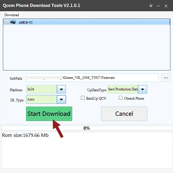

Step 7: Next, click “Start Download” Button.
Step 8: Now connect your Vivo V1 Android device to your computer through original USB cable (without battery – if it is battery removable) and press volume up or volume downbutton.
Step 9: The flashing process will begin momentarily and it will get completed in a minute or two.
