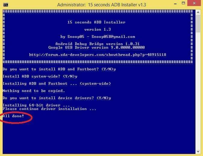

  1. Run the adb-setup-1.3.exe file, now you will see a command prompt
  2. Just type Y and hit enter to all the prompts until you get All done like this11.webp
Once it’s properly installed the windows will automatically close.

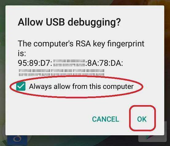

  2. Once you connect to PC, you will get a pop up on your OnePlus 2
  3. Just tick the “Always allow from this computer ” check box and tap OK3.webp

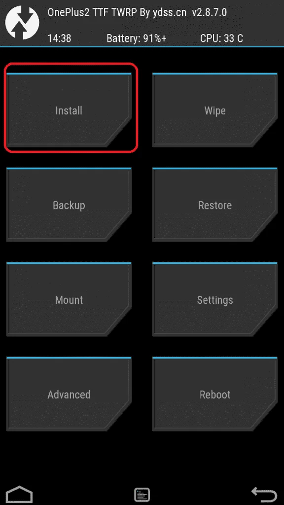

    13. Now Press and hold POWER + VOL down button simultaneously until the device boots. When the OnePlus logo shows up, release the Power and keep holding down VOL DOWN until TWRP boots.
    14. Tap on Install

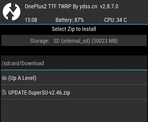

    15. Browse and select UPDATE-SuperSU-v2.46.zipScreenshot_2015-08-19-15-08-22.webp

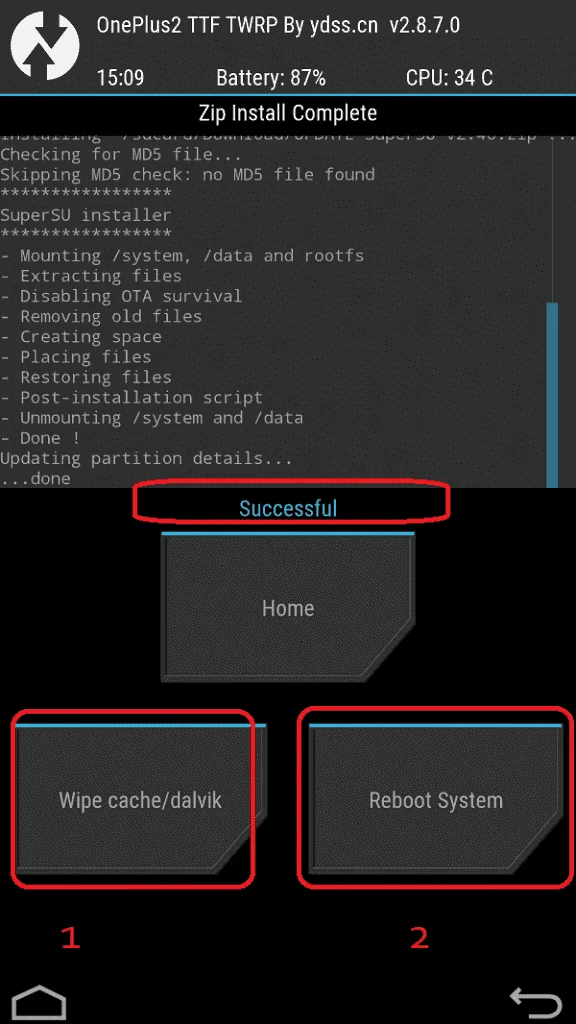

    16. Swipe to confirm the flash
    17. Once done do Wipe Dalvik & Cache then tap on Reboot System To RestartScreenshot_2015-08-19-15-09-001-576x1024.webp
    18. Your OnePlus 2 is now rooted.
