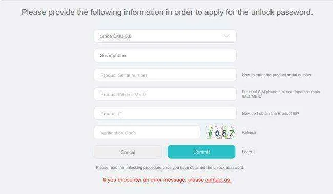

  8. Now fill up the form as you already note down all the details in first three steps
  9. Once you have fill up the form correctly tap on select “commit”
  10. And your unlock code will be shown on the same page, note down this unlock code on a paper

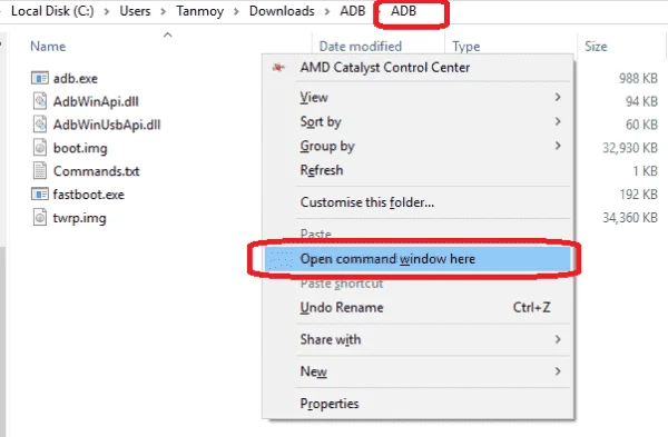

  3. Inside the folder, hold “Shift” Key then right click and select “Open command Windows here”.Screenshot-204-e1462680038164.webp
  4. The Command prompt will open.

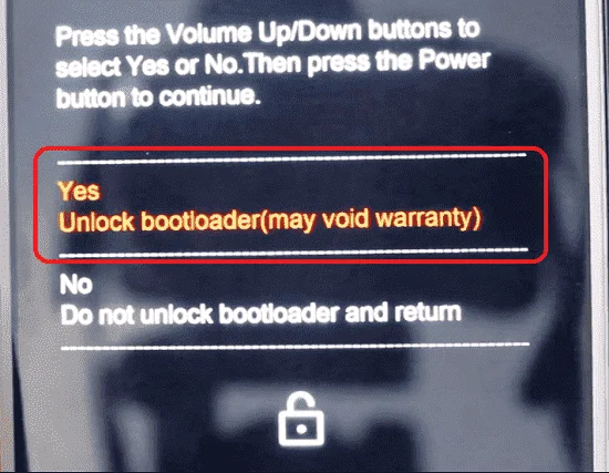

  11. You will get a pop up on your mobile, use volume keys to navigate yes unlock bootloader (warranty may void)Screenshot-183.webp
  12. Then press the power button to execute
  13. Your phone will boot…
