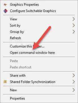

3. Go to the folder where you have placed the downloaded recovery. Press Shift key and right click at the same time & from the options choose “Open Command Window Here“.

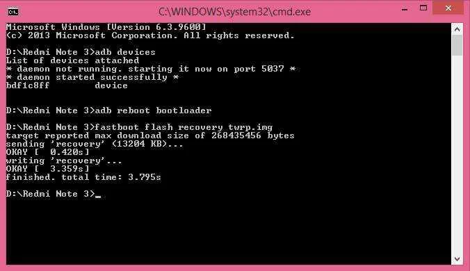

4. Now, Connect your Redmi 4A Phone to the computer using USB Cable.
5. Type the following code to check your device is connected or not,
adb devices
Are they not showing your device? That means USB Driver are not installed properly.
6. Type this code to boot your device into fastboot mode. You can manually boot into fastboot mode by using Power on + Volume Down button.
fastboot reboot bootloader
7. Use this command to install twrp recovery Permanently on your phone. Don’t worry you can flash Stock recovery again with the same method but it will lock your bootloader again.
fastboot flash recovery twrp.img
Now, wait till the process completes. Usually, It will take less than 10 seconds for flashing.
That’s it! We have successfully installed twrp recovery on Xiaomi Redmi 4A using PC.

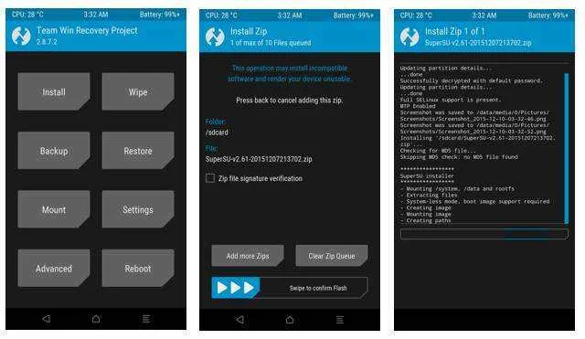

Step 3 – Root Redmi 4A By Installing SuperSU
The whole rooting process is easy after unlocking bootloader and flashing twrp. Now, you just need to flash Flashable Supersu.zip file and you are ready to go.
1. Boot into TWRP Recovery using Power on + Volume Up button.
2. Choose “Install” from the menu.
3. Select SuperSu.zip file the internal storage of your device.
4. Choose “Swipe to confirm flash” button. It will flash it.
5. After flashing Wipe Cache & Dalvik Cache and choose reboot option.
First boot will take some time to load your all apps. So wait for it.
That’s all. so this was the tutorial on Xiaomi Redmi 4A root. Check SuperSU app will be installed there in your system. You can use this to manage root permissions.
