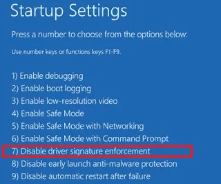

If still not success in installing driver just Disabled Driver Signature Verification
1. Go to PC Settings>General>Troubleshoot>Advanced Options>Startup Settings>Disabled Driver Signature Enforcement>Then Restart
Once you disabled. Then follow the procedure above to install the driver. Once success proceed to next step.

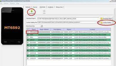

II-FLASHING VIA SPFT
1. Open flash_tool.exe, click on the Download Tab
Extract the downloaded AFP2 stock rom to the new folder you created.
2. Click Scatter-loading and browse for the scatter file (MT6592_Android_scatter)
3. For Bootloop only
Make sure flashing mode is set to “Download Only” and check mark all except Preloader.
Note: If deadboot/hardbrick set “Download+Format” and check Preloader.
4. Click Download.
5. Turn off your phone, connect your phone to the PC and wait for the flashing to commence.
6. Green Circle image with check will show once flashing is completed. That’s it!
7. Disconnect your phone in USB cord then open if still bootloop then try to factory reset in recovery settings. To go in recovery mode reboot your phone hold and press power on and volume up simultaneously until recovery mode appeared.
