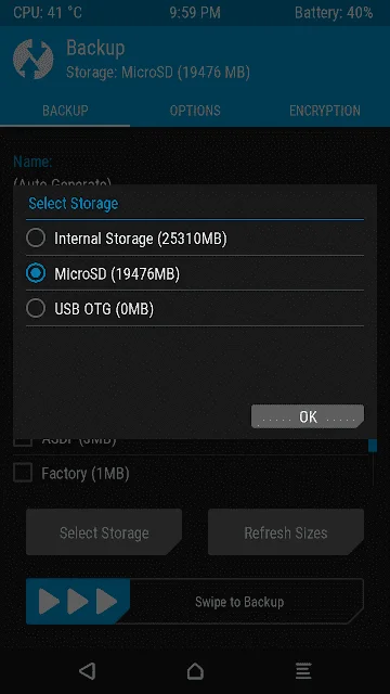

START CREATING BACK UP ROM
1. Click wipe
2. Select Dalvik cache, and cache then swipe to wipe
3. Go back and find BACKUP tab
4. Select where you will store your back up rom internal or microsd (recommended) or create one from internal then create another in microsd then copy those TWRP folder and save to your pc or usb drive or other external devices in case you delete them from your device.
5. You may input your own backup name instead of the auto-generate with date, but I prefer the auto-generate so I can track the date when I made those backups.
Others select system, data, boot as you may check all if you want to.
6. You may skip md5, since most errors come from this
7. You may skip "encrypt your backup" with password then swipe to back up
8. Backup progress
9. Backup complete you may reboot your system and your done
