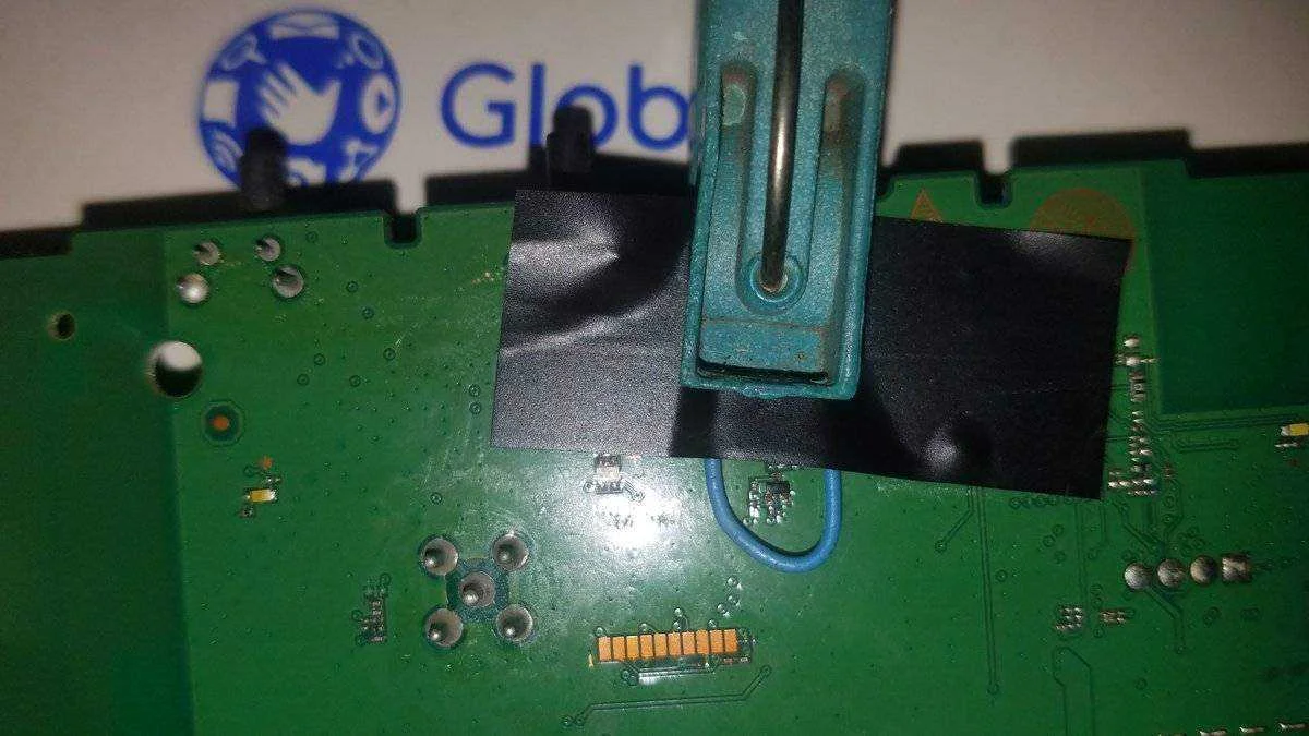

ayaw sakin gumana ng nvram eraser pero nag skip na lng ako , jumper tas balong then install na lng ginawa ko . nasa screenshot yung error sa ADB driver, parang hindi na dedetect yung 936 ko sa comport kapag nag nvram eraser ako after pressing 3 then enter pero nag White led nman sya after nun wala na sa comport tas yung adb driver may yellow sign na.
View attachment 476481 View attachment 476483 View attachment 476492
boss, pa Tut naman sa Jumper ? or baka may iba kang link?
