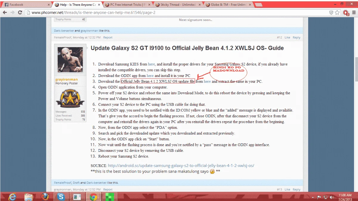

PHCitizens pwede po ba patulong.. kasi po hindi ko po alam kung ano sira ng cp ng tito ko.. unit po Samsung S2 sinubukan niya po kasi i-encrypt tapos po may nagpop-up "need to put password lock to secure files" tapos ok na kaso sinubukan niya naman i-decrypt kasi ayaw niya daw ng may password lahat.. tapos nung nafinish na po yung pag-decrypt hindi na siya nag-open as normal.. Wala na po lumalabas kahit turn on and off yung cp..
sana po matulungan niyo ko.. salamat po.!!

by the way iupdate mo sya sa Advance I9070 ng galaxy s diba nahanap ko file mo ang laki 433.7 MB
additional info kung iupdate mo yan need mo ito.
Prerequisite:
1. Your mobile should have 70 –
80% battery
2. Make sure that you have
enabled USB debugging (All apps
Settings > Manage Applications
Development > USB Debugging
– check box)
3. Ensure you have backed up
your important data.
Step by Step Guide
on:
How to install Android
4.1.2 Official Jelly Bean
On Galaxy S Advance
I9070
Step 1: Download Android 4.1.2
Official Jelly Bean on Galaxy S
Advance I9070 and extract it on
desktop.
Step 2: Download Odin v1.85 to
flash Android 4.1.2 Official Jelly
Bean on Galaxy S Advance
I9070 and extract it on desktop.
Step 3: Now, switch off your
phone to boot it into Odin/
Download mode by pressing and
holding Volume down + Home +
Power Key (long Press) , till you
see the Android Logo on screen.
And then press the Volume Up
key to enter download mode.
Step 3: Open the “Odin.exe ”
and then connect your phone to
computer via USB cable. As soon
as you connect, ID:COM box in
Odin turns light green/yellow.
Step 4: Now select the files as
per below instruction to install
Android 4.1.2 Official Jelly Bean
on Galaxy S Advance I9070. Files
are found to be from the
extracted folder.
Click on “PDA ” and select
file with “CODE ” in its
name.
Click on “Phone ” and
select file with “MODEM ”
in its name. ( Note: Ignore
this step if you don’t able
to find such file)
Click on “CSC ” and select
file with “CSC ” in its
name. ( Note: Ignore this
step if you don’t able to
find such file)
Click on “PIT ” and select
“.pit ” file. ( Note: Ignore
to find such file)
Step 5: Make sure that only F.
Reset Time and Auto
Reboot boxes are checked on
Odin. Don’t check any other
boxes.
Step 6: Click on Start button on
Odin to start installation
process. It will take upto 5 – 8
minutes, so please wait for the
installation finish.
Step 7: Finally, you will
get PASS! Notification on the ID:
COM box and then your device
will reboot automatically and
now you can unplug your phone
from computer.
