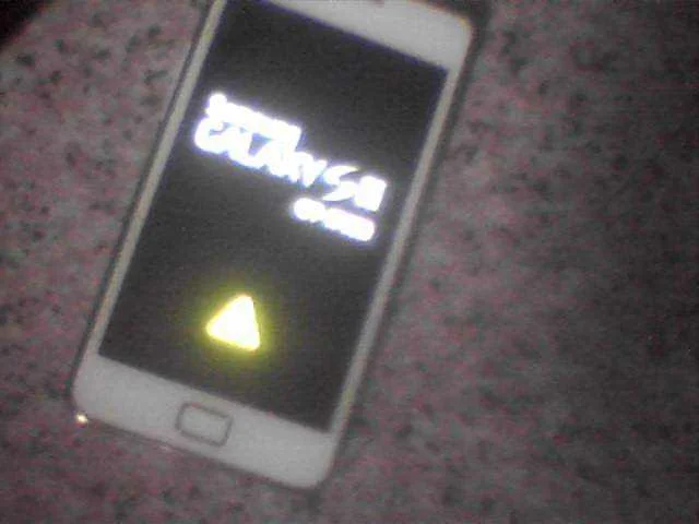

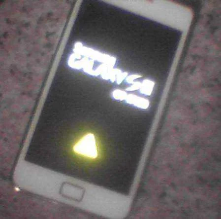

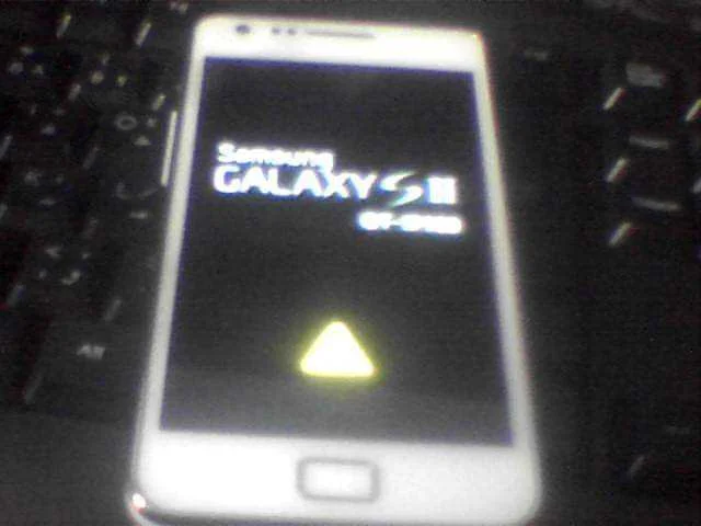

PHCitizens pwede po ba patulong.. kasi po hindi ko po alam kung ano sira ng cp ng tito ko.. unit po Samsung S2 sinubukan niya po kasi i-encrypt tapos po may nagpop-up "need to put password lock to secure files" tapos ok na kaso sinubukan niya naman i-decrypt kasi ayaw niya daw ng may password lahat.. tapos nung nafinish na po yung pag-decrypt hindi na siya nag-open as normal.. Wala na po lumalabas kahit turn on and off yung cp..
sana po matulungan niyo ko.. salamat po.!!

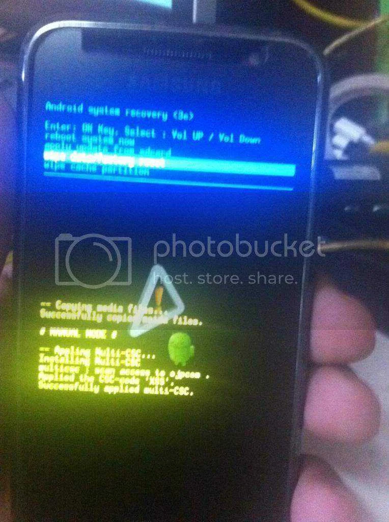

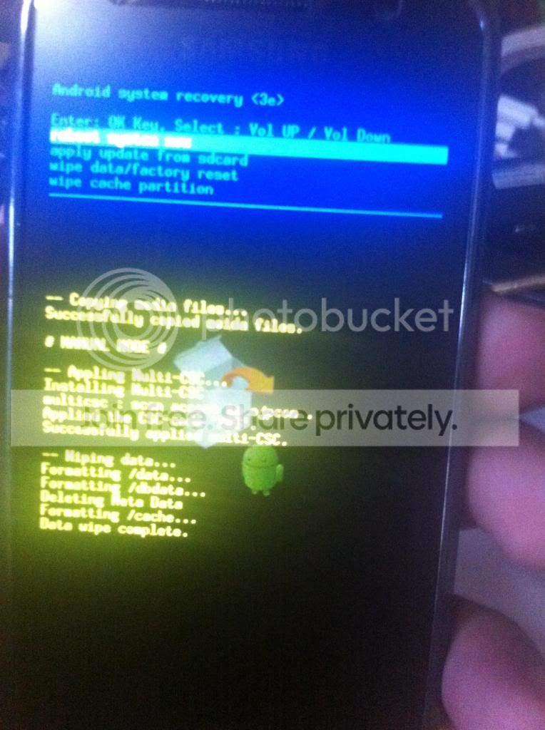

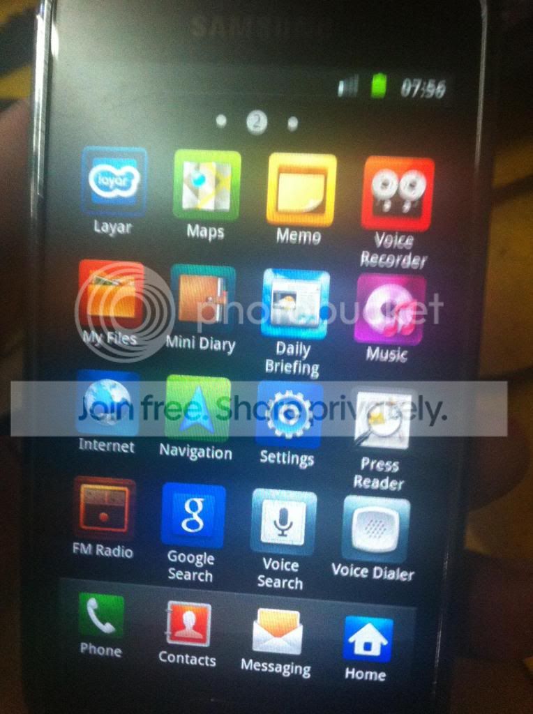

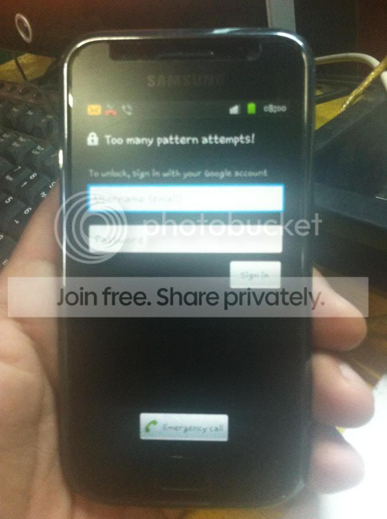

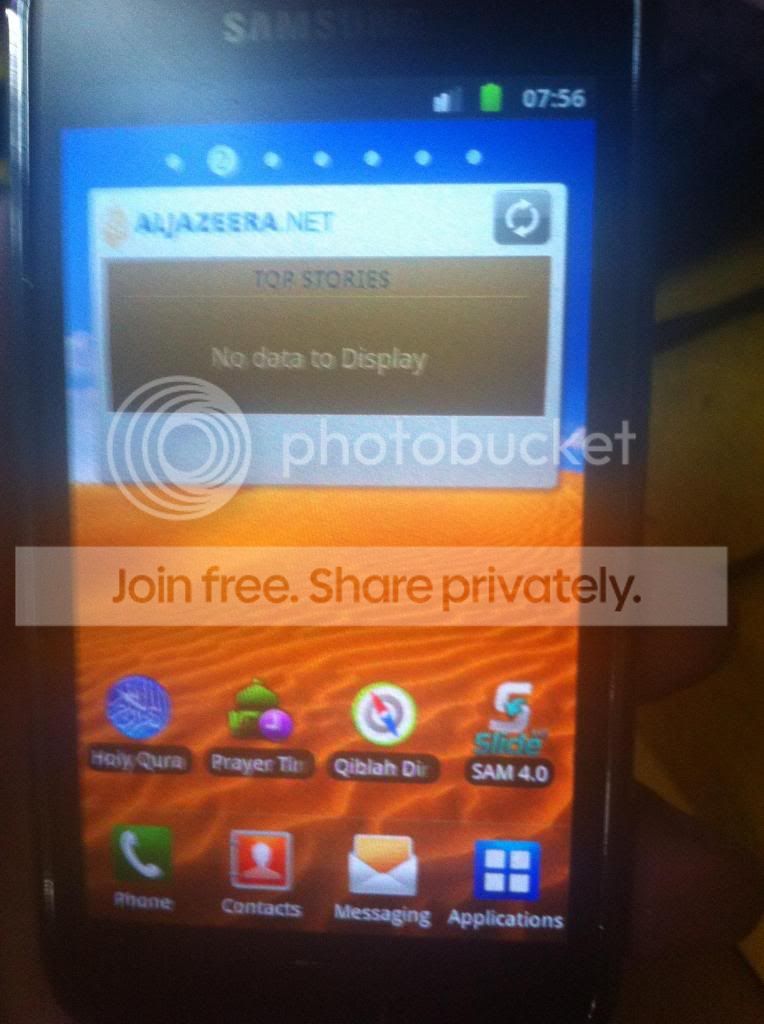

nahanap ko na solosyon boss iadd ko dito wait...
Samsung i9000 galaxy s tmpa
done sa hard reset...
ss:
Code:
SOLUTION
HARD RESET
PRESS AND HOLD VOLUME UP
AND POWER
KEEP PRESSING THESE TWO
BUTTONS+PRESS POWER BUTTON
FOR 2-3 SEC
RELEASE POWER BUTTON BUT
KEEP PRESSING VOLUME UP AND
HOME BUTTONS
WITH VOLUME DOWN SELECT
WIPE DATA/FACTORY RESET
SELECT IT BY PRESSING HOME
BUTTON
SCREENSHOTS
yan po boss try and try boss kung di yan makuha need po yan iflash by odin.
pm mo na lang ako kung working o hindi sa technician 500p pag paayos nyan dito libre stuck sa logo kasi try and di pwedeng walang hard reset yan.kung talagang not working flash to recovery via odin mangyayari nyan wait din tayo sa ibang ka phc help team baka may odin sila naka android lang ako wala ako pc. just helping boss. :)
