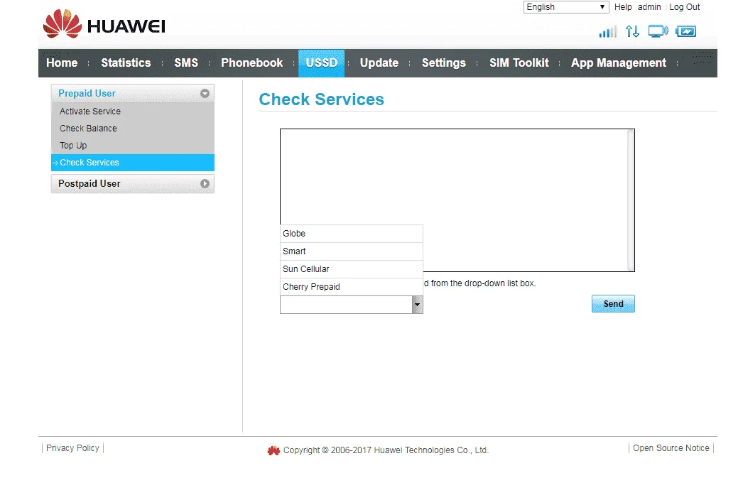

10. Install din si WebUI (21.100.32.00.03) o ito Globe WebUI (21.100.29.00.158). Pili lang kayo sa dalawa kung ano preferred nyo gamitin. [Sa stock Huawei, mapapalitan ang signal indicator nyo ng 4G, 3G at 2G at nework name dalawa lang makikita nyo, either SMART or GLOBE lang. Sa stock Globe, makikita nyo sa signal indicator nyo kung saang network kayo nakaconnect, LTE, HSPA, HSPA+, WCDMA, EDGE, GPRS etc. at makikita nyo rin yung tunay na network name ng sim card mo, either GLOBE, TM, ABS-CBN, SMART, TNT o SUN gamit ang Huawei HiLink app mo pero sa dashboard malaking logo lang ni GLOBE makikita mo, walang network name]

17. Kapag natapos na si step 16, magrerestart na si 933 at hintayin nalang natin sya magbukas. Ayos na yan. Unlocked with LAN MAC address, SSID, WIFI KEY at fully functional RESET button. I-reset mo ng i-reset hanggang magsawa ka ;)
18. Bisitahin nalang natin dashboard ni 933 (192.168.8.1), default username & password is admin.
