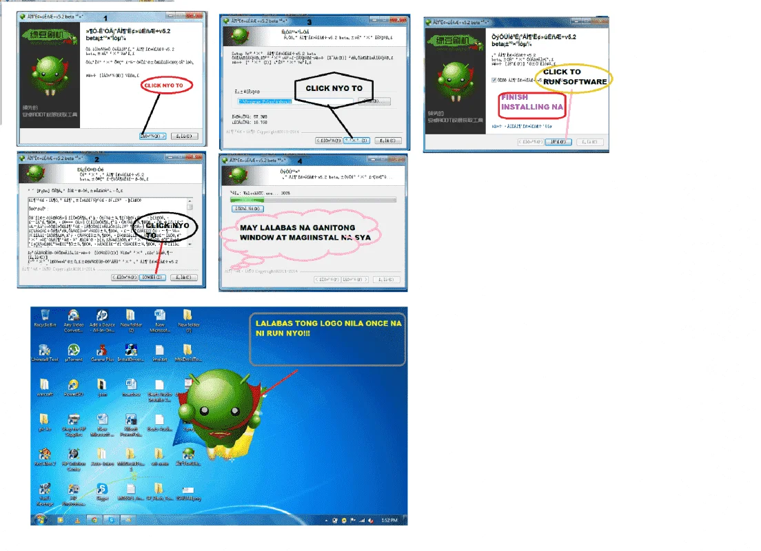

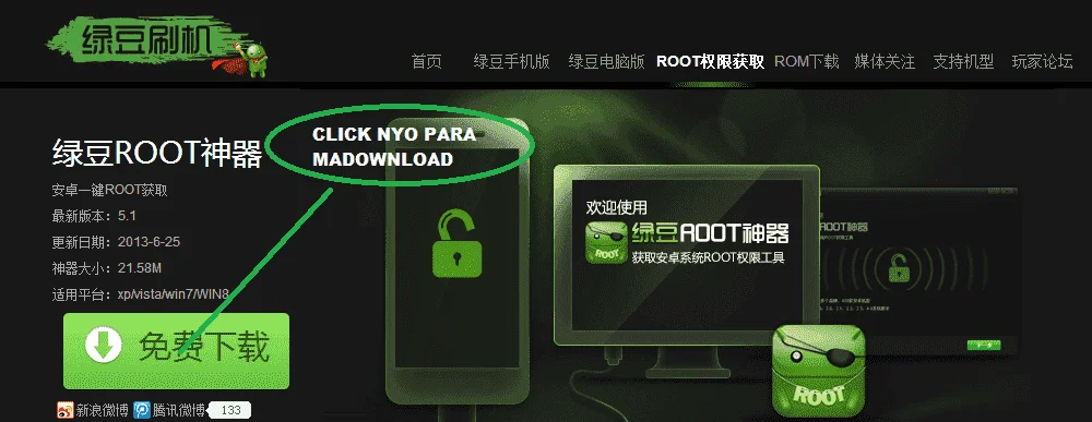

STEP 2.) PUNTA KAYO SA SITE NA TO You do not have permission to view the full content of this post. Log in or register now. FOLLOW NYO UNG IMAGE KASI CHINESE SITE SYA EH..PWEDE NYO DIN ITRANSLATE USING GOOGLE CHROME BROWSER !!! :)
*ONCE NADOWNLOAD NYO NA FOLLOW THIS IMAGE TO INSTALL CHINESE CHARACTER KASI KAYA DI NYO MAIINTINDIHAN :)

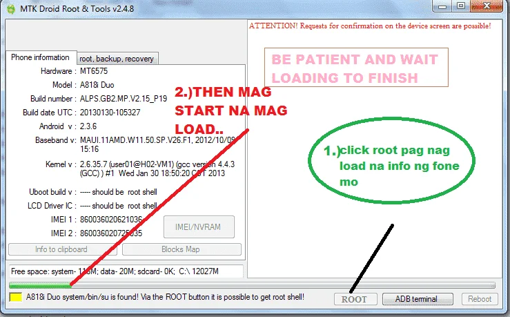

STEP 5.) DOWNLOAD KAYO NG MTK DROID ROOT AND TOOLS IN THIS LINK You do not have permission to view the full content of this post. Log in or register now. THEN UNZIP NYO LNG THEN RUN MTKDROIDTOOL.EXE
STEP 6.) PAG NAG RUN NA UNG MTKDROID ROOT TOOLS CONNECT NYO UNG FONE NYO DAPAT NAKA ENABLE PA DIN USB DEBUGGING AND USB CONNECTION THEN FOLLOW THIS IMAGE :) (WAG ITURN OFF CP NIO PAG PLUG NYO SA PC!!)

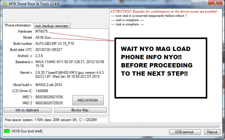

UNG YELLOW NA INDICATION SA MTK ROOT TOOLS MAGIGING GREEN ONCE NATAPOS NA YUNG LOADING THEN FOLLOW THIS FINAL STEP MGA BRO !!!! :)
PWEDE NYO NA DISCONNECT FONE NYO AT MAY NAKAINSTALL NA DITONG SUPERUSER ENGLISH VERSION,MOBILE UNCLE TOOLS AT ROOTEXPLORER MGA BRO TRY TO RUN ROOT CHECKER PARA MALAMAN NYONG TOTALLY ROOTED NA KAYO..YEHEY !!!!
