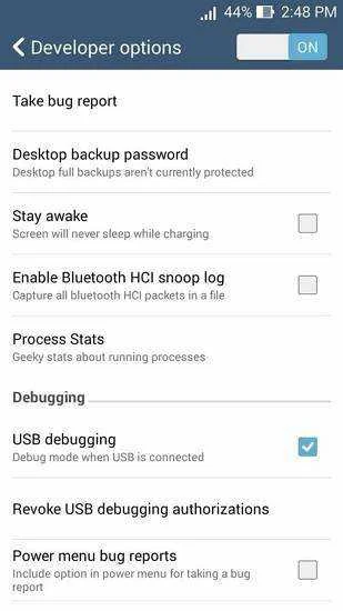

  • โ€ข Enable โ€œUSB debuggingโ€ mode on the LG device for proper connection of the Android device to the computer.

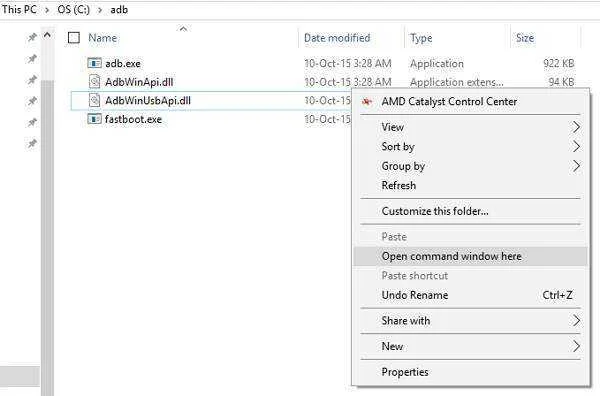

Step 1. Make sure that you have installed ADB and fastboot on the computer. It is imperative to have the ADB and fastboot already installed on the computer.
Now, place the twrp.img file you have already downloaded in the folder named โ€œAdb & Fastbootโ€ on the computer you are using.
Step 2. Now, open the command prompt within the ADB & Fastboot folder by using Shift + Right click anywhere inside the folder and choosing โ€œOpen Command Windowโ€ as shown in the picture below.

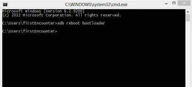

Step 3. Once the command prompt window is open, have the LG K10 device connected to the computer to execute the command โ€œadb reboot bootloaderโ€, as shown in the picture below:
Now choose โ€œOKโ€ to allow USB debugging on the LG device for it to be properly connected to the computer. Having the โ€œUSB debuggingโ€ mode enabled on the LG device prior to this process is always better.

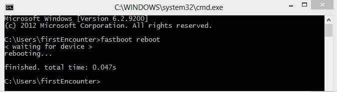

Step 4. The LG device will work in bootloader mode now. Execute the command โ€œfastboot flash recovery twrp.imgโ€ to flash the TWRP. img file now.
Use the twrp.img name (name of the file downloaded earlier by you) in the command. Once the TWRP is fully flashed on the LG K10 device, reboot the device using the command โ€œfastboot rebootโ€ as shown in the image given below:
This will take few seconds before the TWRP custom Recovery is fully flashed on the device.

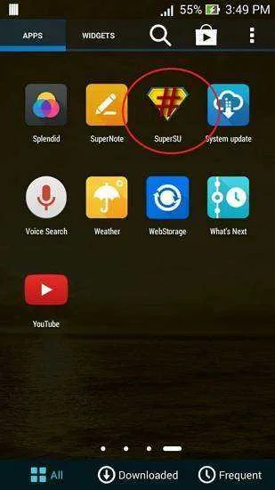

Part 3: How to install SuperSU on the LG K10
SuperSU is a manager app which manages the root permissions on the Android device once it is rooted. In the SuperSU flashable zip, comes SuperSU app and binaries necessary to get root access. So, you can flash the flashable SuperSU zip file via a custom recovery to get the root access on the LG K10 device.
Since, here we already have installed TWRP custom recovery in the LG K10 device, the next step is to flash the device with SuperSU app to get root access.
Hereโ€™s how you can install SuperSU and root LG K10 device using TWRP Recovery:
Step 1. First of all, download the SuperSU. Zip file from internet. This file contains the SuperSU app along with the binaries required to get root access of the Android device.
Step 2. Locate and select SuperSU zip file that you have downloaded and move it to the internal storage of the LG K10 device.
Step 3. Now, boot the device into โ€œRecovery Modeโ€. Use Volume Down button and the Power button simultaneously to go into Recovery Mode.
Step 4. In TWRP Recovery, click the โ€œINSTALLโ€ menu and then browse for the SuperSU.zip file earlier placed in the internal storage. Select the SuperSU.zip file.
Step 5. Swipe to confirm and install SuperSU at the bottom of the screen to initiate flashing.
Once the installation of SuperSU is complete, reboot their device. Choose the โ€œReboot Systemโ€ option presented to you to reboot the device. The device will reboot normally in some time.
