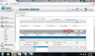

Alam nyo ba na ang Firewall ng 622i ay capable of blocking everything, even ICMP, ACS​
open your web GUI then Login as "admin" ​
290scqh.webp​
Go to Advance> Firewall​
a4o9op.webp​

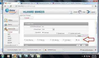

Click on Firewall Level Then Pick Custom then type whatever you want Then Hit Apply​
cjndy.webp​

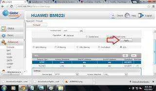

Again Click Firewall Level Then Choose the one that you typed, mine was "new"​
345kkeh.webp​
Pick Set Level on Operation Mode then hit apply​
dynlv9.webp​

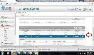

Click ACL "Access Control List"​
2nak745.webp​

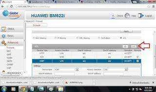

put Check on ACS and ICMP then Hit The negative sign " - "​
35iveav.webp​
5zp5wz.webp​
Now Click the ADD sign or Positive sign​
4sk64l.webp​

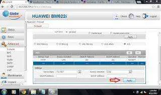

Click Service type then pick TELNET make sure the access direction is "LAN"​
then Hit Apply​
s1q3gk.webp​
Hit Apply ​
2jftxv.webp​
SO yung ginawa natin ay tinanggal natin sa list yung ACS at ICMP, iniwan lang natin yung HTTP at TELNET with Access Direction na LAN , dahil dun, using 622i firewall itself We prevented ACS from accessing our modems to do such an update​
d4bvb.webp​
