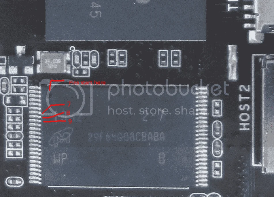

Unbrick Rock Chip
Is it bricked?
When writing update.img to nand RKBatchTool failes with following message: "Prepare IDB Fail" (or similar error messages like "IDB download failed" when writing to nand with other tools)
Turn off Power.
Connect pin 8 and 9 on the nand with a needle and plug OTG USB cable in the PC.
    1. Turn off Power.
    2. Connect pin 8 and 9 on the nand with a needle and plug OTG USB cable in the PC.
    3. After Plugin remove needle connection. In RKBatchTool the square should now show up blue (if it isn't blue, retry).
    4. Click the restore button and upload an update.img
    Hints
    • Its useful to use a magnifying glass or (smartphone-)camera zoom to get the right pins.
    • Always start counting pins on the edge of the chip where the small circle is molded in or printed on.

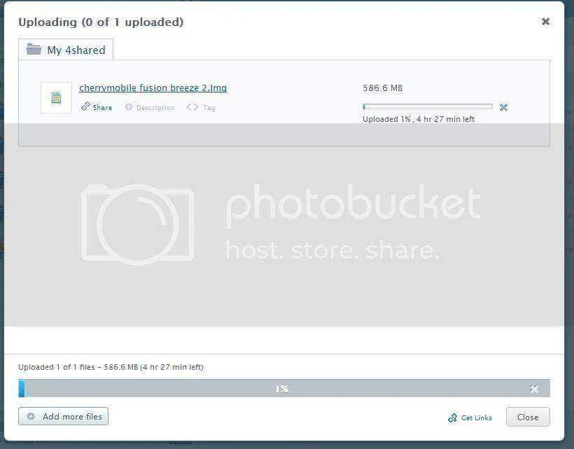

i try mo lang ito You do not have permission to view the full content of this post. Log in or register now. just replace dot with . or ito pang sd card You do not have permission to view the full content of this post. Log in or register now. just replace dot with .
