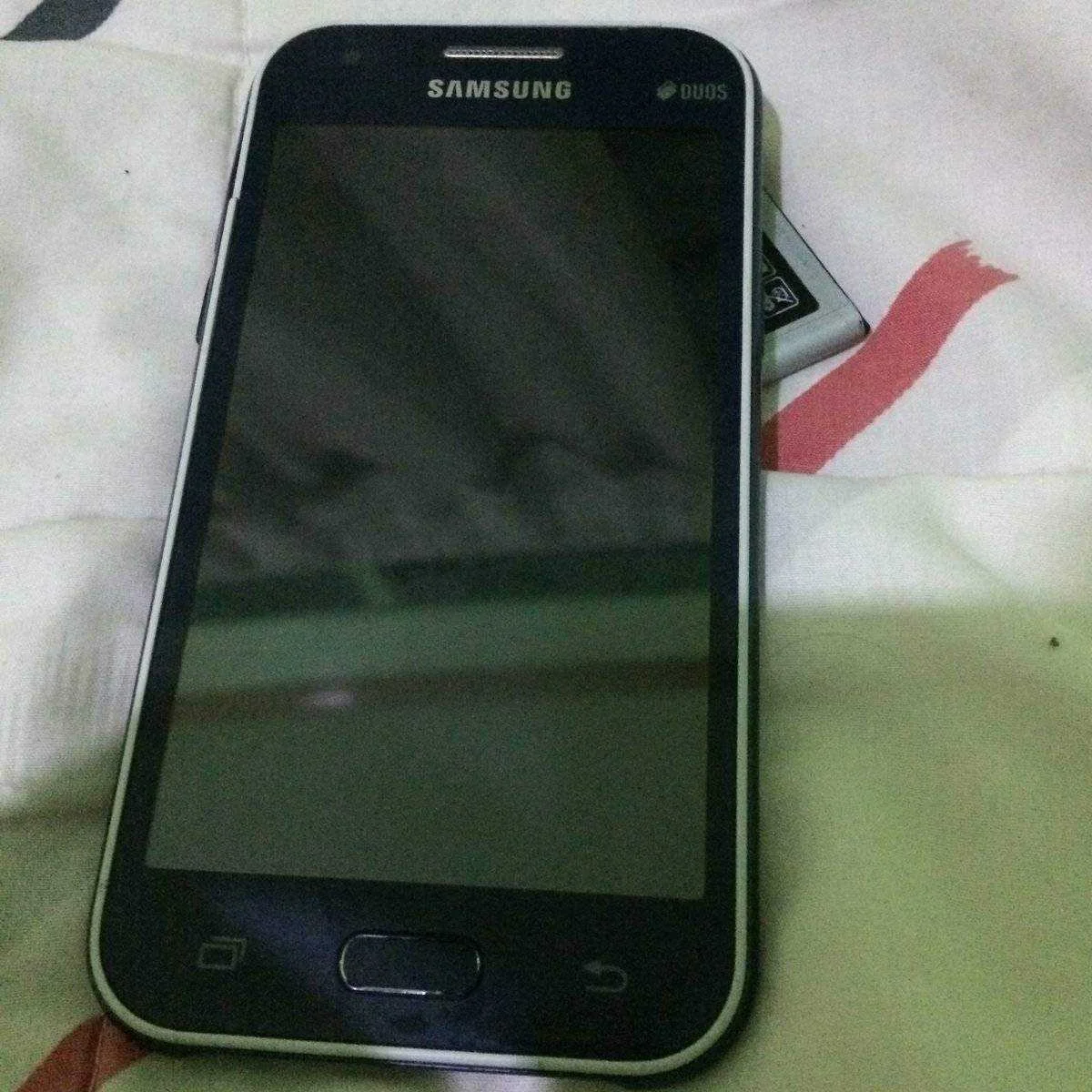

Good Evening everyone as per what title say i kinda need your help my sister forgort his pin code yesterday and I thought it would be easily removed by doing factory reset. Nag search na po ako sa youtube also here and tinary ko yong android multi tool but it seems that tool does not work on her phone. Please help me to get rid on this problem.
Your help will be greatly appreciated.

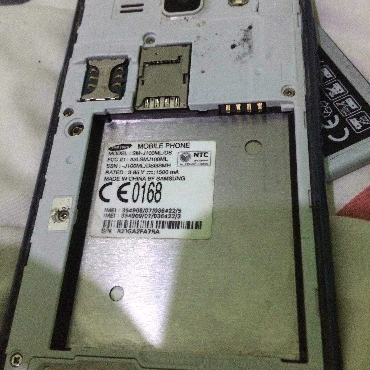

Model: SM-J100ML/DS
FCC ID: A3LSMJ100ML
SSN: J100ML/DSGSMH
I wonder sir bakit yong ibang samsung phone ang dali lang e factory reset bakit ito ang hirap? Ganito ba talaga mga J1 na phone? Nag search ako sa YouTube tama naman ginawa ko Home button + Volume up + Power switch
