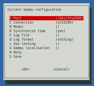

Now you can use gammu-config to configure your hardware or you can write Gammu configuration file manually. Here's how to do it using gammu-config:
Code:
gammu-config
Here's how you will setup your hardware with port ttyUSB0 and connection parameterat19200 I'm using for my Huawei e220 GSM modem:
After you set configuration options you can save changes and you will get Gammu configuration file .gammurc file inside you home directory. You can also save this file for future use once you are sure that configuration it contains is correct.

it works!.. I am using unlocked Globe Tattoo's Huawei E1550 using the same set-up.. additional note to the steps TS.. after adding the DIALOUT user "sudo adduser $USER dialout" and install Gammu Wammu don't forget to log-out or restart your system.. then on the part where you need to configure hardware "gammu-config" there is an image part there that did not appear on my screen but here it is.. just change the port part to tty USB0 click OK then click SAVE.. and that's it!
