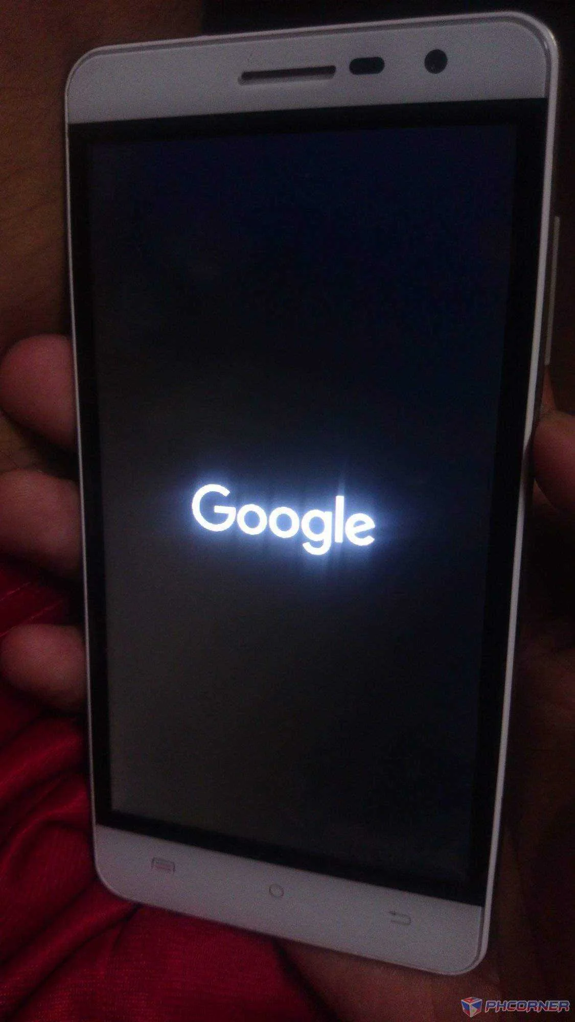

To this -
full
For this tutorial: I gonna use Cherry Mobile Flare S4 Lite .

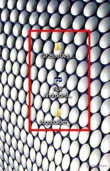

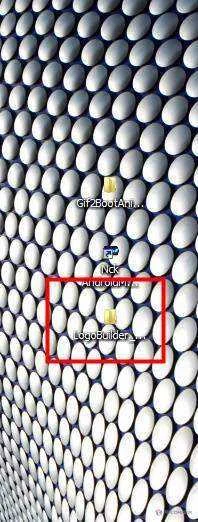

1. Download the two files which, Logo Bulider and NCK AndroidMTK Cra:ck. Then extract it sa kung saan mo gusto.

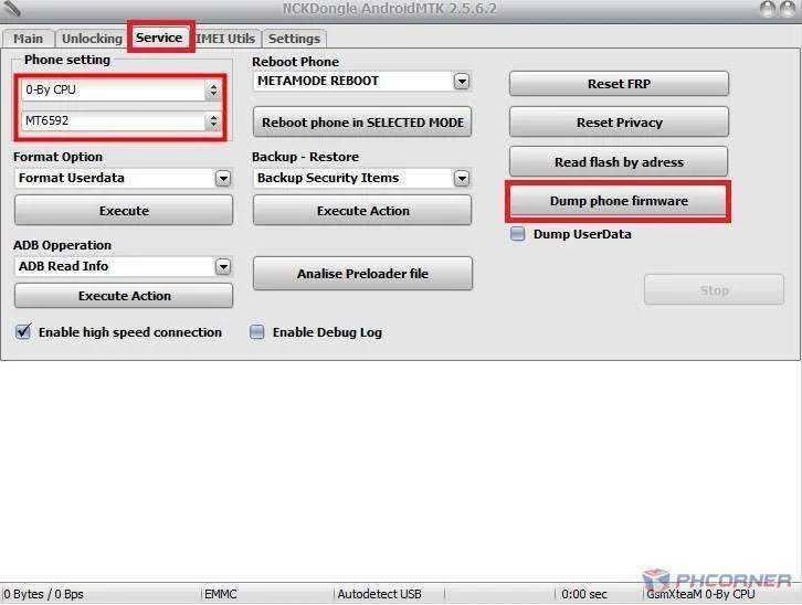

2. Now open the NCK AndroidMtk First.
3. Then sa NCK Menu punta ka sa Services tab, then select your processor. Then click Dump Firmware.
full
#1 : If ng mtk processor mo hindi kasama sa listahan, pick the closest one. Na malapit na numbero ng processor mo.
#2 : If wala kang MTK Usb Vcom Drivers para maback up or mafetch ng stock rom , please check the driver folder sa program directory ng NCK.

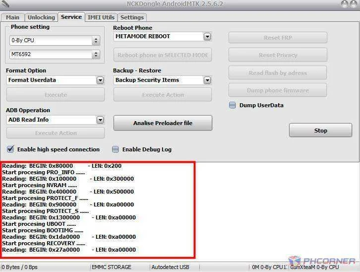

4. To start dumping your phone firmware,
"IF Removable ng Battery"
Connect the usb cable without battery, once narinig ng device connected sounds insert the battery.
"IF Non-Removable ng Battery"
Just power off the device by holding power button for 15 secs.
Until makita mo ito.
full

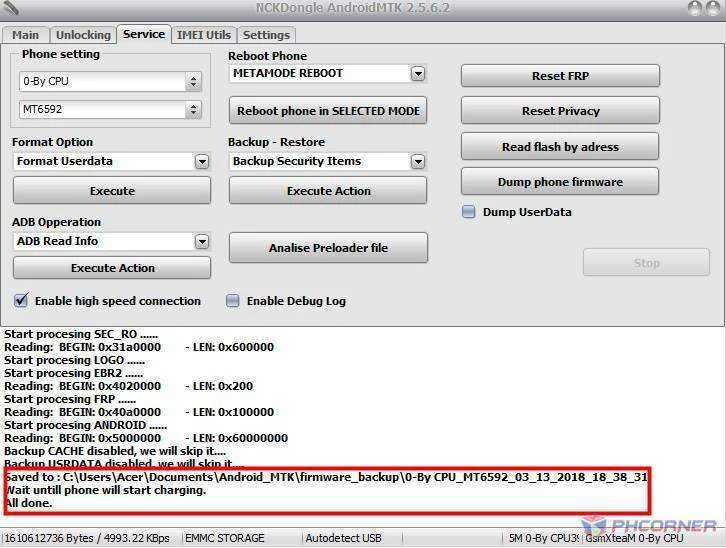

5. After matapos ng process.
full
Punta ka sa directory, kung saan nakasaved ng backup rom mo.

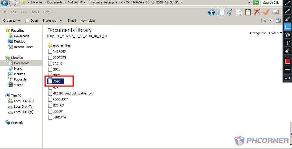

6. Now sa nabackup firmware mo, look for the filename LOGO.
full
Then once you found it, rename it then add .bin sa filename.
full

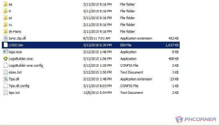

7. After renaming, copy the file sa folder ng LogoBuilder.
full
full

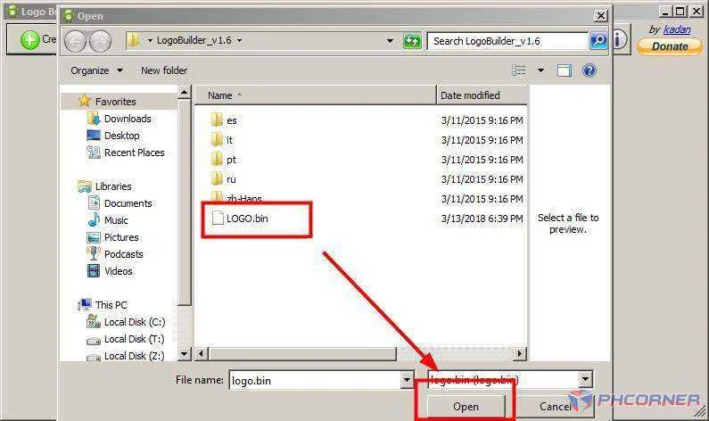

Then select the file na nasa sa logobulider folder.
full

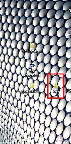

After load the logo.bin, pick a location kung saan mo siya idedecompile. Much better kung gagawaan mo ng folder.
But DO NOT EXIT the program.

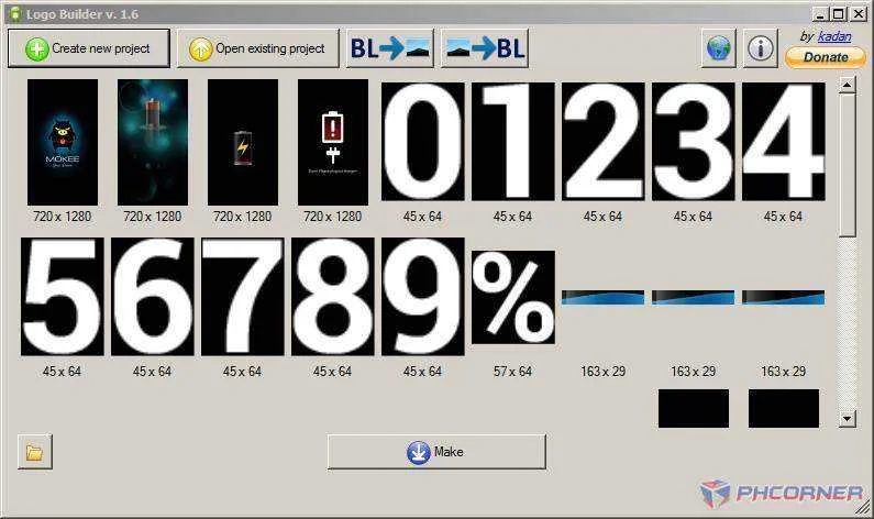

10. After maload mo ng image, meron mga 39-45* images sa laman ng logo.bin na iniextract mo.
full
So punta ka sa folder kung saan ng decompile and recompile ng logo mo.
full

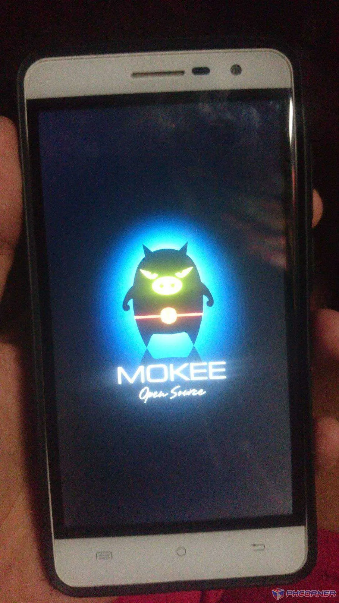

#2 - Para sure na mapapalitaan ng bootimage mo , check mo yung picture kung anong original niya.
https://phcorner.org/media/27900/

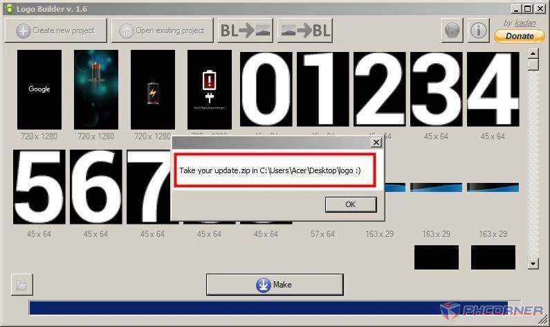

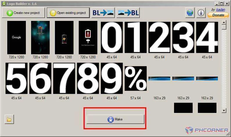

12. After resizing, and replacing the original images. It's time to build it.
Now go back sa logo builder. Meron na Make button sa program. So click it.
full
After processing, it's time to copy to your phone and boot to TWRP.
full
13. Boot to TWRP, then click install.
14. Then click on update.zip , then swipe left to confirm.
15. Then click reboot system now.
DONE!
