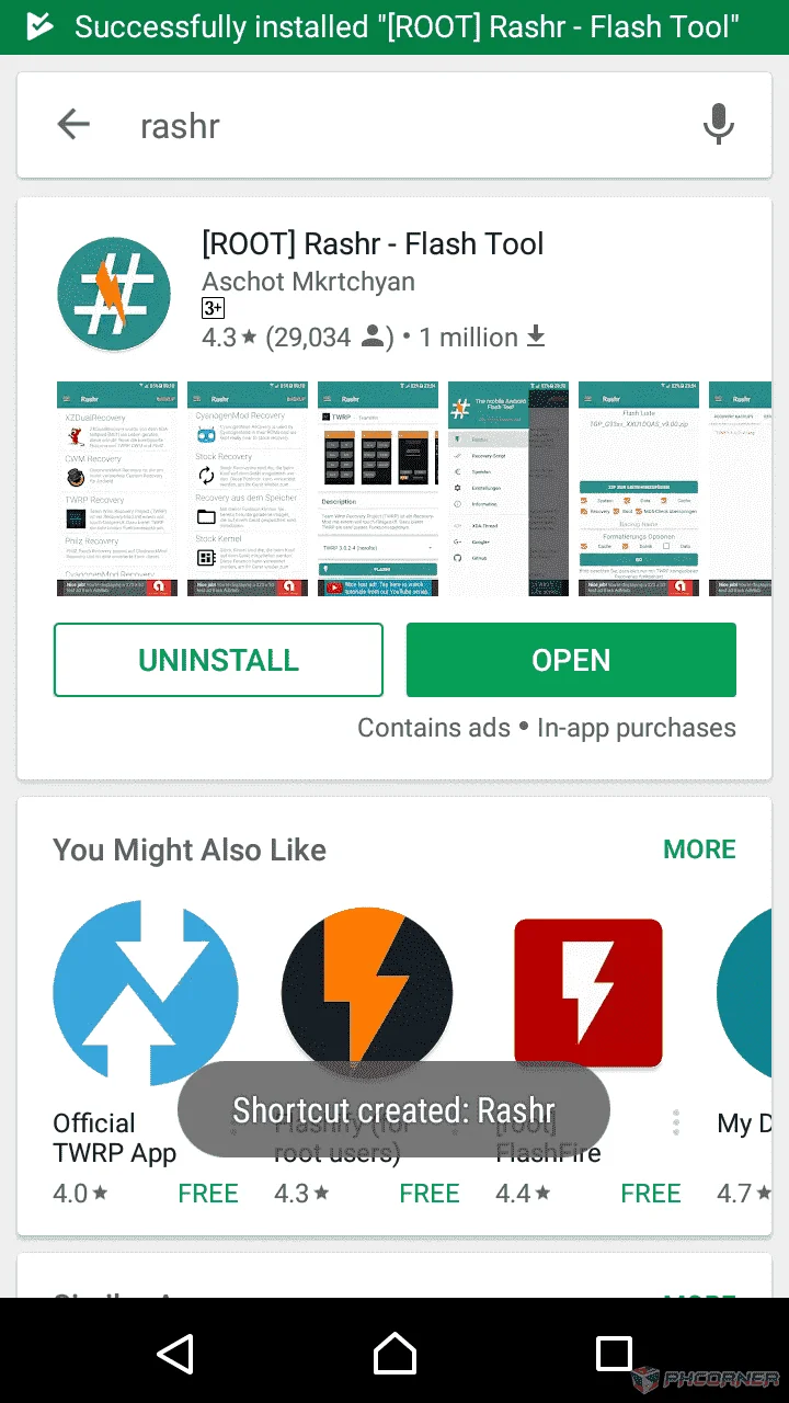

1. Download Rashr on Google Play Store and install it.
full
2. Once done, SuperSU ask a permission. Tap to accept.

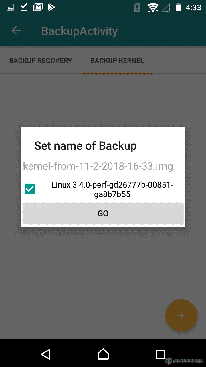

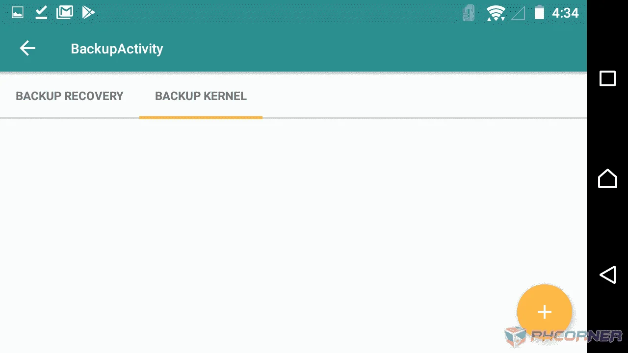

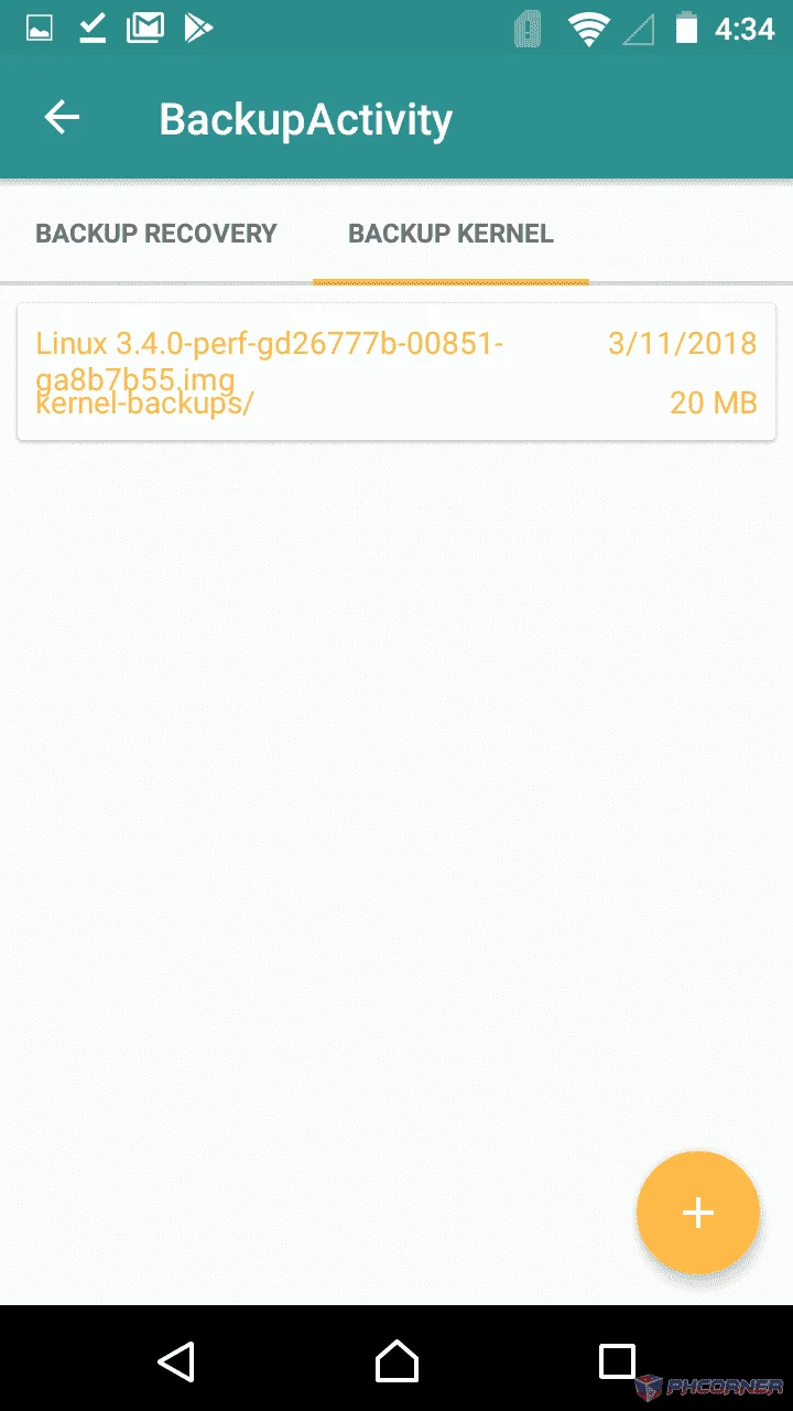

4. Now, in backup section. Swipe left then click + sign sa lower right corner.
Then check the current version of your kernel.
full
full
Now, meron ka nang original backup.

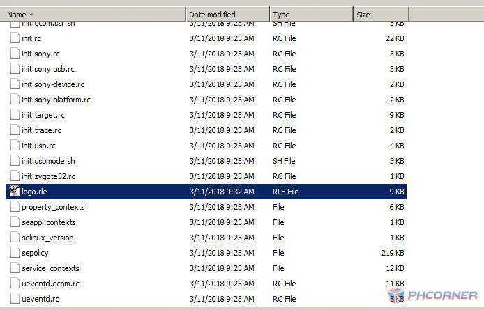

9. After extracting, open the ramdisk folder and copy the logo.rle to bootlogo.rle folder.
full
full

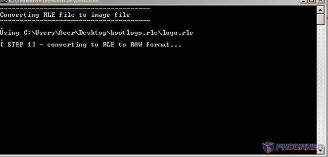

11. Sa loob ng bootlogo.rle folder, meron mga .bat files. Which is rle-to-image and image-to-rle.
(Vise-Versa)
Now drag the logo.rle sa rle-to-image.bat .
full
It may take some time. So be patient.
full

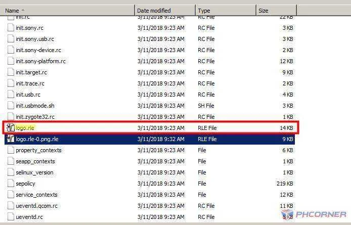

13. Now copy the file name sa iniwan mong .png file sa extracted logo.rle mo then delete the original file. And lagay mo yung gusto mong bootlogo image.
full
full

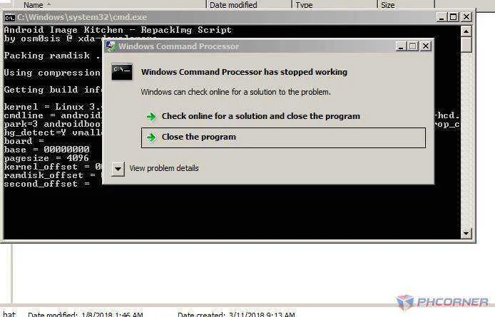

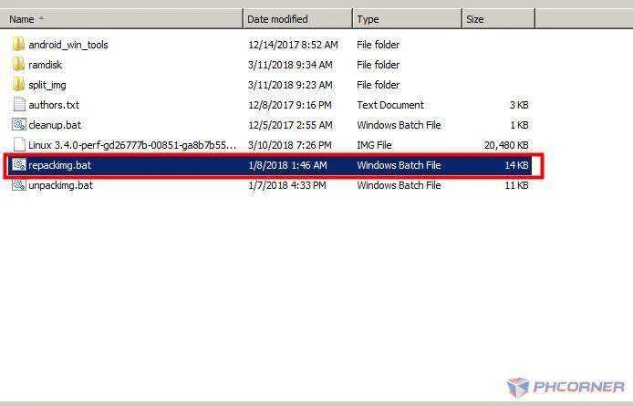

16. Now, back to the main folder ng Android Image Kitchen. Open mo yung repackimg.bat .
full
If you see force close during command.
full
Don't worry. Just close it. It's fine.

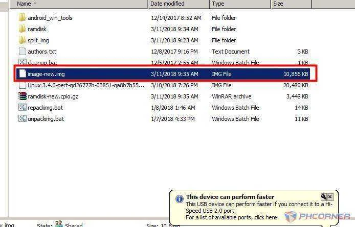

17. Once done, connect your device sa pc. Then copy the new modified boot.img.
full
full

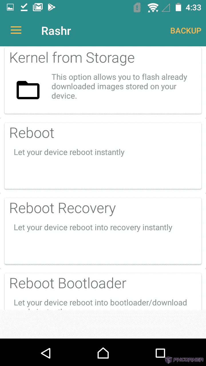

18. Now back to the phone!

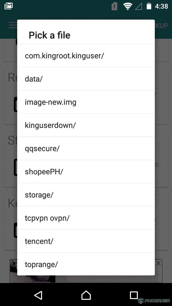

Open the rashr again, select the kernel from storage.
full

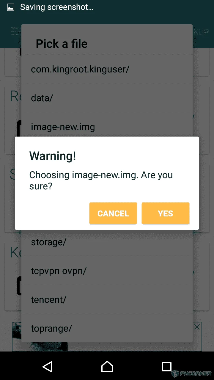

Now hanapin mo yung file kung saan mo nilagay.
full
Now, confirm to flash it.
full
Once finished again, click on reboot.

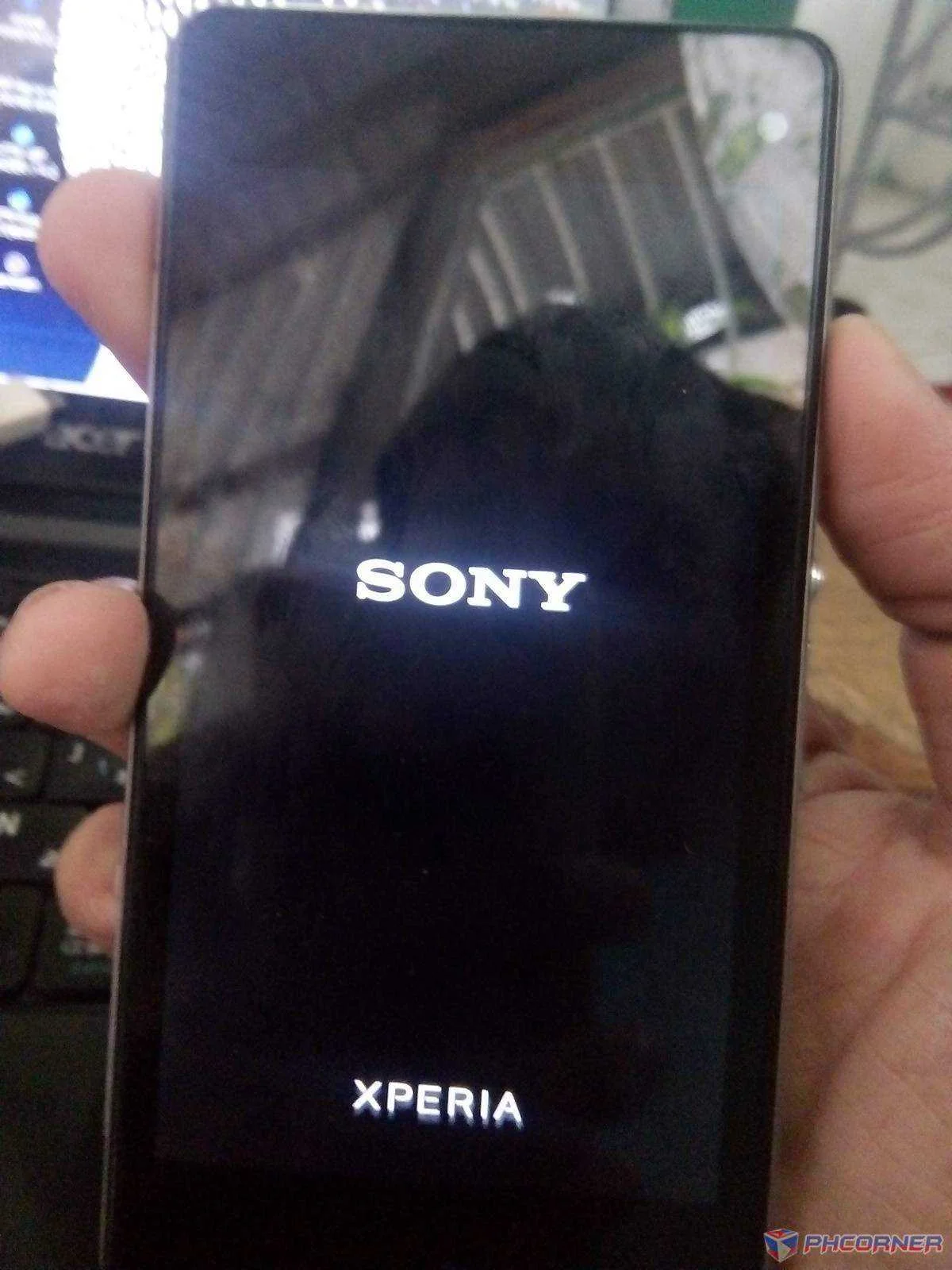

Before
full
After
full
(I know is not the way i expected. But i gonna work it soon! :) )
