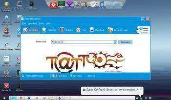

UNLOCK YOUR GLOBE TATTOO E153 HUAWEI MODEM
Tools needed:
1. QPST software
2. Huawei flasher
3. Huawei e153 firmware
Install the QPST Software
Close your Broadband
Open QPST Configuration
ADD NEW PORT
Uncheck the Show Serial and USB/QC Diagnostic ports only
HANAPIN NYO YUNG PORT NYO SA DEVICE MANAGER,PORTS. Example 3G APPLICATION INTERFACE(COM9)
Click Start CLients then Software Download
Click Backup then Start
pag natapos na exit lng
Open Huawei flasher
hanapin nyo yung port nyo jan sa may bilog
Click Select Firmware then Extract from EXE
Extract the e153 firmware
lagay nyo sa folder na madaling hanapintapos click nyo then open then enter
Uncheck the 06.bin
click flash modem then click Normal Mode
then pag my lumabas na mga form click ok lng
OPEN QPST Configuration again QPST Software Download
Click Restore then Start
NOW Try to insert Smart or Sun sim :D
ENJOY!! :sê×ÿ: :gangnamstyle: :sê×ÿ:

sir jehadhd it works fine with my E1552 model huawei broadband.. salamat po ..
gamit ko pa configs ni sir richardrr ... XD anggaling .. di na kO manLilimOs ng signal sa GLOBE hihihi ..
thanks MASTERS ..
