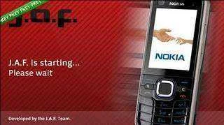

• Run JAF Emulator, In Tab Step 1, select Random PKEY Raskal SN, then stepped to Tab Step 2, select the JAF (main), then click the GO (selected launch EXE). (THERE IS ON FILE YOU DOWNLOAD)

• JAF will open, you will see an error message (Error: BOX DRIVER NOT installed), click OK Only.
• Minimize Emulator, do not be closed. (Application can not run without JAF Emulator)

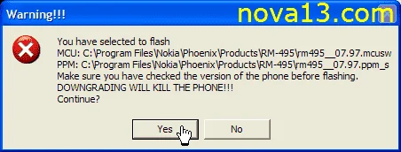

• Now click FLASH, the dialog box that appears click Yes.

Read Each command / News in the box, when instructed "PRESS ON PHONE" then press the POWERbutton, APPROXIMATELY 2 seconds until a voice that indicates there is HARDWARE IN
