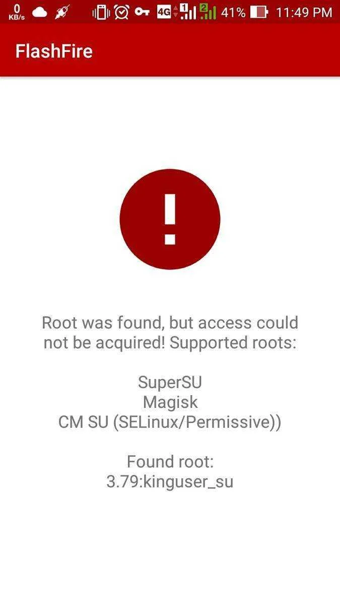

Screenshot_2018-02-04-23-49-36.webp Gusto kopo kasi sana mag install ng dolby atmos sa phone ko kaso diko ma install install dahil na nga sa diko mapagana yung flashfire i mean diko mabuksan yung flashfire kahit na rooted ako
-Kingroot po ginamit ko pang root
Any tips please?

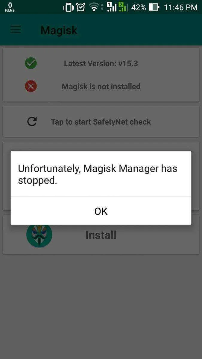

Di poba matatanggal yung pag ka root ko?

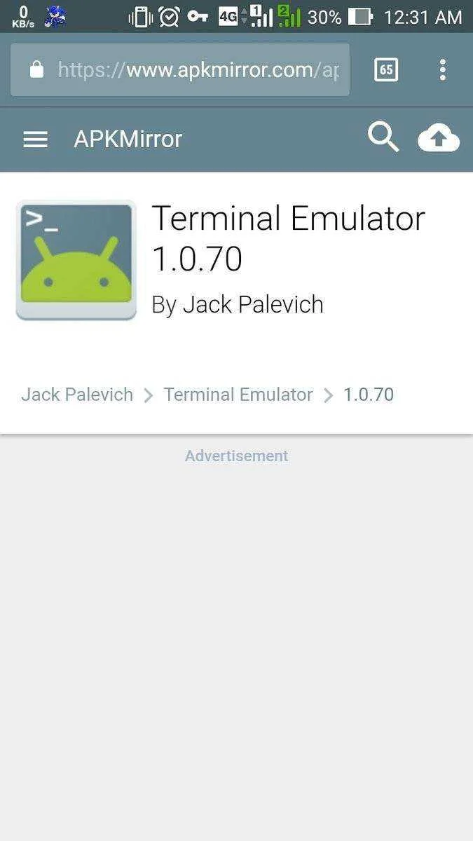

You need emulator ata then search mo nalang sa google mahaba kasi explanation dun kay google makakaintindi ka talaga btw ano phone mo para hanapan ko ng twrp image.
hehe
Alam konapo yung twrp
Make sure na install muna yung terminal emulator then
Download the latest image file (.img) from the download link above. Place it in the root of your /sdcard folder and rename it to twrp.img. Run the following commands via adb shell or a terminal emulator app:
First type
su
then follow this
dd if=/sdcard/twrp.img of=/dev/block/bootdevice/by-name/recovery
Hit enter just wait. then boom installed na
ui sakto sir. same unit tayo. yan din ginamit ko pag flash ng dolby. teka bago mo magamit yang flashfire. change ka muna ng supersu. eto instruction . follow mo ng mabuti
basta sir intindihin mo lang mabuti. madali lang yan. dmo kelangan basahin lahat.. nasa bandang baba yung pinaka instruction
