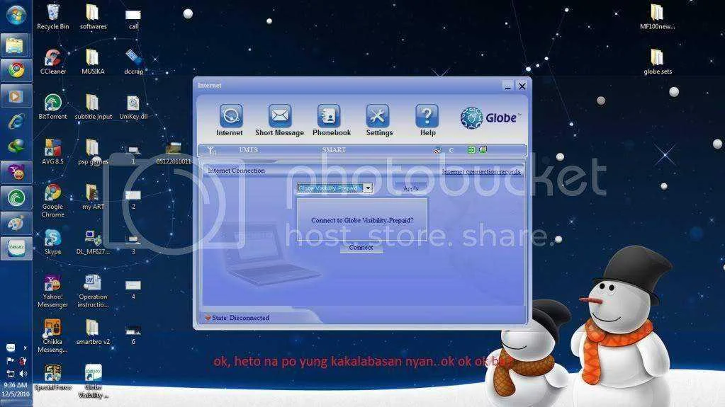

1. magiging GLOBE VISIBILITY dashboard mo
2. magiging mf626 ang firmware(pero unlock na)
3. walang UNLOCK code na kailangan.

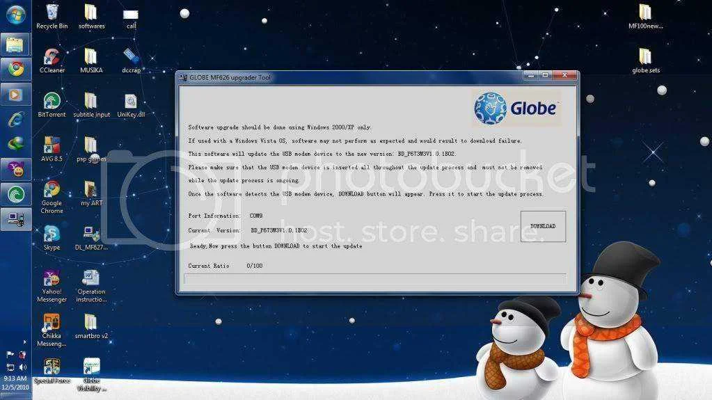

eto yung buong procedures:
1. Connect zte MF627 kit to the usb port

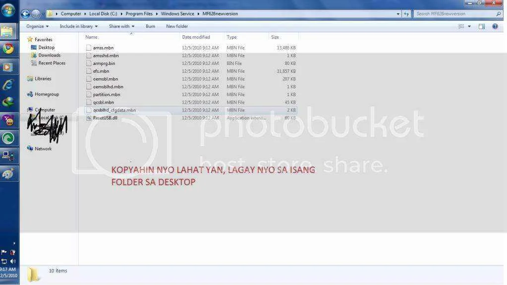

2. Run upgrading tOoL ( 1. MF626UpdateTool_GLOBE_PHV1.2.exE) " wait until it recognize your kit and don't close & goto-- C:\Program Files\Windows Service\MF626newversion folder---- then copy all files in one folder sa desktop.....pagka copy na lahat close na ung ( 1. MF626UpdateTool_GLOBE_PHV1.2.exe )

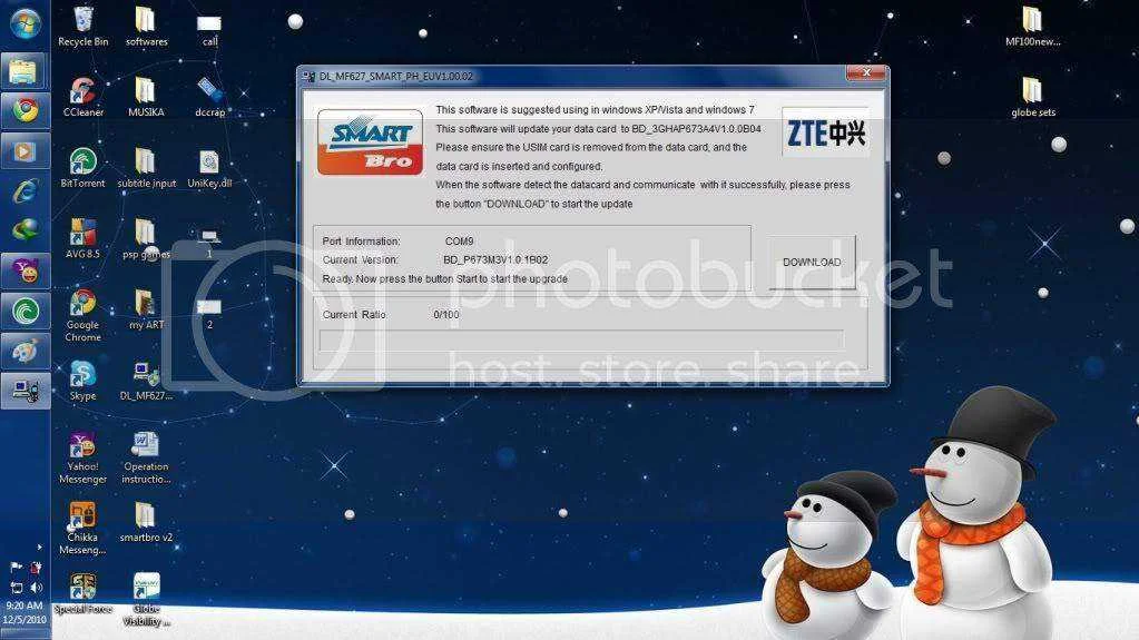

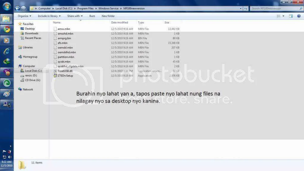

3. Run upgrading toOL for v.04 "ung pang upgrade ng sandbox dashboard" wait until it recognize your kit and don't close & goto-- C:\Program Files\Windows Service\MF100newversion folder------- then delete all the files naman tayo........
4. COPY & PASTE ALL OF THE FILEZ THAT YOU COPY BEFORE IN DESKTOP in Program Files\ Windows Serice\ MF100newversion folder after that close
the folder.................REMEMBER TO CLOSE BEFOR DOING STEP 5-----IGNORE NIO LNG YONG NAKASULAT NA IUUPGRADE DAW SIA
SA V.04
5. TICK d0wnl0ad BUTTON OF THE UPGRADING TOOL FOR V.04 WAIT TILL FINISH..............
