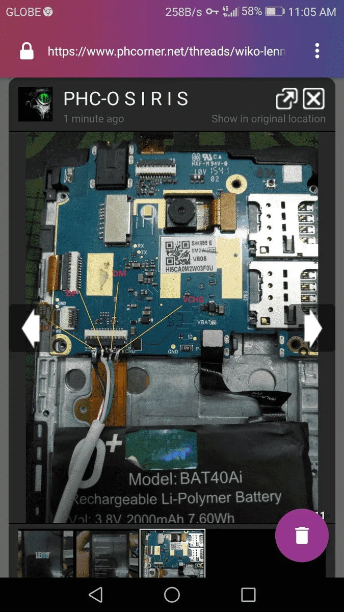

In case of deadboot you need to do a jtag sir shorting of pin para mapaboot mo yung unit mo then use the tool to flash

jtag or shorting of pin is using jumper in our connecter or inside the phone para maflash po naten siya dahil corrupted po si preloader naten
Hindi na po nag oon pero all hardware may power and working pero no detection po .
my85dtv po model ng phone nyo .
ito po ba sinasabi nyung jtag?

natry mo na ba with battery and without battery ?
nainstall mo ba yung required driver ?
try to hold volume down and up while inserting the usb connector with and without battery
