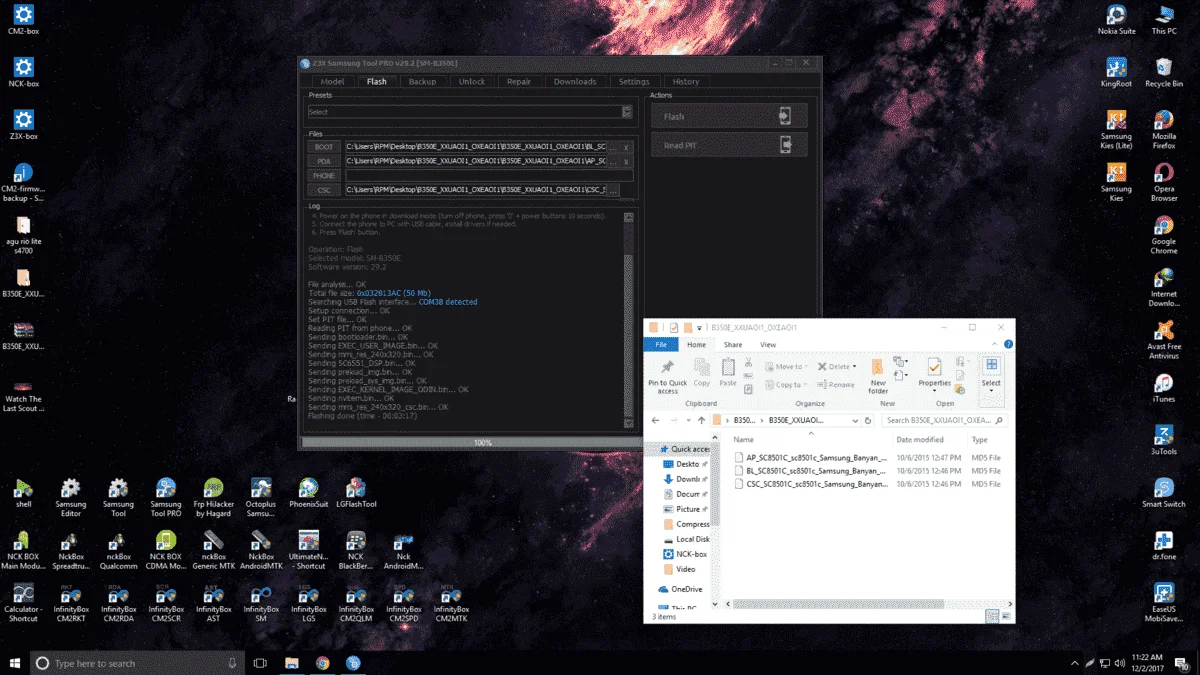

Samsung Metro (sm-b350e)
Unlock via Z3X
Code:
  FLASH INSTRUCTIONS:
  1. Choose correct flash file(s).
  2. If you have PIT file chosen, then you must check 'Repartition' option.
  3. Check flashing options if needed (Repartition, EFS clear, Boot update).
  4. Power on the phone in download mode (turn off phone, press '0' + power buttons 10 seconds).
  5. Connect the phone to PC with USB cable, install drivers if needed.
  6. Press 'Flash' button.
Operation: Flash
Selected model: SM-B350E
Software version: 29.2
File analysis... OK
Total file size: 0x032813AC (50 Mb)
Searching USB Flash interface... COM38 detected
Setup connection... OK
Set PIT file... OK
Reading PIT from phone... OK
Sending bootloader.bin... OK
Sending EXEC_USER_IMAGE.bin... OK
Sending mmi_res_240x320.bin... OK
Sending SC6551_DSP.bin... OK
Sending preload_img.bin... OK
Sending preload_sys_img.bin... OK
Sending EXEC_KERNEL_IMAGE_ODIN.bin... OK
Sending nvitem.bin... OK
Sending mmi_res_240x320_csc.bin... OK
Flashing done (time - 00:03:17)
Done with Samsung Tool PRO v.29.2

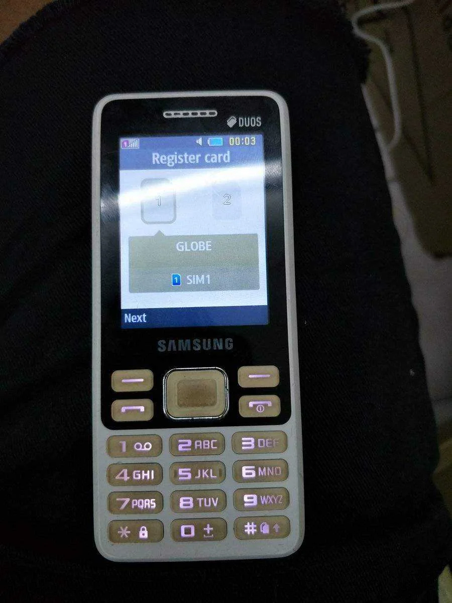

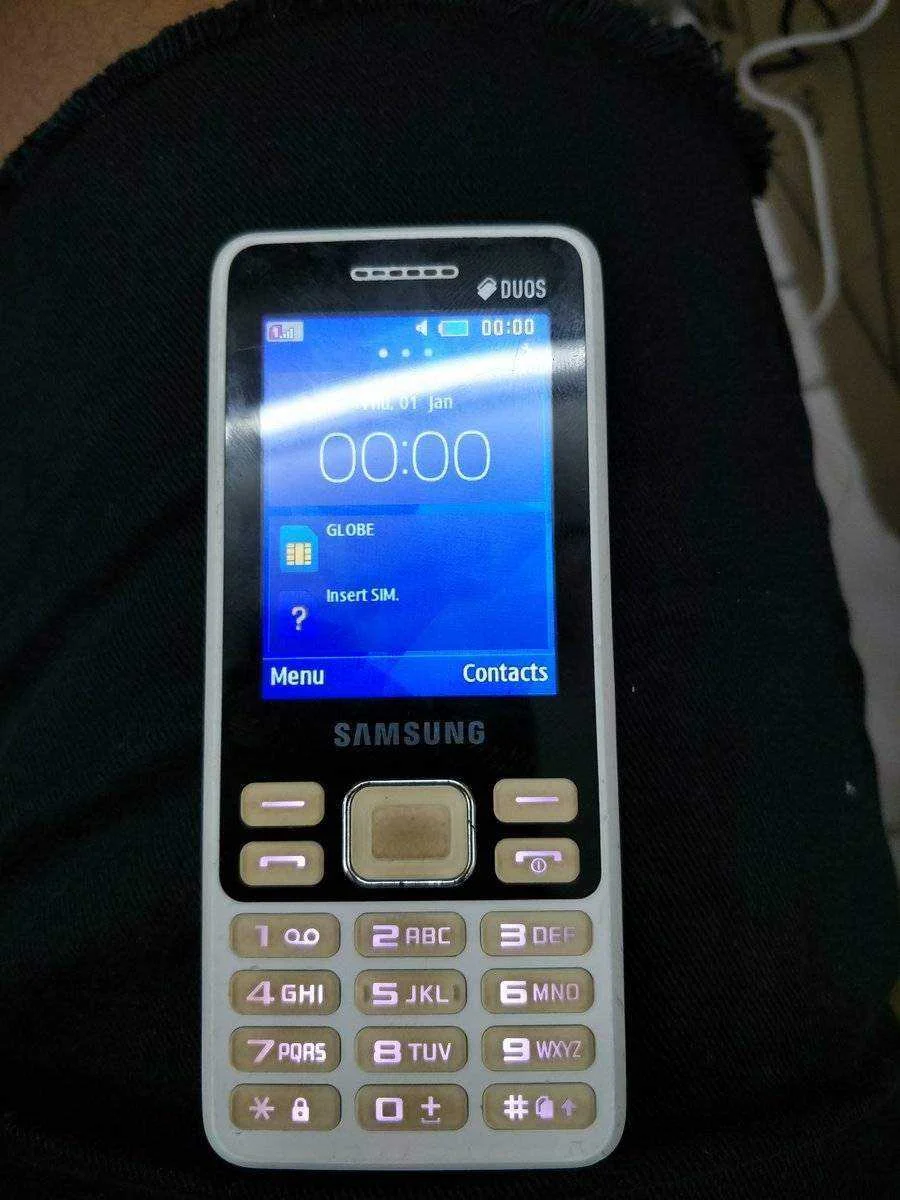

Phone SS

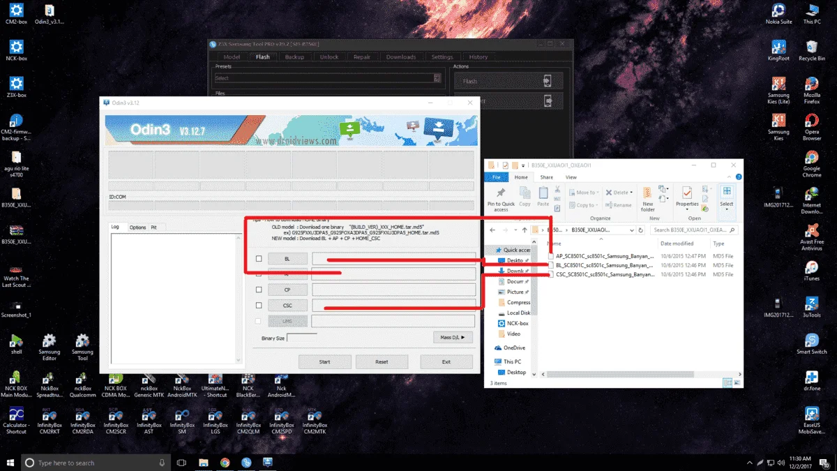

Puwede din po sa odin flashertool paki try na lang po.
Sa mag tatanong kung bakit via flashing firmware ang ginawa ko ito po sagot ko.
pag read code sa Z3X ang ginawa puro not active lang.
at kung unlock sa Z3X success ang lumalabas pero hindi parin openline.
kaya via flashing na lang at openline na firmware ang ginamit ko.

Samsung Metro Firmware & Odin FlasherTool:)
Sana makatulong sainyo:)
