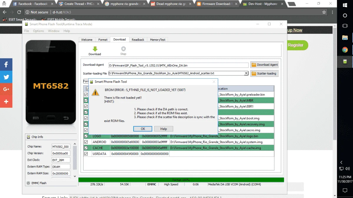

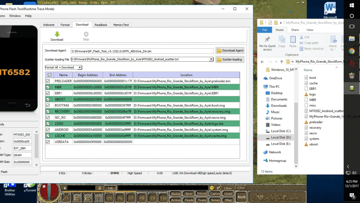

Z zhack01 Journeyman Nov 30, 2017 #1 Need help kahit ano gawin ko ganyan parin, nasa isang folder namn lahat

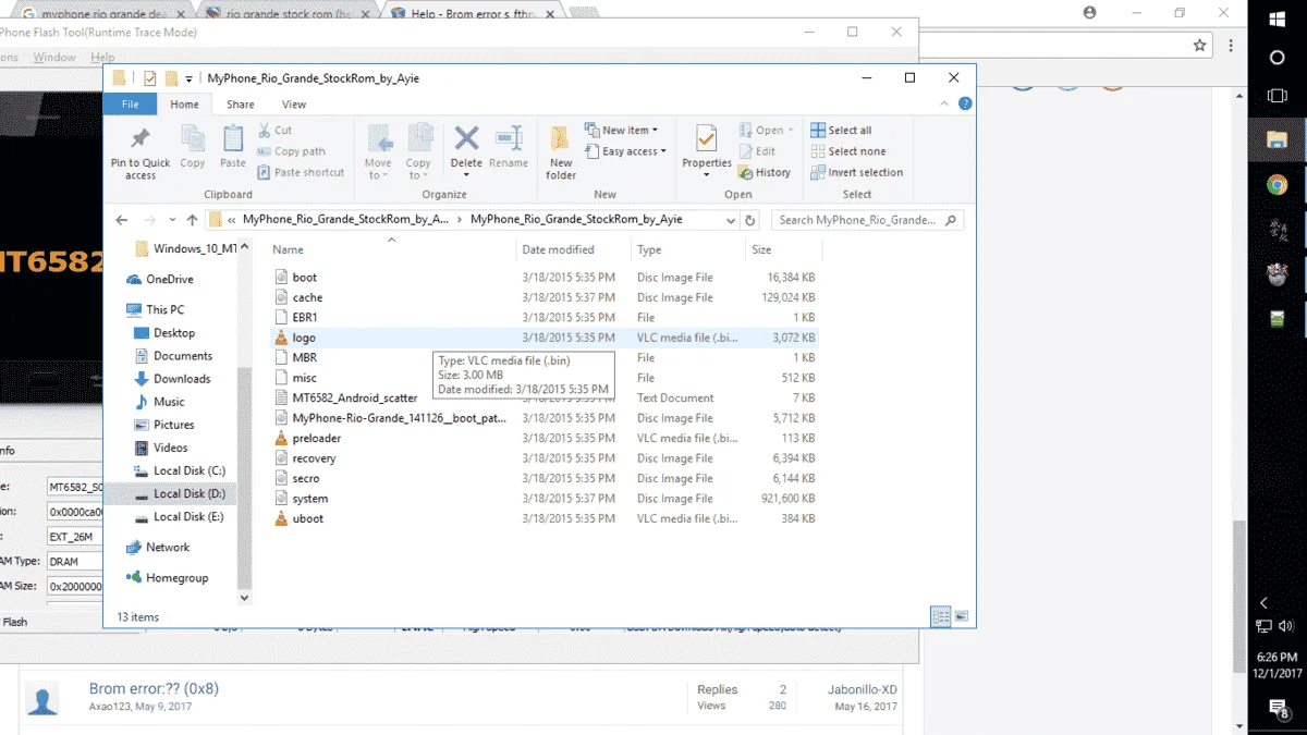

S Shinsuke Nishizono Wimpy Kid Nov 30, 2017 #2 Wala kasi isang .img sa scatter loading mo. I uncheck mo na lang kung walang file pero kung meron. Browse mi na lang with the same filename.
T t3chb4n147 Journeyman Nov 30, 2017 #3 screen shor mu ulit tanggalin mu ung error para makita kung anung kulang

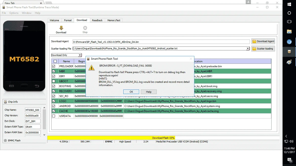

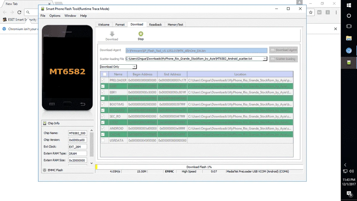

C ced17 Forum Veteran Dec 1, 2017 #6 Tingin ko wala ka user data boss try mo magdl ng new firmware yung complete anung model pala yan try mo iunchecked yung user data then flash mo after nun wipe data mo using power button volume up or down
TS TS Z zhack01 Journeyman Dec 1, 2017 #7 eto po ng yari san po kaya ako makakuha ng bagong firmware or stockrom ng myphone rio grande Attachments Untitled.webp 86.5 KB · Views: 23 Untitled1.webp 83.7 KB · Views: 27
C ced17 Forum Veteran Dec 2, 2017 #8 gamit ka po ibang connector mas ok yung sa samsung download ka new firmware jan sa text Attachments Myphoneaguario.txt Myphoneaguario.txt 43 bytes · Views: 32
