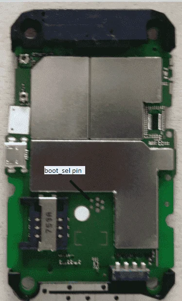

4. Find the loading point of the board (BOOT_SEL, it will be indicated in the general maintenance manual). Short the ground to the ground with tweezers or other tools. Connect the data card to the computer through the USB extension cable until the port below appears Release the tweezers.

no need nang net boss kasi included na yung drivers pag na download mo yung files sa first page.. install mo lang yung drivers.. pero ang importante ang bootshot para ma install yung pc interface na drivers..

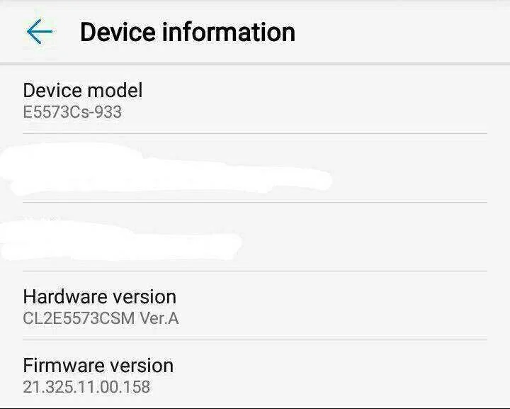

yelnam2manley boss na try mo na ibang firmware? parang di kumpleto yung device info sa universal firmware at naka exclusive naman yung general firmware sa easy-firmware sa download site.
oh... so possible lahat na nandoon ay universal or non-specific/general firmware lang. wala pa akong nakikitang custom na webui doon. saka yung cd installer paano kaya ulit yun makikita ulit boss yelnam2manley

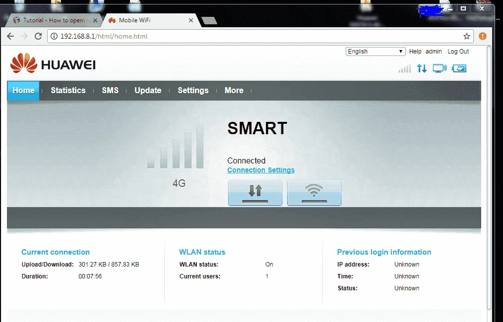

Bat ganon lahat ng nakikita KO na nakapag unlock eh walang signal smart?
