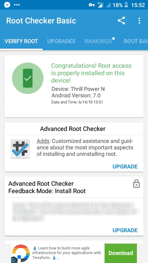

After months of searching, I was finally able to root my Cloudfone Thrill Power N with Magisk systemless root.
Proof:
I'm on mobile right now, but as soon as I'm at my laptop, I'll make some posts for the firmware I got, as well as guides for installing Magisk and getting root. Also, I'm currently still working on trying to get a custom recovery like TWRP for this phone, and I'll post that when I have it. I'm still on stock recovery, for now.

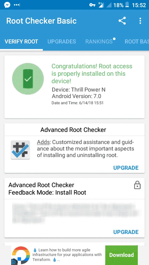

Proof:
Nice!! I've been waiting for that, update mo kmi sir ! Thank you

Thanks sir paupdate naman po if nakapost ka na haha need lang talaga maroot thrill power n ko haha salamat po
Sorry for the delay. I was trying to get a custom recovery working on this phone, but the auto-tools I used to try and build TWRP didn't work (and sent me into a bootloop). Looks like the recovery partition size on this phone is rather limited, so I might need to manually compile TWRP to try and get it under 9MB in size.
Anyway, the rooting guide is now up: https://phcorner.org/threads/562405/ You don't need a custom recovery to root. :)
