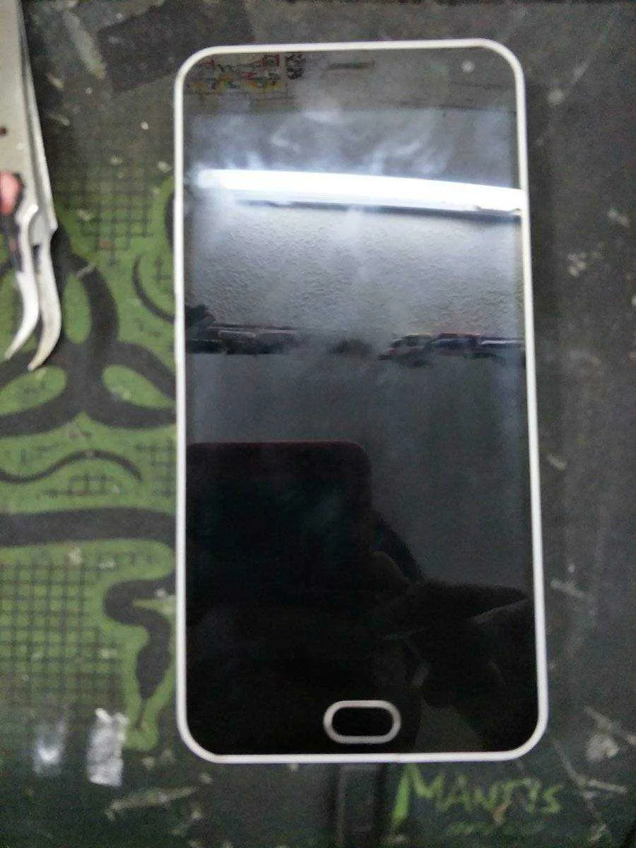

Problem: Hang Logo
Solution: Flashing

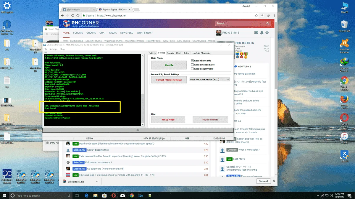

bago po ako nag try sa flashing nag try muna ako sa update.zip pero palaging corupted ang files kaya di puwede sa update.zip.
Try ako sa CM2 flasher tool.
Read info:
Code:
Operation : Check / Read Info [ v1.58 ]
1. Power Off Phone , Remove battery , Insert back
2. Insert USB cable. In some cases require hold BootKey
Wait for phone...
Phone found! [ 6 ]
Sync...
Inital Boot Ok!
BB_CPU_PID : 6735
BB_CPU_NME : [MediaTek] MT6735_S00
BB_CPU_EXT : 0xCA00 , 0x8A00 , 0x0000
Processing BROM stage
Settings for BROM configured!
SecCfgVal : 0x00000000
BromVer   : 0x00FF
BLVersion : 0x0001
PreLoader : Active [ Boot with PL ]
BootLdrSS : NORMAL with PRELOADER
Processing DA stage
DA Select done, will use MTK_AllInOne_DA_v5.1624.16.07
Sending and initialize DA ...
[DA_ERROR] : SECURITYBOOT_BOOT_NOT_ACCEPTED
Boot Error!
Operation Failed
Elapsed: 00:00:06
Reconnect Power/Cable!

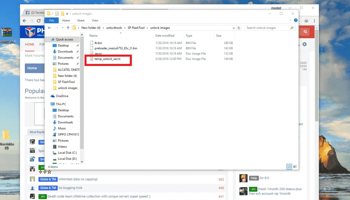

Kung makikita niyo sa pic naka secureboot ibig sabihin hindi unlock ang bootrloader hindi ma iflaflash kailangan iunlock kasi mag eerror pag pinilit.
Ito po ginamit ko na pang unlock ng bootloader You do not have permission to view the full content of this post. Log in or register now. kasama na jan ang flasher tool.

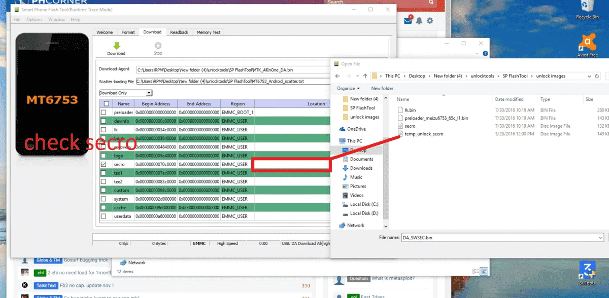

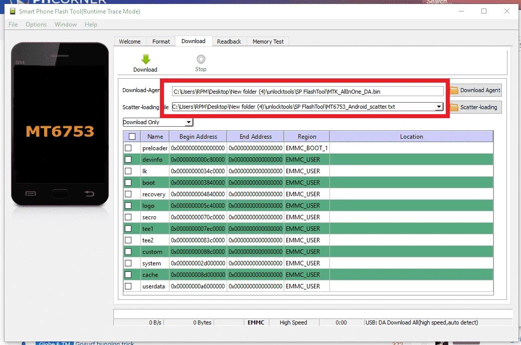

ganito naman ang pag setup sa flashertool para ma-unlock ang bootloader gayahin lang ang paka setup ng Download Agent at Scatter.

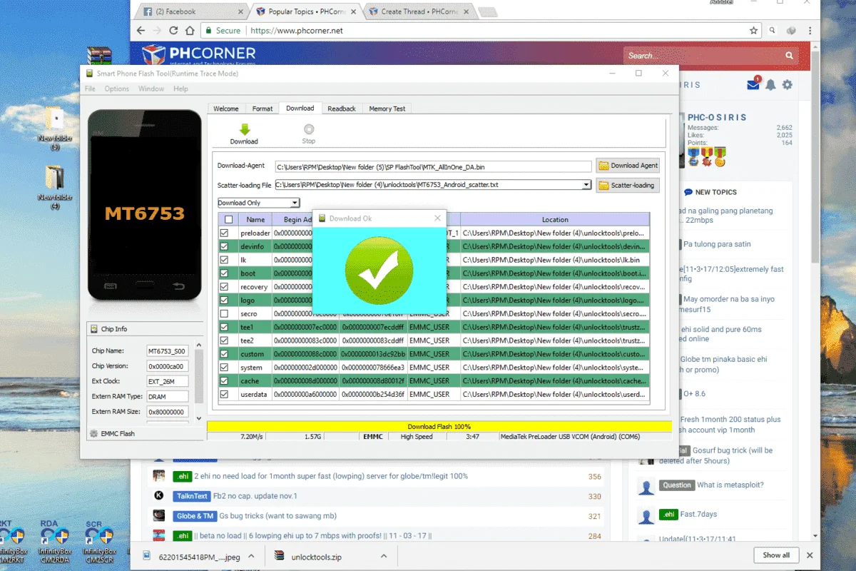

Pag ok na hit download then insert usb cable and hold volume down.
Para naman sa Stock Firmware Flashing alam na gagawin.
Para naman sa Firmware You do not have permission to view the full content of this post. Log in or register now.
Uncheck niyo ang secro pag Firmware na ang iflaflash:)
Done:)

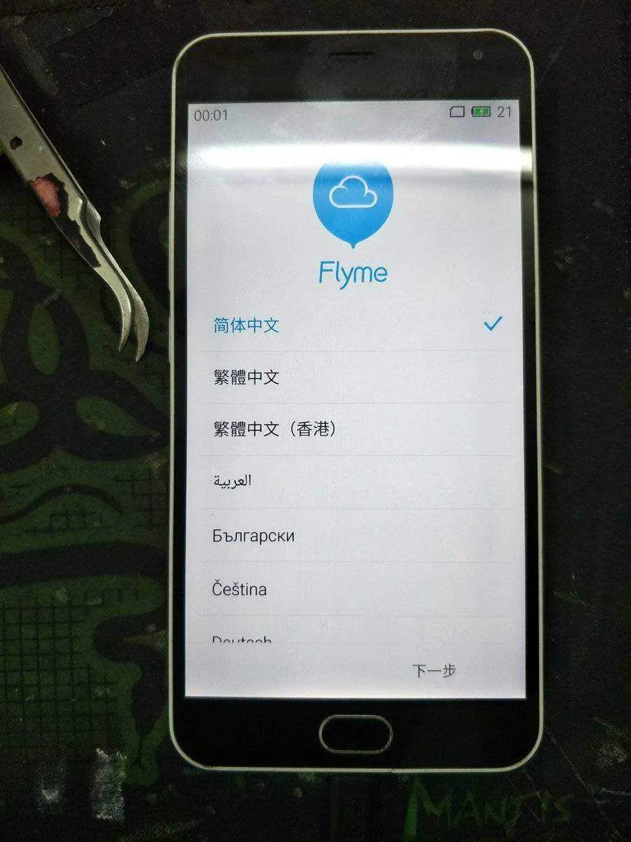

Phone SS after flash
Alam na gagawin kung pano mag setup:)
