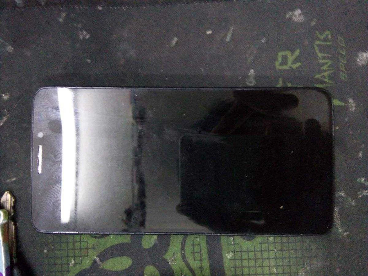

ALCATEL ONETOUCH IDOL X+
Problem: Deadboot
Solution: Flashing

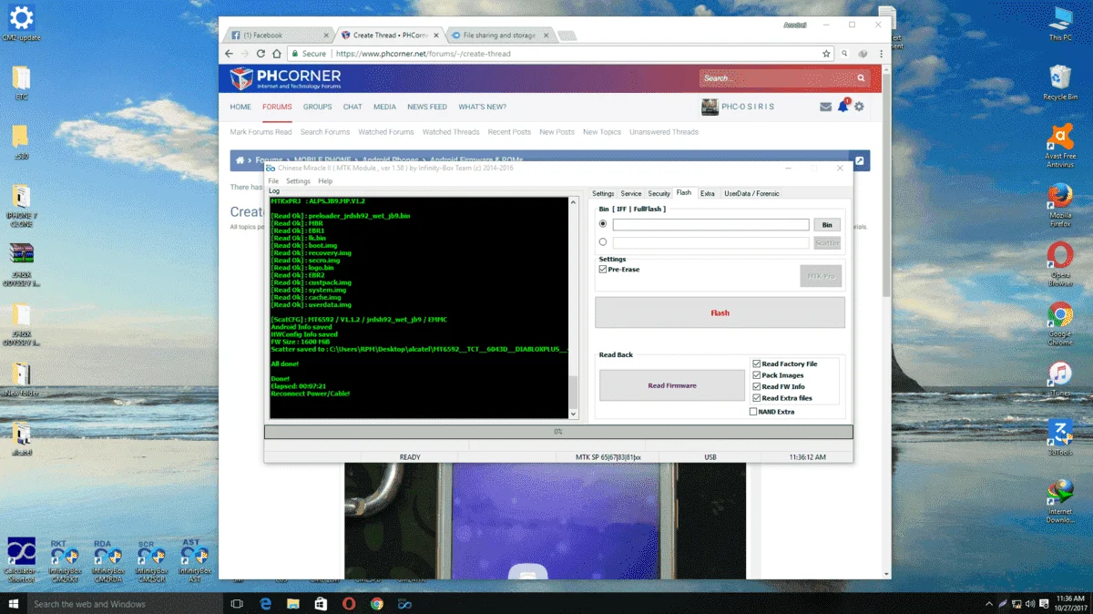

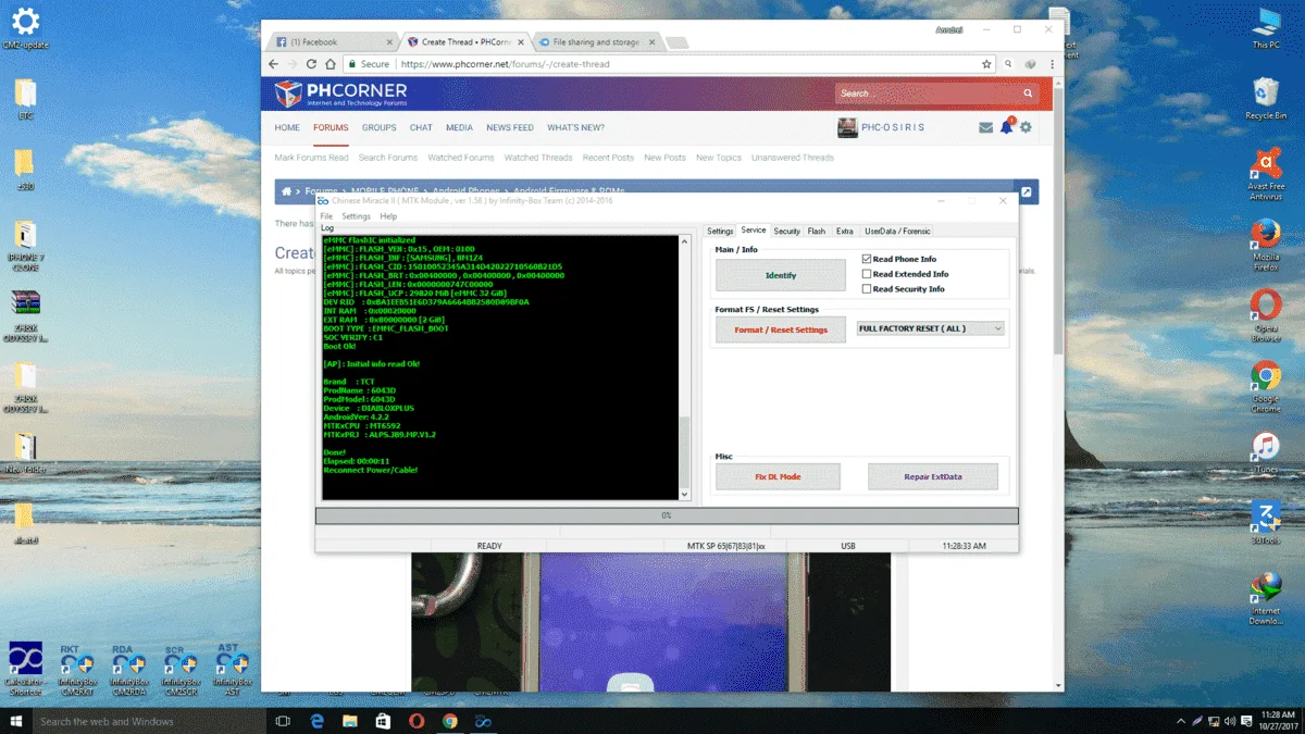

Try ko ibackup yung stock firmware kahit deadboot.
CM2
Info:
Code:
[AP] : Initial info read Ok!
Brand     : TCT
ProdName  : 6043D
ProdModel : 6043D
Device    : DIABLOXPLUS
AndroidVer: 4.2.2
MTKxCPU   : MT6592
MTKxPRJ   : ALPS.JB9.MP.V1.2
Read Firmware:
Code:
Reading Flash Content now ...
Brand     : TCT
ProdName  : 6043D
ProdModel : 6043D
AndroidVer: 4.2.2
MTKxCPU   : MT6592
[Read Ok] : preloader_jrdsh92_wet_jb9.bin
[Read Ok] : MBR
[Read Ok] : EBR1
[Read Ok] : lk.bin
[Read Ok] : boot.img
[Read Ok] : recovery.img
[Read Ok] : secro.img
[Read Ok] : logo.bin
[Read Ok] : EBR2
[Read Ok] : custpack.img
[Read Ok] : system.img
[Read Ok] : cache.img
[Read Ok] : userdata.img
[ScatCFG] : MT6592 / V1.1.2 / jrdsh92_wet_jb9 / EMMC
Android Info saved
HWConfig Info saved
FW Size : 1600 MiB
Scatter saved to : C:\Users\RPM\Desktop\alcatel\MT6592__TCT__6043D__DIABLOXPLUS__4.2.2__ALPS.JB9.MP.V1.2\
All done!
Done!
Elapsed: 00:07:21
Reconnect Power/Cable!

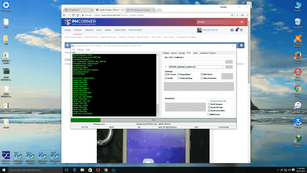

Reflash Stock Firmware:
Code:
Operation : Flash [ v1.58 ]
======= Flash
1. Power Off Phone , Remove battery , Insert back
2. Insert USB cable. In some cases require hold BootKey
Wait for phone...
Phone found! [ 6 ]
Sync...
Inital Boot Ok!
BB_CPU_PID : 6592
BB_CPU_NME : [MediaTek] MT6592_S00
BB_CPU_EXT : 0xCA00 , 0x8A00 , 0x0000
Processing BROM stage
Settings for BROM configured!
SecCfgVal : 0x00000000
BromVer   : 0x00FF
BLVersion : 0x0001
PreLoader : Active [ Boot with PL ]
BootLdrSS : NORMAL with PRELOADER
Processing DA stage
DA Select done, will use MTK_AllInOne_DA_v5.1624.16.07
Sending and initialize DA ...
Running DA ver.4.2 on BBID : 0x8A
NAND Flash : NOT INSTALLED
eMMC Flash : 15010052345A314D42022710560B21D5
Initialize Memory ...
DRAM already initialized by Preloader
DAgent sent , init HW now
eMMC FlashIC initialized
[eMMC] : FLASH_VEN : 0x15 , OEM : 0100
[eMMC] : FLASH_INF : [SAMSUNG] , BM1Z4
[eMMC] : FLASH_CID : 15010052345A314D42022710560B21D5
[eMMC] : FLASH_BRT : 0x00400000 , 0x00400000 , 0x00400000
[eMMC] : FLASH_LEN : 0x0000000747C00000
[eMMC] : FLASH_UCP : 29820 MiB [eMMC 32 GiB]
DEV RID    : 0xBA1EEB51E6D379A6664BB2580D89BF0A
INT RAM    : 0x00020000
EXT RAM    : 0x80000000 [2 GiB]
BOOT TYPE  : EMMC_FLASH_BOOT
SOC VERIFY : C1
Boot Ok!
ScatCFG : BaseBand : MT6592 , Project : jrdsh92_wet_jb9 , Storage : EMMC
Setting : Flash Pre-Erase (Safe) : Enabled
Setting : AFF verify :  Enabled
Setting : HW verify :  Enabled
BL : Check HW compatibility
BL : BBID supported by BootLoader!
BL : Check eMMC compatibility
BL : eMMC supported by BootLoader!
BL : BatteryLevel : 3614 mV
BL : BatteryLevel Ok
BL : Flash Pre-Erase
Total blocks to Erase : 3
Erase : 0x0000000000000000-0x0000000000100000
Erase : 0x0000000001D00000-0x00000000357A0000
Erase : 0x0000000037CA0000-0x000000070BF60000
Flash Pre-Erase Done, time used : 00:00:10
SecCfg Passed , 1799
BMT remark not need. Will skip
Sending Preloader ...
Use : preloader_jrdsh92_wet_jb9.bin
Preloader Sent , Init passed
PartCount : 0016
Update PMT by user request
Repartition Done!
Use FLN Mode
Processing : Flash Write
Flash now : MBR
Image Flash Ok
Flash now : EBR1
Image Flash Ok
Flash now : UBOOT
Image Flash Ok
Flash now : BOOTIMG
Image Flash Ok
Flash now : RECOVERY
Image Flash Ok
Flash now : SEC_RO
Image Flash Ok
Flash now : LOGO
Image Flash Ok
Flash now : EBR2
Image Flash Ok
Flash now : CUSTPACK
Image Flash Ok
Flash now : ANDROID
Image Flash Ok
Flash now : CACHE
Image Flash Ok
Flash now : USRDATA
Image Flash Ok
Flash Write Done, time used : 00:04:13
Processing : Verify
Verify Passed : MBR
Verify Passed : EBR1
Verify Passed : UBOOT
Verify Passed : BOOTIMG
Verify Passed : RECOVERY
Verify Passed : SEC_RO
Verify Passed : LOGO
Verify Passed : EBR2
Verify Passed : CUSTPACK
Verify Passed : ANDROID
Verify Passed : CACHE
Verify Passed : USRDATA
Data Verify Done, time used : 00:00:28
Update Mirror PMT
Update Done!
Update RomInfo done
Done!
Elapsed: 00:05:08
Done:)

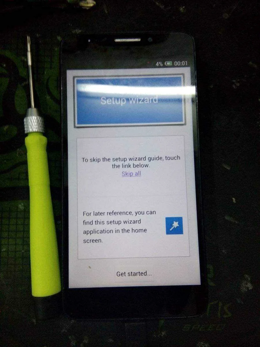

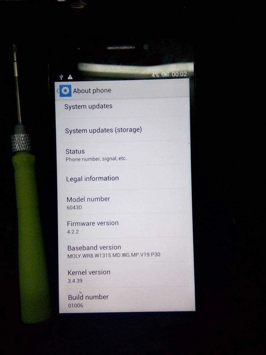

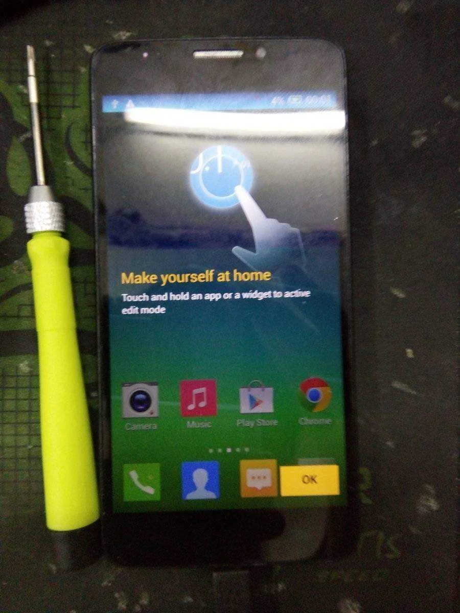

Phone SS after Flash:
Alcatel Onetouch Idol X+ You do not have permission to view the full content of this post. Log in or register now.
