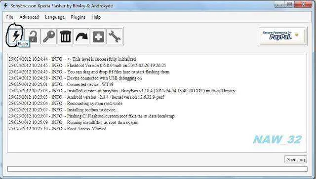

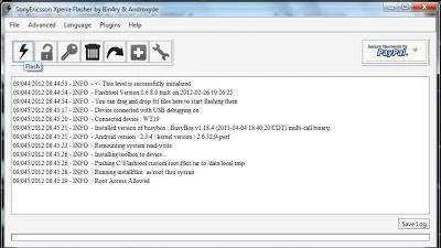

2. Open flashtool.exe. Connect live with walkman to PC via usb cable. don't forget to connect device with USB DEBUGGING ON(go to settings and tap Application-->development).

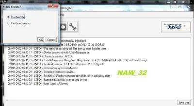

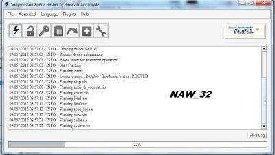

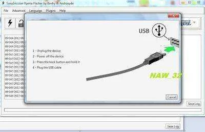

3. Click FLASH and choose flashhmode on mode selector:

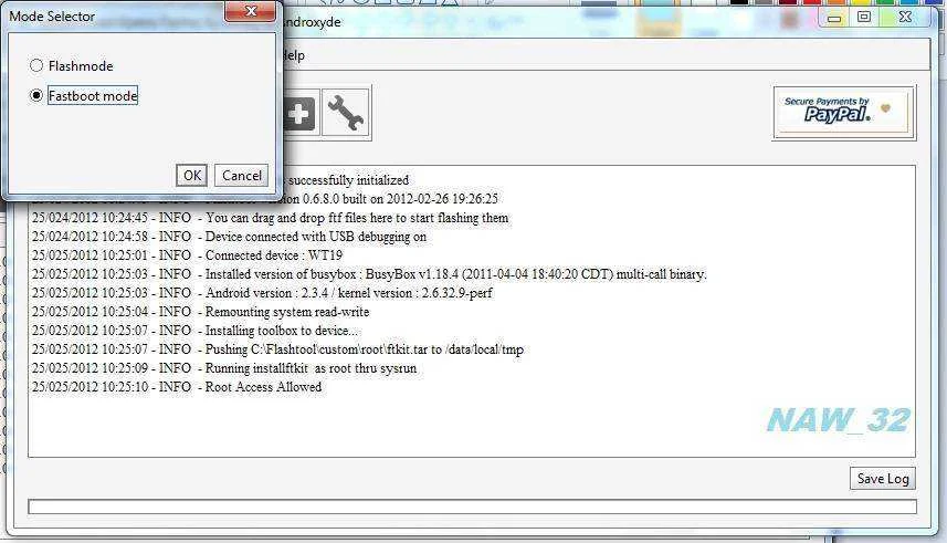

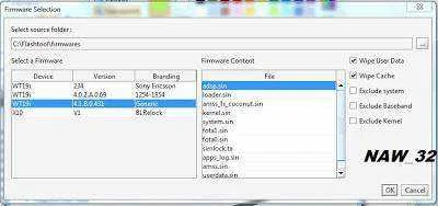

4. now choose the firmware then click ok:
5. Enter the flashmode. unplug the usb cable, turn off your phone. press and hold volume down button and plug the usb cable. then release the vol down button.
6. wait until the device rebooted. Now you have ICS instaled on live with walkman.

Now flash your device to ICS 4.0.4 with flashtool like flashing tutorial above. but we make little change on setting, uncheck the WIPE USER DATA. (see step 4 when choose firmware).

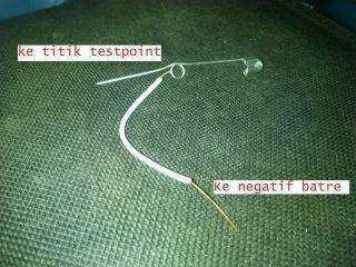

  • cable +/- 5 cm - 8 cm long.
  • pin/needle
  • S1Tool software You do not have permission to view the full content of this post. Log in or register now.

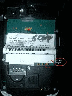

make wire as shown below
the live with walkman test point
the pin/needle to red dot, the other end to negative battery (red circle)

NOW THE MOST IMPORTANT STEP!!!!! WATCH YOUR STEP!! WRONG ATTACHED TEST POINT CAN BROKE YOUR PHONE!!

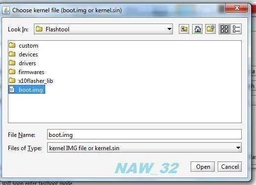

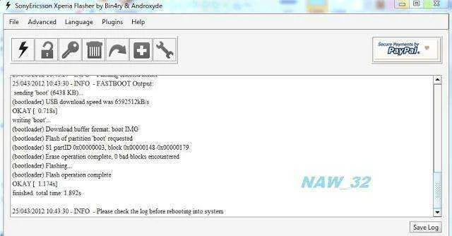

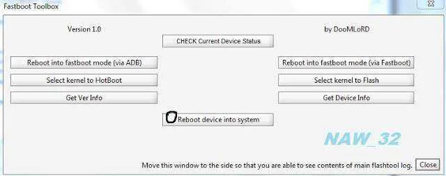

how to install kernel:
Now unzip downloaded kernel, you will get the boot.img, this is the custom kernel. Instal flash tool.
connect your phone with PC via usb cable in 'ON" mode. then open the flashtool..

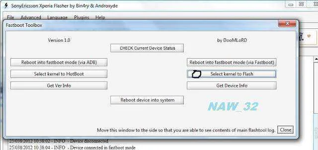

Choose flash like image below:
click on fastboot mode:
click rebot into fastboot mode (via ADB)
the last, reboot device into system

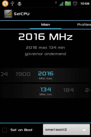

you can use app like "setCPU" for setting CPU Speed. If you are lucky, you can set the cpu speed up to 2.0 GHz.

boss baki ganun 1000mhz lang yung sakin bakit dyan 2000 pani nanyari yun?
upadate po yan pero bago install wait mo na din ung tutorial sa 2ghz nyan kung paano.wait may sinusubukan ako na trick tulad doon sa shout box. ata alam ko itatanung mo iyan mahaba kasi pag lahat lahat ung tut binigay ko. konting pabitin muna.;)
