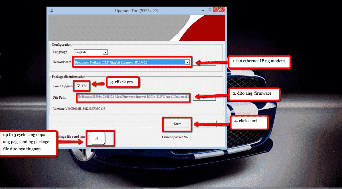

❓ Help Na reset ko yung 931 ko meron ba paraan para ma ka acces ako
procedure..
UNLOCK/DEBRAND PROCEDURE
1. Connect your modem thru lan cable to your pc
2. Turn on your modem
3. I open ang Multicast
4. Before Clicking Start button in the MULTICAST Software, Make sure to turn off the modem first.
5. Click Start Button and turn the modem on, and when the signal bars are full, it means that the UNLOCK MODEM is finished.
6. Click Stop and Close MULTICAST
7. Turn Modem OFF then Turn it ON again (RESTART).
ANG PAG UNLOCK AT ANG PAG DEBRAND AY SAME LANG ANG PROCEDURE PATI NA YUNG PAG UPDATE
Kung na unlock na yung modem mo eh upload mo yung admin config file ni by jhosherx
ayaw nyan pre na try ko na ayaw talaga
nangyari din sa akin ang ganyan nagreset ako pero bumalik naman ang ginawa ko lang nag restart ako ng pc din nagstatic ip pagkatapos hardreset si modem ayon nag okey naman
