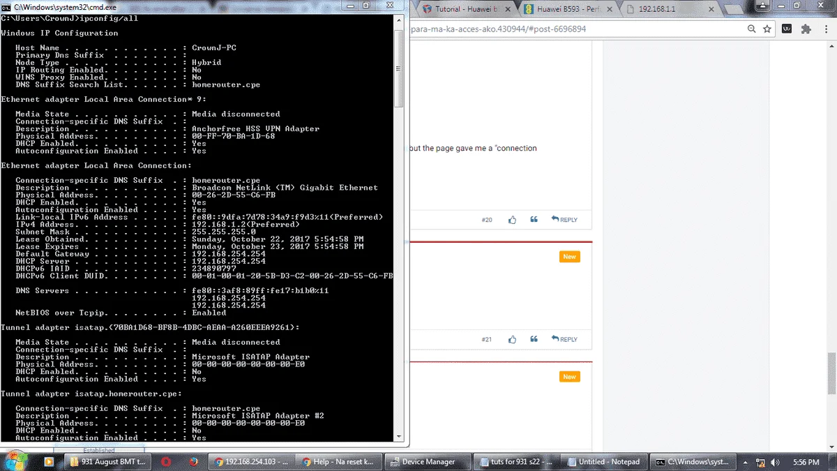

❓ Help Na reset ko yung 931 ko meron ba paraan para ma ka acces ako
mag static ip ka
192.168.254.1
255.255.255.0
yan gawing mong ip..
pag ayaw..
192.168.254.100
255.255.255.0
pag ayaw..
192.168.254.1
250.250.250.0
or
192.168.254.100
250.250.250.0
kaylangan mong mag manual set ng ip
procedure..
