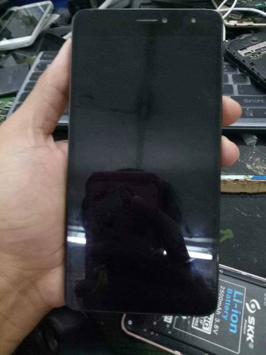

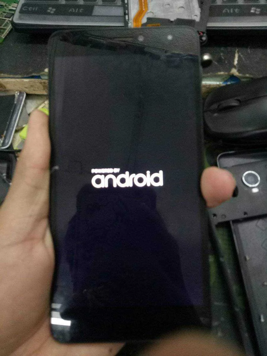

UNIT: Cherry Mobile Flare S5 Max
PROBLEM
: No power/Shorted
ISSUE: Over Charge
Dinala sakin di nag o-on ang unit kaya try ko muna kung detected ba ba ng pc pero ayaw ma detect. kaya try ko sa tester shorted pag binaliktad mo ang polarity ng (+) (-) halos parehas ang palo sa normal na polarity.

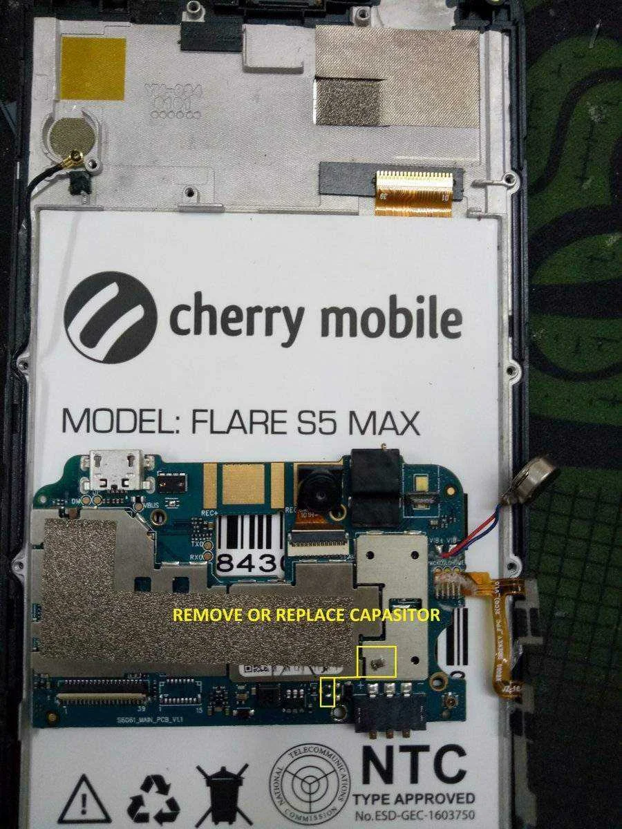

kaya hinanap ko ang pasaway na piyesa at dito ko siya natagpuan:):)
Puwede din alisin at palitan. pero ang ginawa ko pinalitan ko ng bagong capasitor:)
Ito na po siya

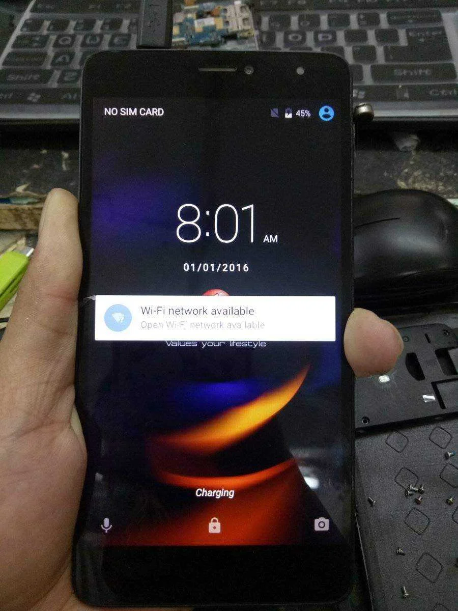

Done:):)

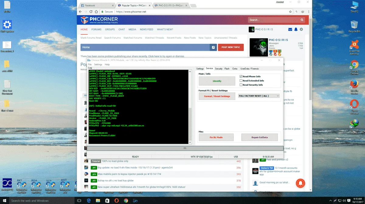

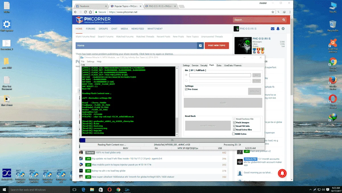

Ito naman po para sa backup.
[AP] : Initial info read Ok!
Brand : Cherry_Mobile
ProdName : FLARE_S5_MAX
ProdModel : FLARE S5 MAX
Device : FLARE_S5_MAX
AndroidVer: 6.0
MTKxCPU : MT6580
MTKxPRJ : alps-mp-m0.mp1-V2.34_wtk6580.we.m
Reading Flash Content now ...
xGPT : Normalize settings Ok!
AndroidVer: 6.0
MTKxCPU : MT6580
[Read Ok] : preloader_s6061_cq_6101h_cherry.bin
[Read Ok] : lk.bin
[Read Ok] : boot.img
[Read Ok] : recovery.img
[Read Ok] : logo.bin
[Read Ok] : secro.img
[Read Ok] : system.img
[Read Ok] : cache.img
[Read Ok] : userdata.img
[ScatCFG] : MT6580 / V1.1.2 / s6061_cq_6101h_cherry / EMMC
Android Info saved
MAUI Meta DB saved
HWConfig Info saved
FW Size : 2154 MiB
Scatter saved to : C:\Users\RPM\Desktop\flare s5 max\MT6580__Cherry_Mobile__FLARE_S5_MAX__FLARE_S5_MAX__6.0__alps-mp-m0.mp1-V2.34_wtk6580.we.m\
All done!
