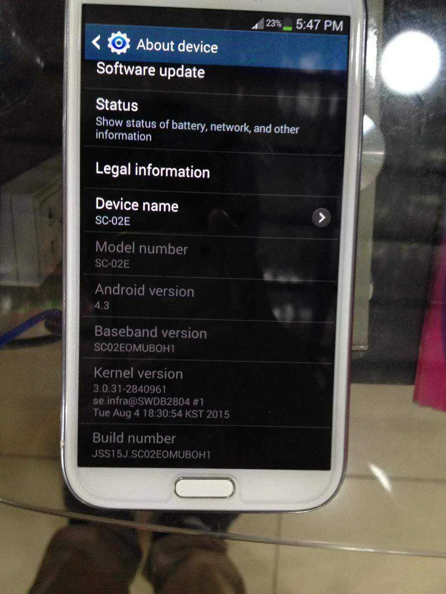

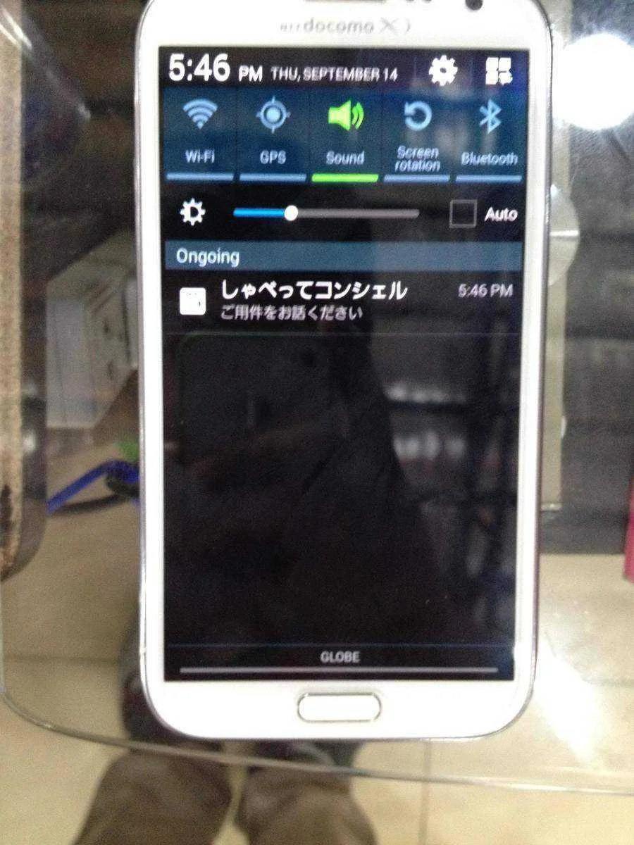

🔒 Closed Sc-02e 4.3 docomo [network unlock done] using z3x samsung tool pro
djdoolky76
Forum Master
share ko lang po

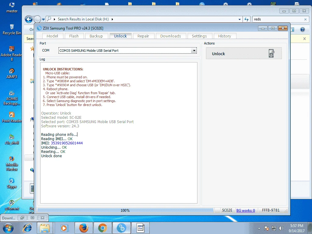

direct unlock sa z3x Samsung tool pro:)
1. Phone must be powered on.
2. Type *#7284# and choose Modem for UART and PDA for USB options.
3. Go to Qualcomm USB settings and select DM+MODEM+ADB
4.
Type *#9090# and select DM/UM over HSIC
5.
Reboot phone.
6. Connect USB cable, install drivers.
7. Select diagnostic port in port settings.
8. Press "Read codes" button.
Thanks for viewing:)
