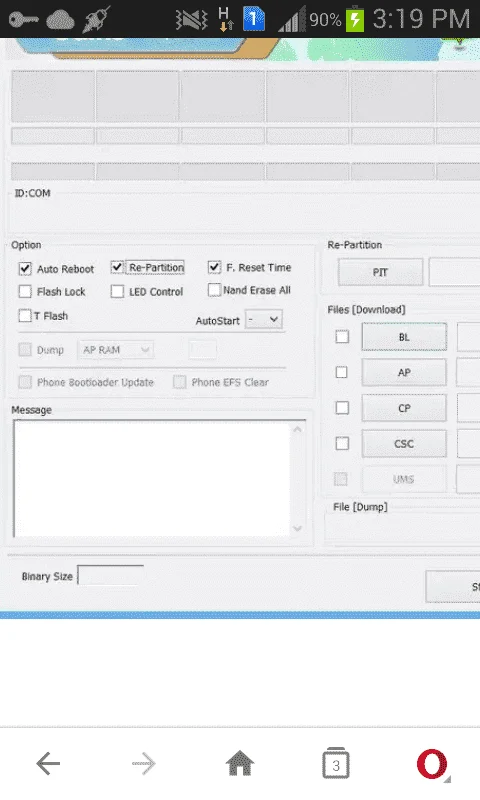

step 1:
"Model ng phone mo + stock ROM"
Pag wala kang mahanap kahit custom ROM pede yan, may ilang features yan na wala sa CP mo...idownload mo .
step 2 :
DOWNLOAD "Odin3"( in your pc)
Step 3 :
Go to "download mode" at your phone".
( its either "power button + vol. Down" or power button + vol. Down + home button[ if home button exist ].
kung di mo mapapunta sa download mode search mo sa youtube.
"Model ng phone mo"download mode.
step 4 :
Connect your phone using usb connector( it goes without saying ...hahaha) to your pc.
step 5 :
After the phone( which is in Download mode is connected).
Youll see options there check it likewise it it shown in the picture.
Sorry hahha na cut..
eto
step 6:
Check and click on AP...hanapin mo yung ROM file na dinownload mo tapos iclick mo.
Then wait...this process will only take a few minutes.
Youll see in your phone or in Odin3 a bar indicating your phones being repair in progress...tadaan do not disconnect while it is in progress.
after it is finished your phone will automatcally reboot.
And thats it...it will only be just like new.
Hope it helps.
pm me if a problem occurs okay ??

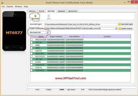

OK bro eto na..
so base sa description mo...( akala ko kasi Soft Bricked lang.)
yung CP mo is Hard Bricked.
actually there were few methods we could use to fix it.
so yung sa taas na post ko is for Soft Bricked Device.
To cut it short...
download your phones ROM.
download Sp flash tool(yeah.. were not using Odin like in the 1st method.)( just search the net.. I dont have a file in my storage..hahaha)
(since your phone isn't opening)
you need a stable USB connector.
so lets start by opening SP flash tool.( see the image for refference.)
you'll see a option there " DOWNLOAD ONLY ".
change it to "format + download".
after that remove your phones battery.insert it again.
click at the top " DOWNLOAD ".( you must first hit the download button before plugging your phone into Pc.)
connect your phone into your pc with you connector.( Sp flash tool will wait for a device to connect. )
it wouldn't actually show in your phones screen but youll see at SP that your download is progressing.
( remember" stable USB Cord okay..)
so just wait for it to finish.
after that your phone will reboot.
your phone nows good as new.
if this doesnt work then you might either have to buy a USBjig.(you can buy it in Internet)
if USbjig doesnt work uhmm.. the last ones pretty expensive so lets just save it if this didnt work.( lets hope it works.)
PM me if theres still some problem.
firmware kelangan mo di ROM.
requirements:
firmware
sp flashtool
usb driver for MTK phone
1st install mo usb driver depende sa windows n gagamotin mo. kung naguguluhan ka. search mo nalang.
usb driver ang importe dahil d babasahin cp mo kung d naka install ang usb driver.
2nd open mo folder spflash tool may application xa dun .then rightclick RUN AS ADMINISTRATOR. then mag oopen na un.lagay mo na ung firmware sa spflshtool .
3rd if your cp removable .remove mo kung hindi plug mo n usb cord mo then press power + vol+ .
4th click format . then w8 matapos. then hit download.
w8 hangang 100%.
ur done bro.
