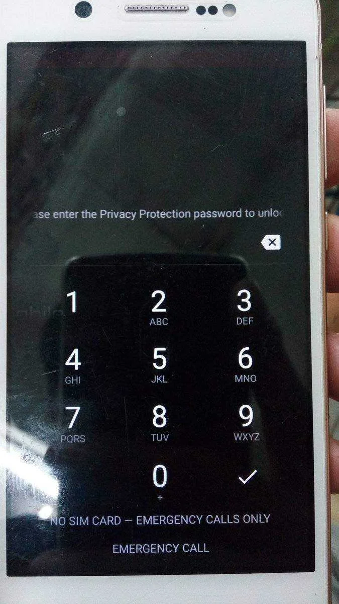

Privacy Protection Password
Privacy Protection Password:)

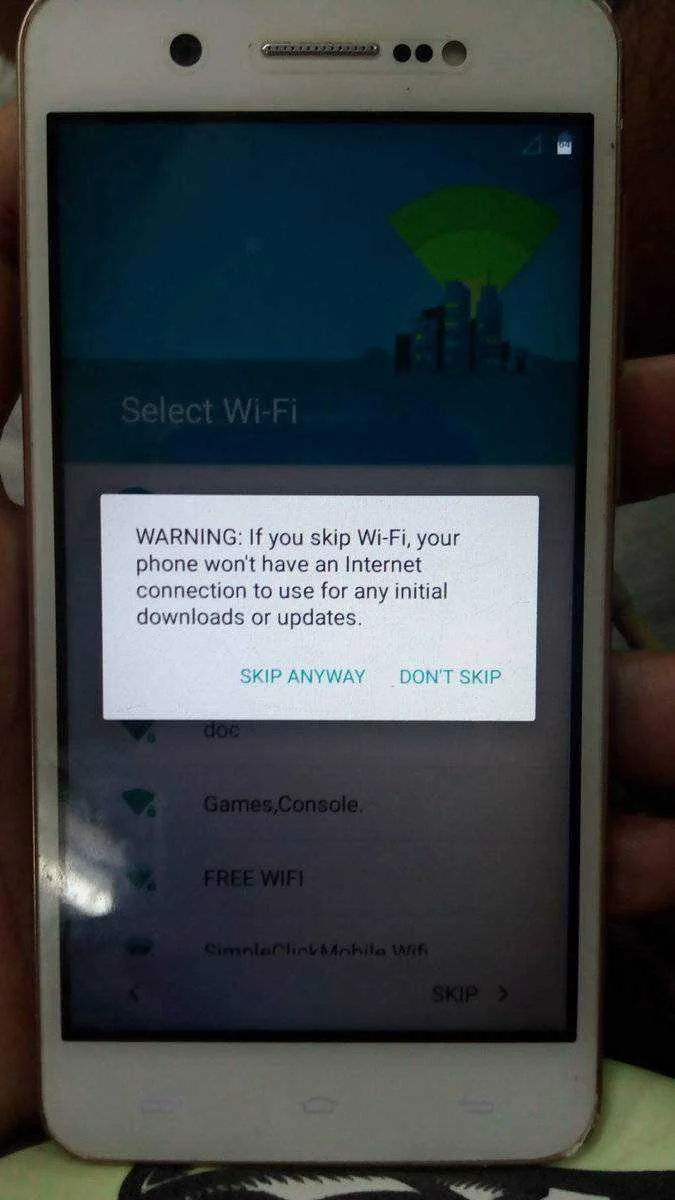

This is a built-in security feature that was added to most Android devices running Android OS 4.3 Jelly Bean to 6.0 Marshmallow. Such devices included Huawei, Samsung, etc. It was designed to eliminate any unauthorized user from accessing and using the device without the required pin. Of course, this security feature would only take effect if it was enabled.
Yan po yung sticky password na kahit ilang hard reset na ginawa mo nadiyan parin:)

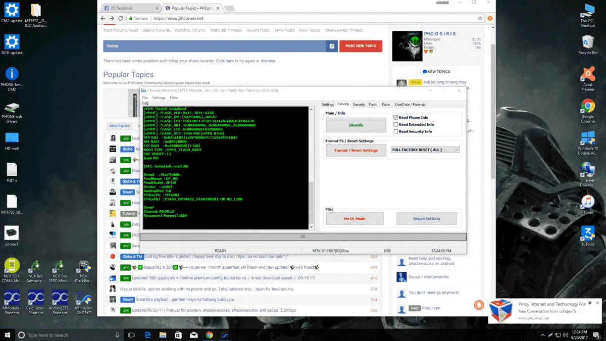

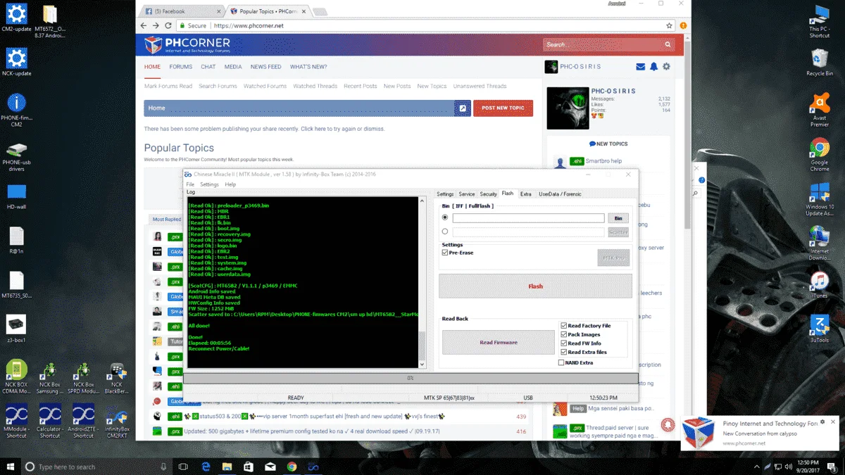

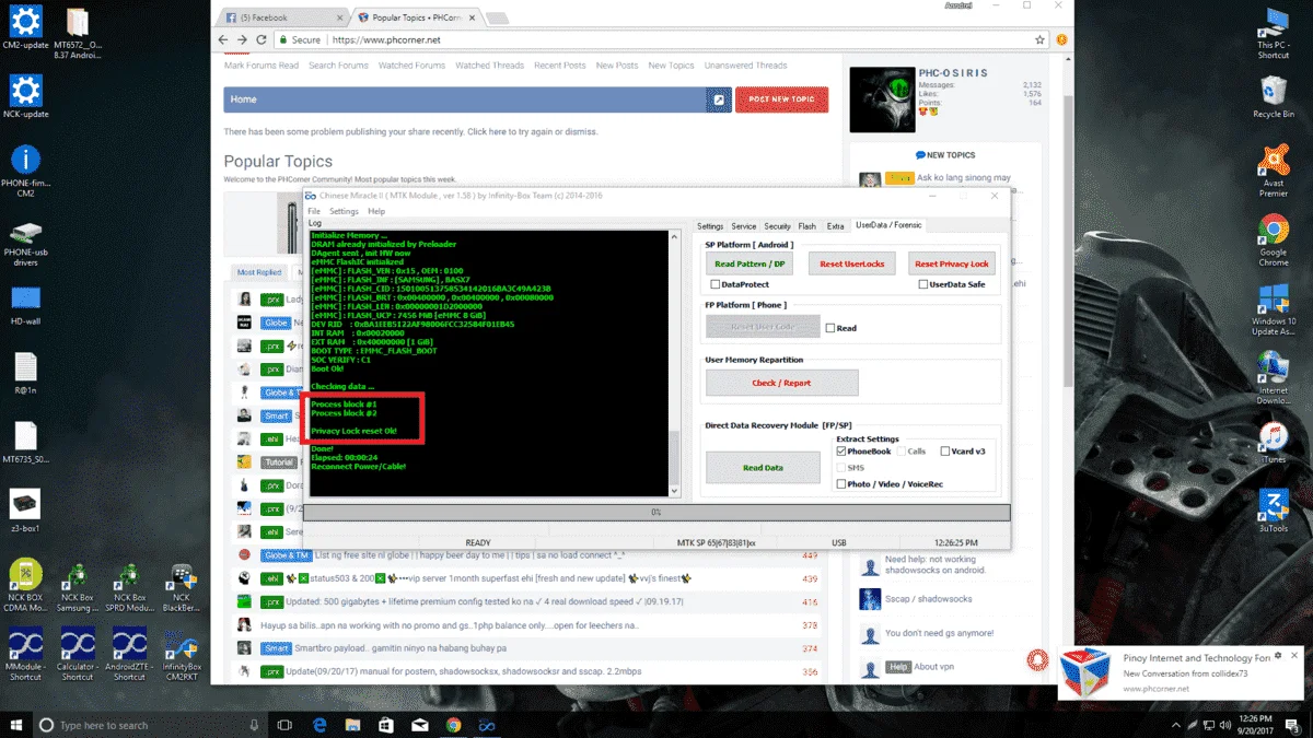

Reset Privacy lock via CM2
CM2 MTK
Reset Privacy Lock
Done

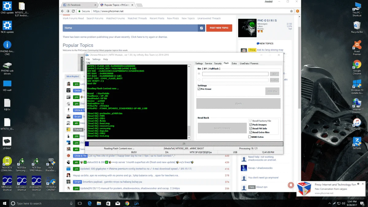

Stock Firmware Backup

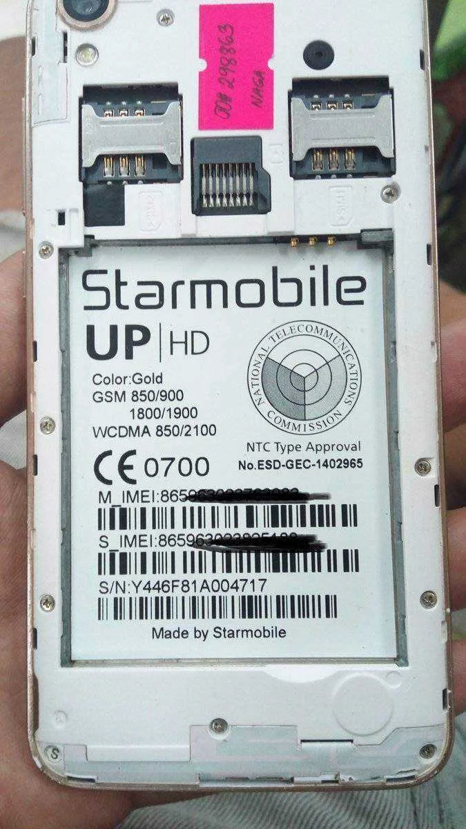

Phone Info:
Reading Firmware:
Done.

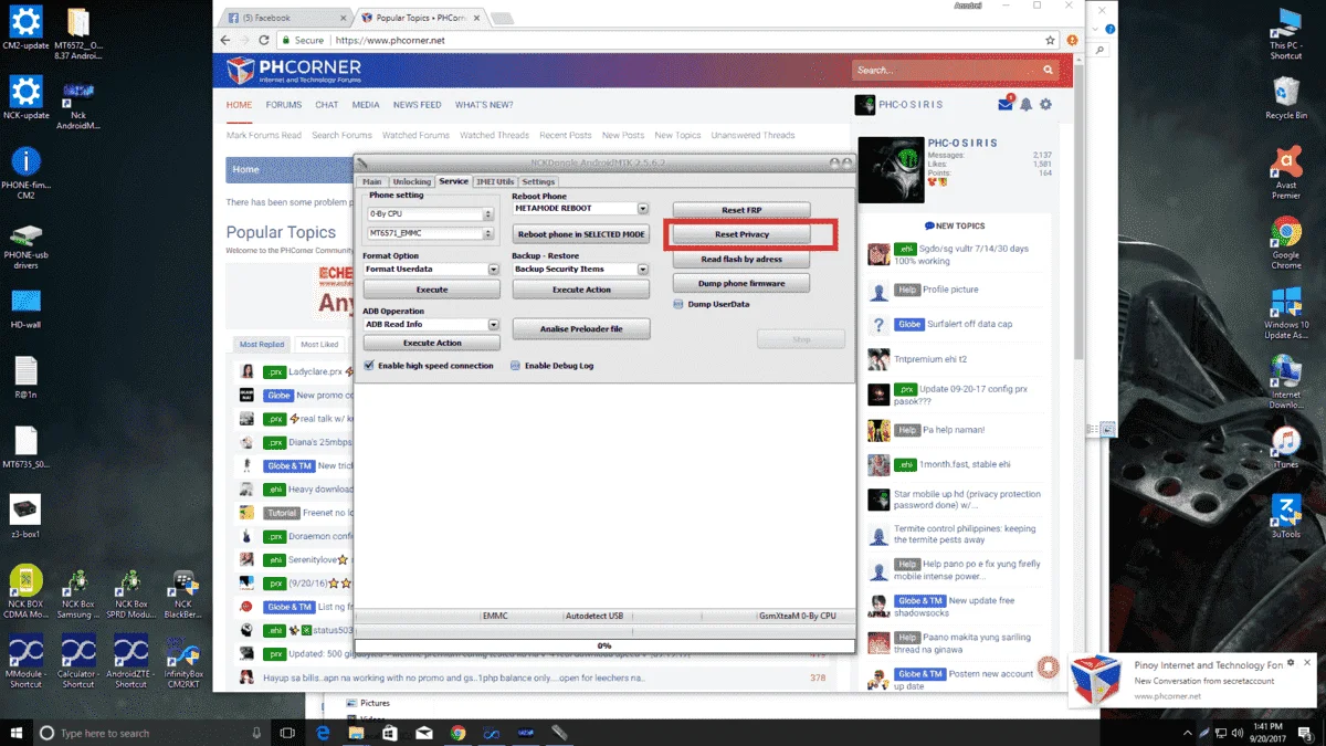

Add ko lang po kaPHC paki try din po sa NCK cr@ck kasi meron din Reset Privacy
Note: hindi lahat ay support ng NCK cr@ck pero pa try na lang
