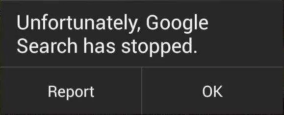

Ito yung Unfortunately na paliging lumalabas na halos di mo na manavigate yung unit

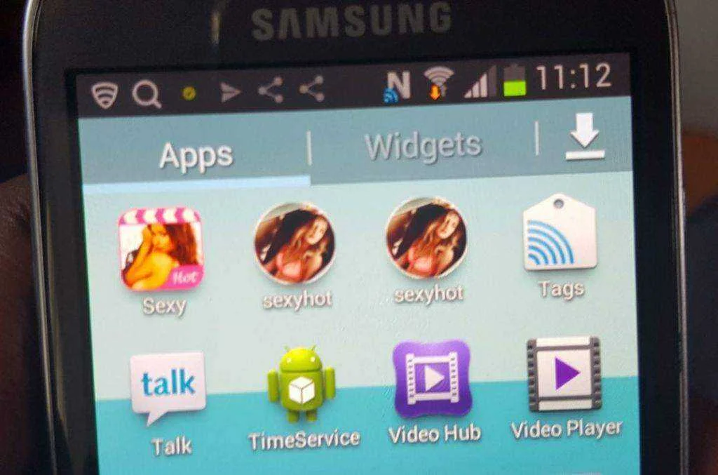

meron din virus na kung tawagin ay
sê×ÿ Virus

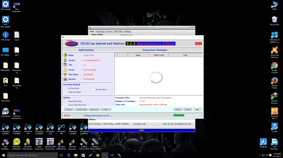

Ito po solution jan via TELECom Android Anti-Malware Tool:)
Mga kailangan sa pag tangal ng VIRUS.
1.Install TELECom Android Anti-Malware Tool You do not have permission to view the full content of this post. Log in or register now. Installation pass
2.dapat na ka on ang usb debugging mode gsm.xraxx
3.rooted device.

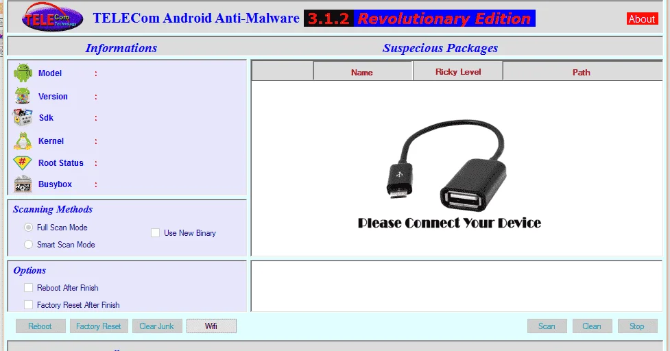

pag ok na Connect nyo lang yung unit na iffected.
ganito:)

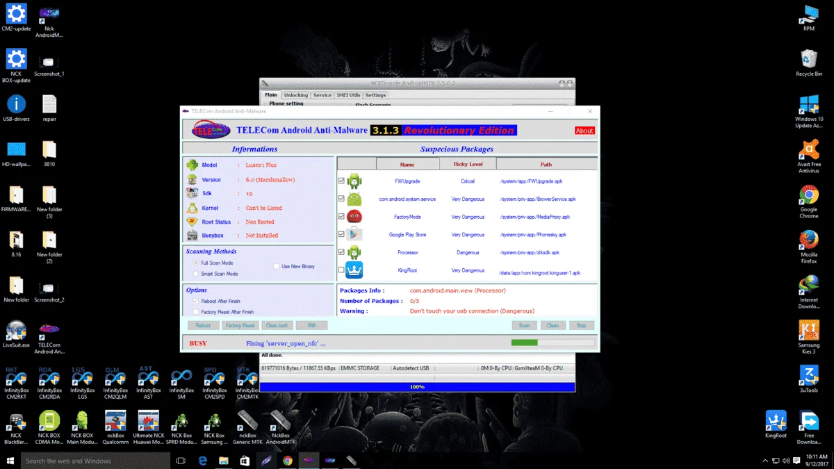

pag connected na ganito na:)

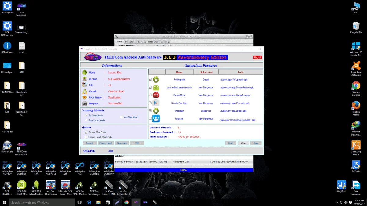

hit clean para iremove ng TELECom Android Anti-Malware Tool yung virus
antayin lang matapos Done:)
No more Virus.

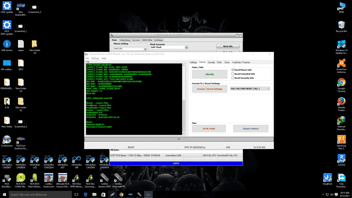

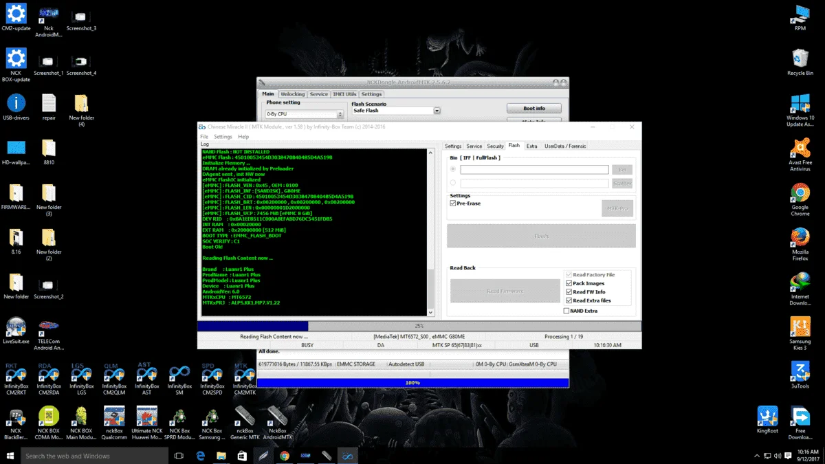

Ito naman sa Backup
CM2
Info
Reading Firmware
Ckk Lunar1 Plus
Firmware You do not have permission to view the full content of this post. Log in or register now.

nag backup muna ako ng stock niya kahit may virus then reflash.
nang nag open na nag popop out parin yung virus pero di na tulad ng dati na halos virus na lang lumalabas at di na manavigate.so bilis kamay punta setting enable usb debug then roon yun sabay telecom anti malware:)
