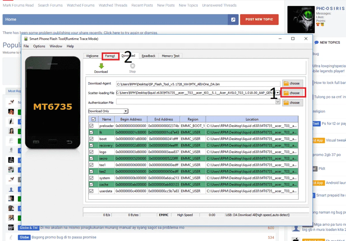

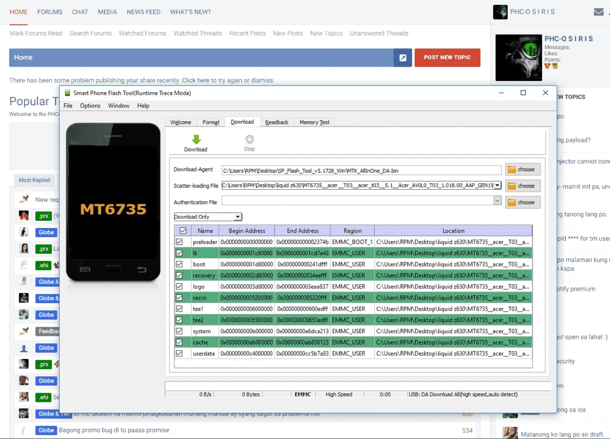

1. Open Smart Phone Flasher Tool (SP FLASH TOOL)
2. Load Scatter File at pumunta sa Format section

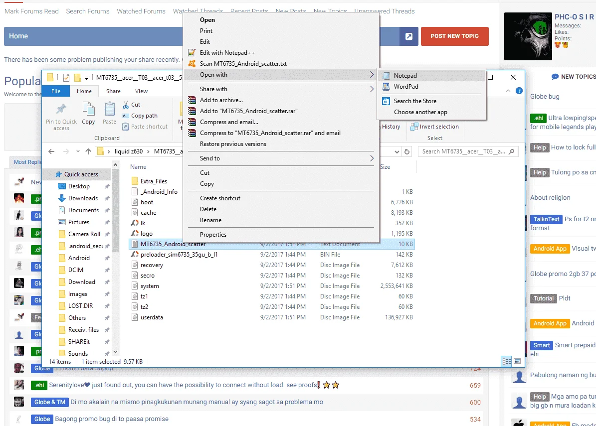

3. Open Scatter File via notepad

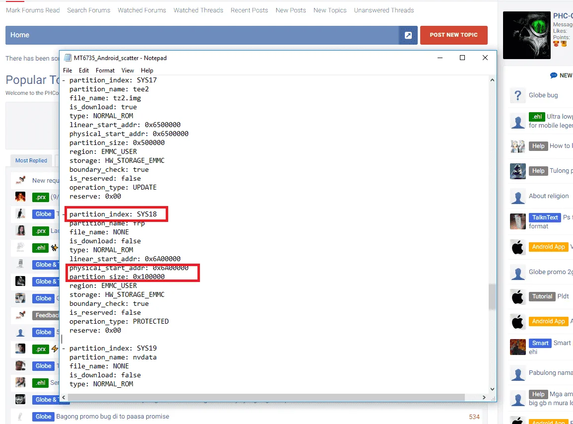

4. Hanapin sa notepad si (partition_index: SYS18, physical_start_addr, partition_size)

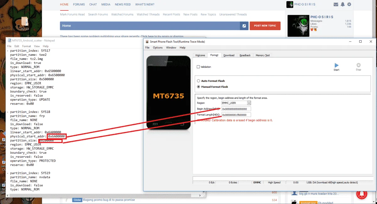

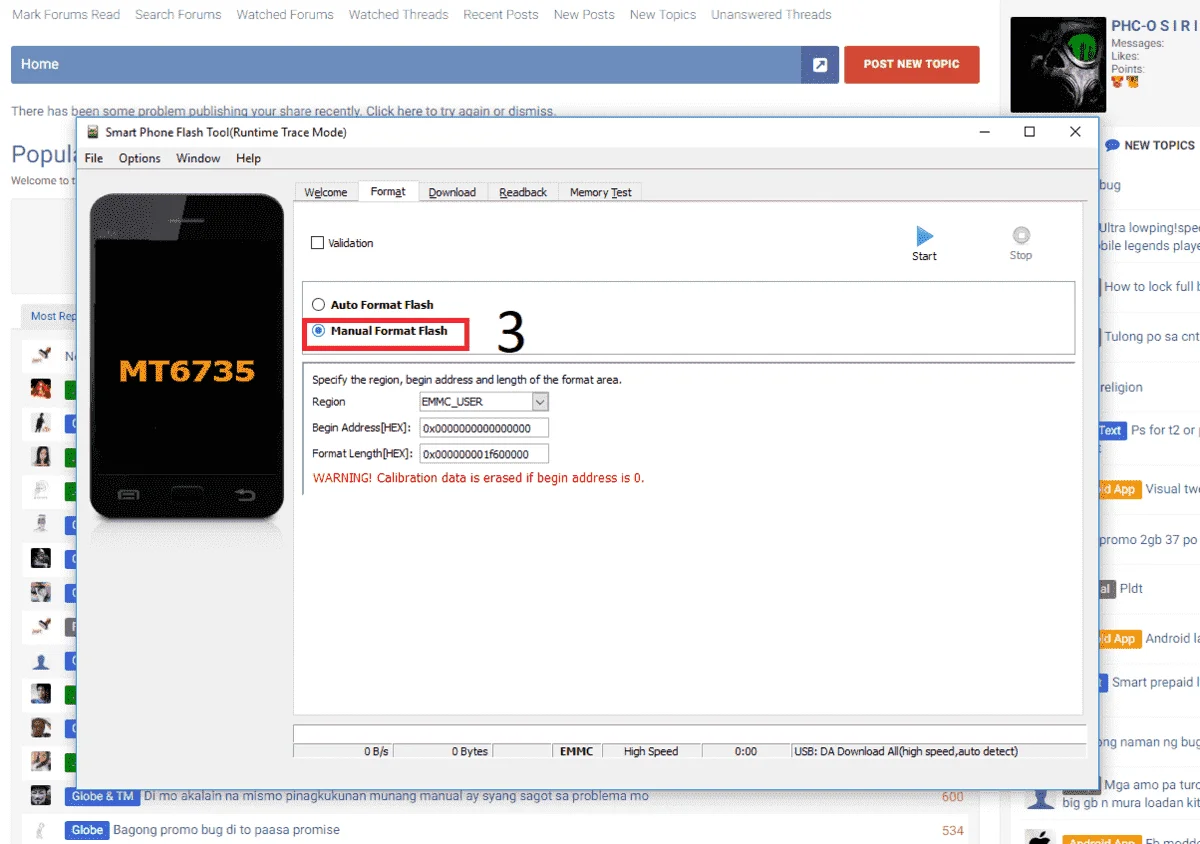

5. Ilagay po yung
physical_start_addr (0x6A00000) sa Begin Address at partition_size (0x100000) sa Format Length
6. Hit start at isaksak ang usb while holding boot key.
