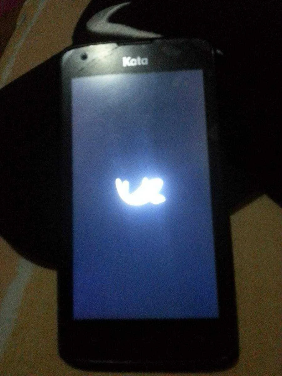

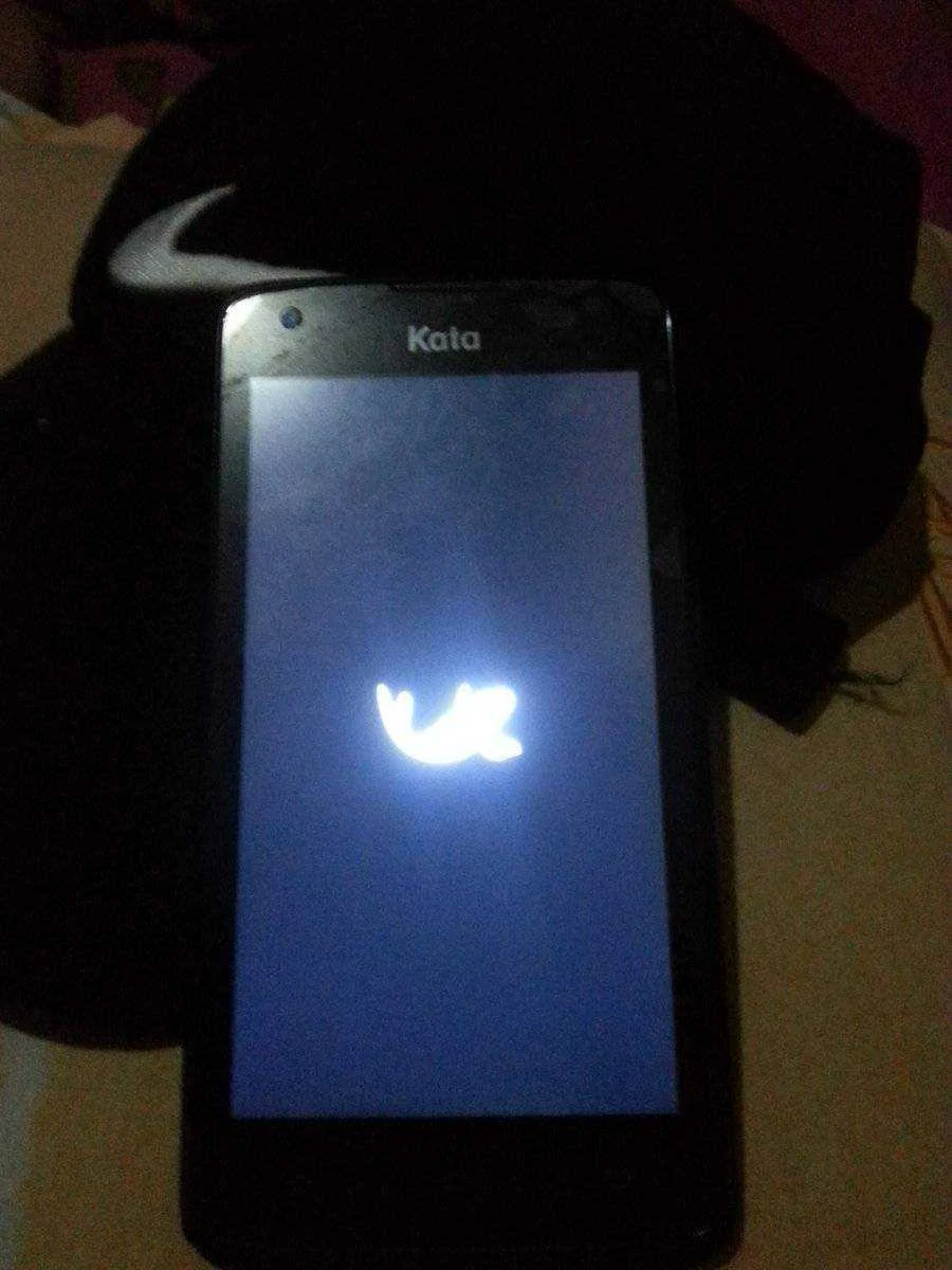

May paraan paba na maAyos to mga sir? Na stock nlang sya sa logo. Ang hirap dn kc ma reset.

bootloop sir. hard reset mo.
search mo ano combo keys para makapunta sa stock recovery ng unit mo.
try to flash new firmware via sp tool.
sorry wala ako ganyang firmware.
hanap kana lang kay google.
back up first bago mo iflash. kung mamatay man iflash mo ulit yong backup firmware mo.
use miracle crack to back up.
mracle crack visit here:You do not have permission to view the full content of this post. Log in or register now.
flash na po yan ng stock rom..

flash na yan or bootloop lang ts . baka kasi may na delete ka na file ng phone mo kaya nag stockup ka dyan.
May chance pa po ba to mga sir na maayos??
Paano po mag flash?
1 download firmware
2 dowload driver. depende sa I.c ng phone mo. mediatek or spectrum. pag mediatek download ka ng driver ng mediatik. pag spectrum nman download mo spectrum driver.
3. pag mediatek ang I.c use sp flash tool.
yong miracle crack all in one nyan pwde mo yan gamitin pang flash or back up files.
malaman mo kung a nong klaseng i.c phone mo pag sinaksak mo sa computer my lalabas sa gilid na driver installer.
4.pag na install mo na. write flash pag sa mracle crack. pag sa sp tool nman. dapat scattler firmware gamit mo hindi bin.files. dalawang klase firmware my bin at scattle.
sa sp tool open scattle file tapos hanapin mo yong firmware na download mo click scattle emmc file. tapos download option or upgrade firmware then cleck download.
ilagay ang battey press volume up or down isak sak mo usb cord. hintayin mo magkulay red tapos bitawn mo hintayin mo hangang maging ok flashing.
firmware You do not have permission to view the full content of this post. Log in or register now.
how to flash sp flash tool: You do not have permission to view the full content of this post. Log in or register now.
sana makalong ito sayo
try one by one.
