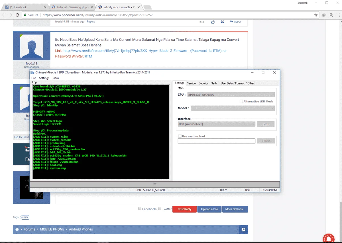

Card found: S/N : C248DF43 , v0136
Chinese Miracle II [SPD module] v 1.27
Operation : Convert InfinitySC to SPRD PAC [ v1.27 ]
Target : K15_V8_SKK_k15_v8_2_skk_5.1_LMY47D_release-keys_HYPER_X_BLADE_II
Step #1 : Identify
MEMORY : eMMC
LAYOUT : eMMC NORMAL
Step #2 : Select logic
Select Logic : SC7731
Step #3 : Processing data
Build PAC
[ADD FILE] : nvitem_w.bin
[ADD FILE] : nvitem_wcn.bin
[ADD FILE] : prodnv.img
[ADD FILE] : u-boot-spl-16k.bin
[ADD FILE] : sc7731g_CP0_modem.bin
[ADD FILE] : DSP_DM_Gx.bin
[ADD FILE] : sc8830g_modem_CP2_WCN_14D_W15.31.1_Release.bin
[ADD FILE] : logo_720x1280.bin
[ADD FILE] : fblogo_720x1280.bin
[ADD FILE] : boot.img
[ADD FILE] : system.img
[ADD FILE] : cache.img
[ADD FILE] : recovery.img
[ADD FILE] : userdata.img
[ADD FILE] : u-boot.bin
Build Ok! Result : 0x0017
Sign PAC ...
Sign Ok! FW compiled!
Elapsed: 00:01:33
Saved to : K15_V8_SKK_k15_v8_2_skk_5.1_LMY47D_release-keys_HYPER_X_BLADE_II.pac
Done!
upload ko lang pac.file
