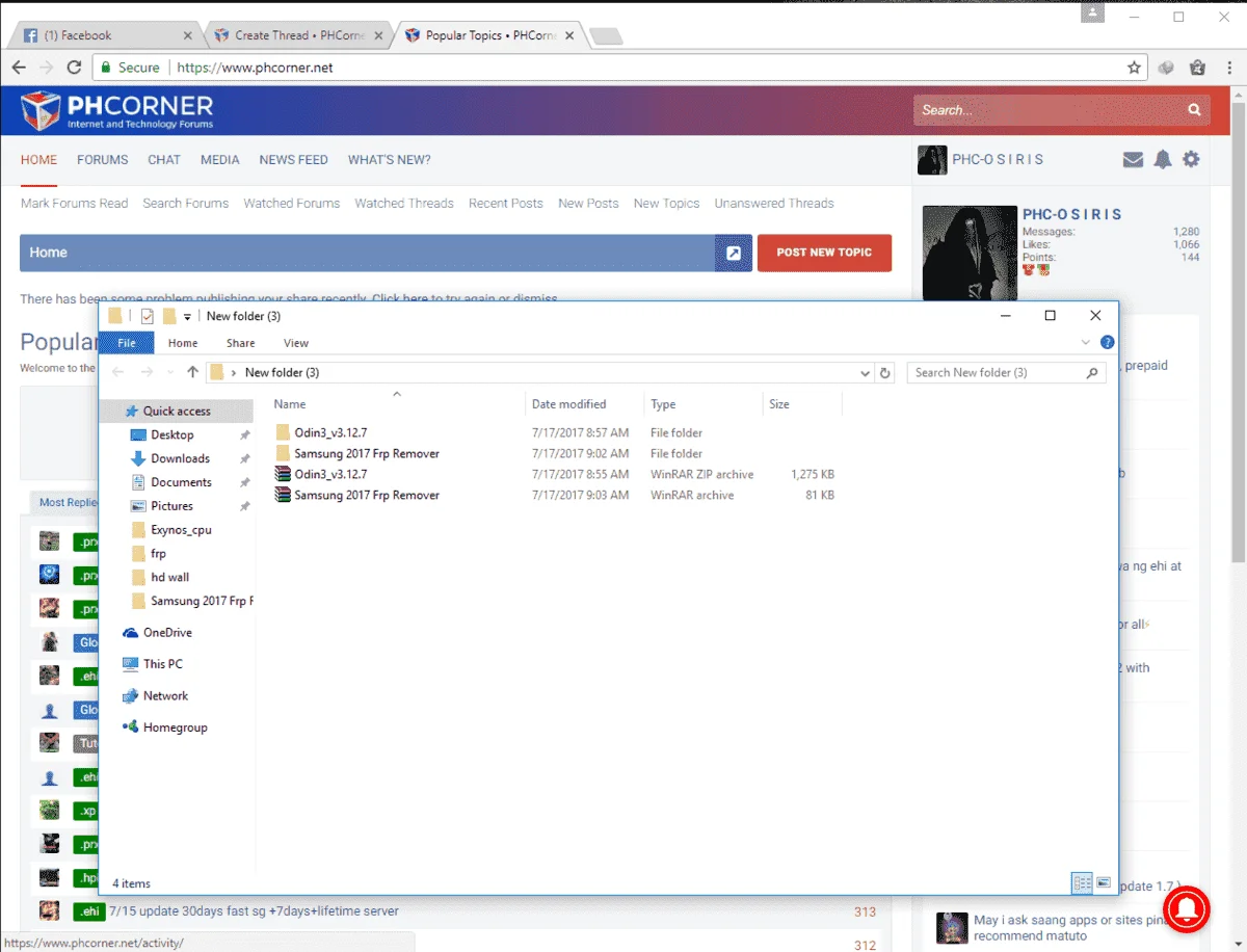

Extract Odin v3.12 & Samsung 2017 Frp Remover

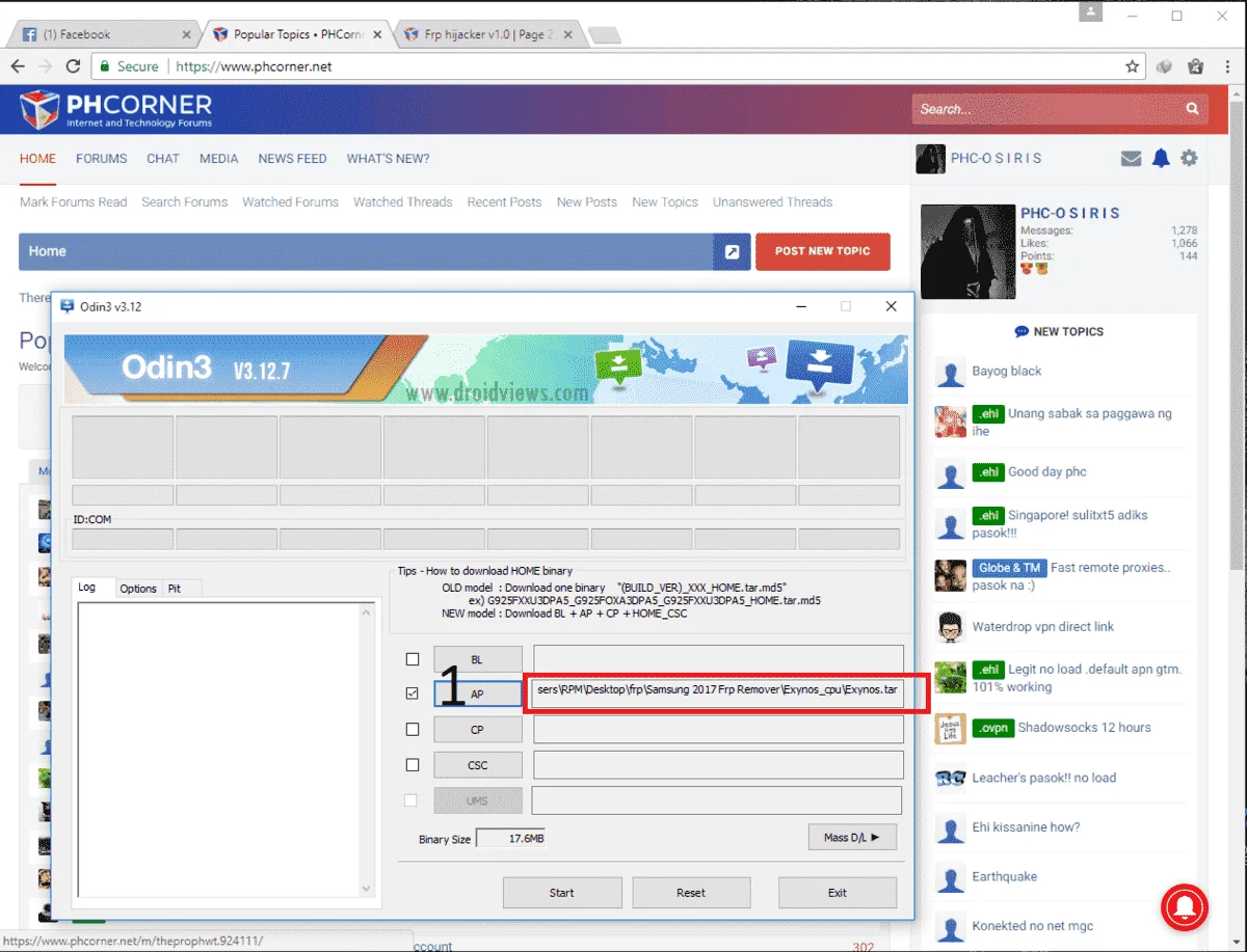

Open Odin
load extracted Samsung 2017 Frp Remover
Next Step

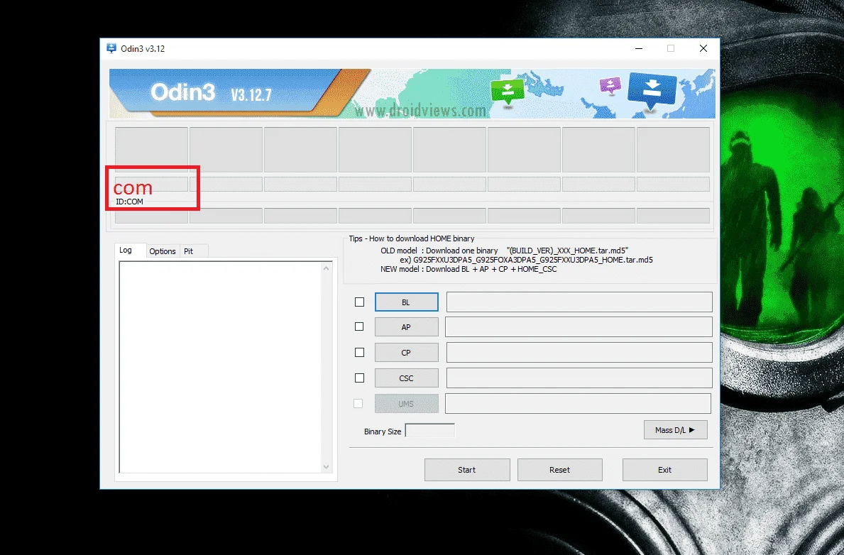

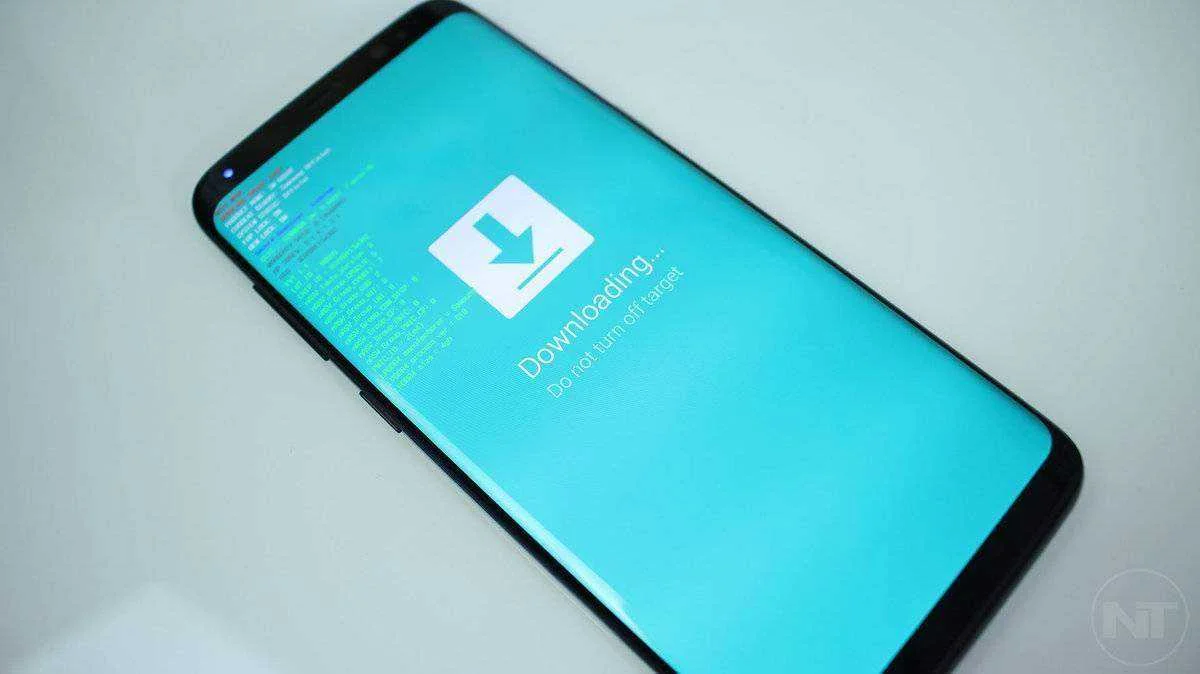

1.power off your phone
2.hold power - home - volume down
wait ninyo lumabas download mode

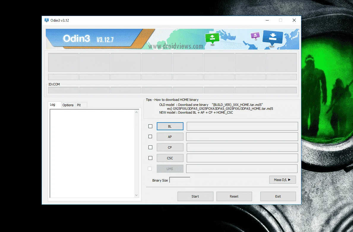

3.connect usb cable (phone to pc)
4.wait until connected to Odin v3.12
may makikita kayo na COM PORT etc dito
5.hit start botton at hintayin matapos.
