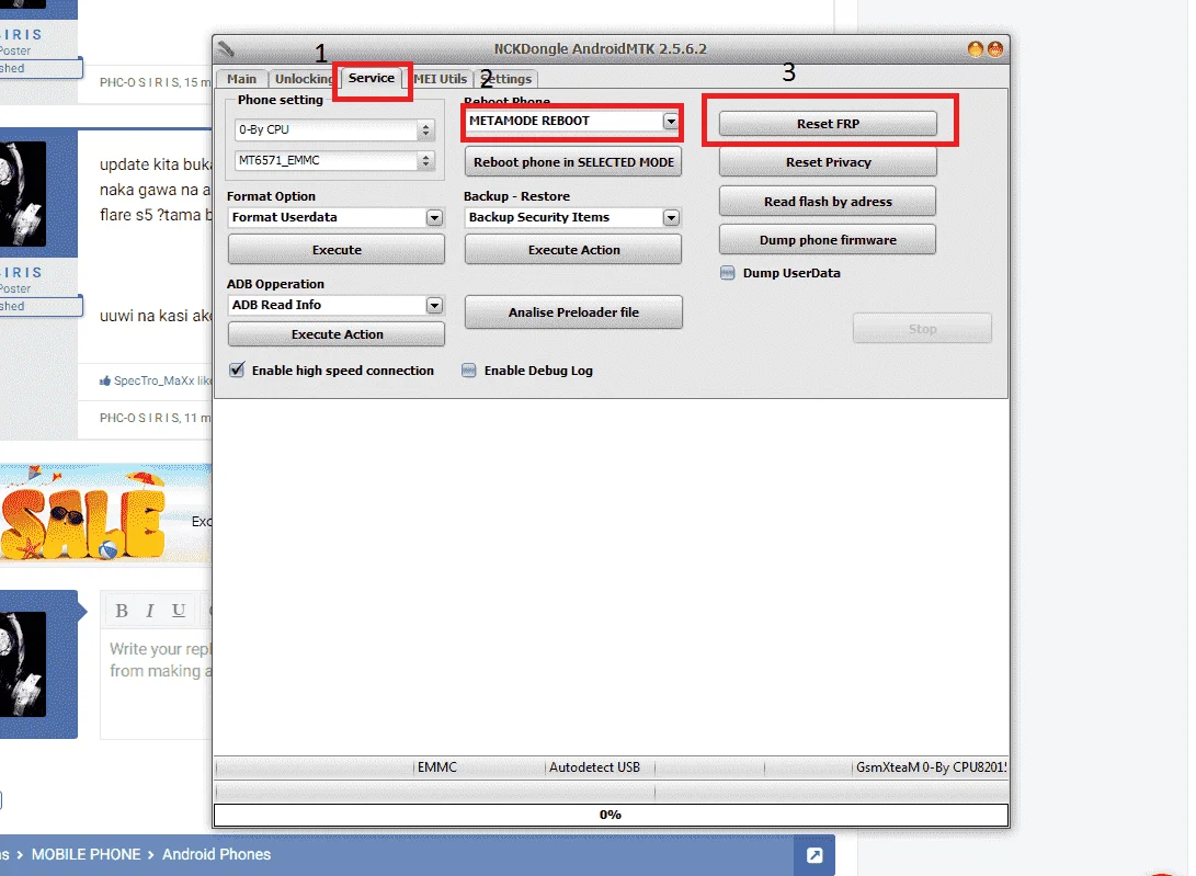

SUNDAN MO LANG PROCEDURE.

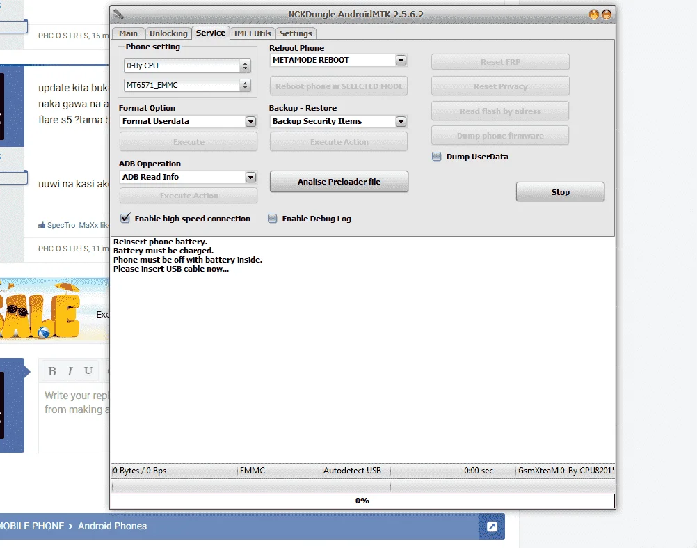

power off phone
connect usb cable while holding boot key
(boot key) isa lang yan pwedeng vol- or vol+
pag nag connect na may lalabas na red color sa baba
wait mo mag blue 100%

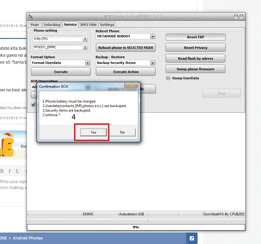

unplug mo then alisin mo batt balik ulit then power on mo
isetup mo na mapapansin mo yung pipili ka ng wifi connection may skip anyway dun skip mo lang.
NCK CR@CK:installation pa GSMXTEAM
MTK usb driver
Goodluck
