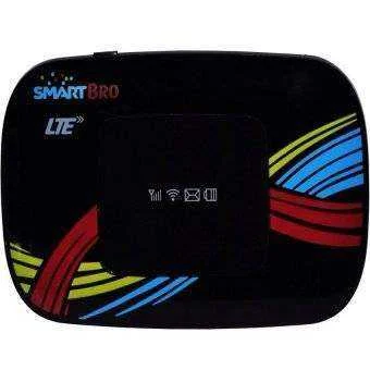

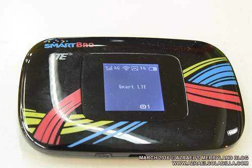

Difference of FX PR2 to FX PR2L
FX PR2 (W/ LED)
FX PR2L (W/ LCD)
